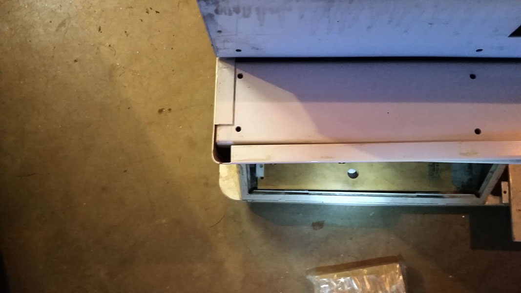

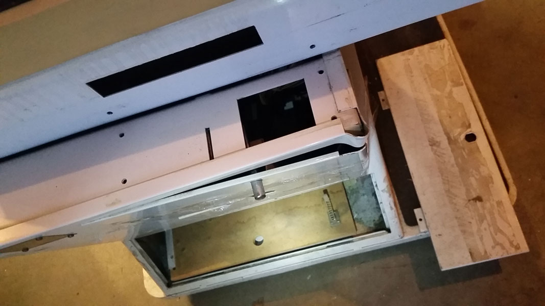

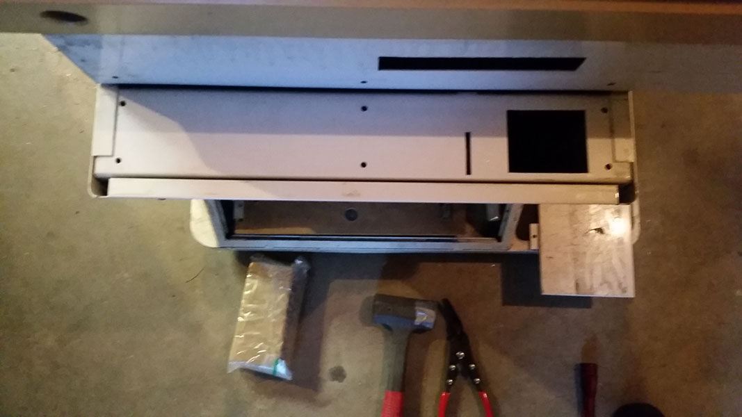

Dug into this a bit last night. first thing I noticed was a really ugly smashed in bit above the service door :(
I used a Automotive panel removal tool to pull it out straight and fix it in short order:

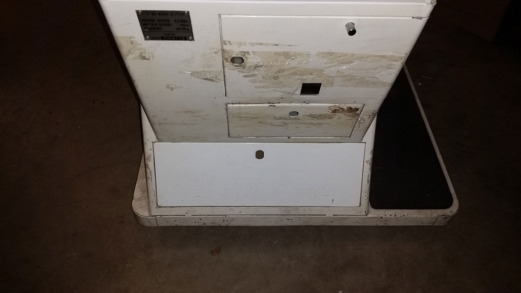

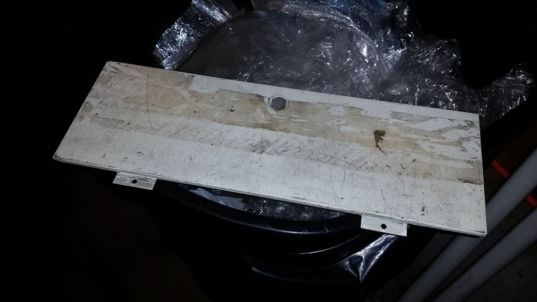

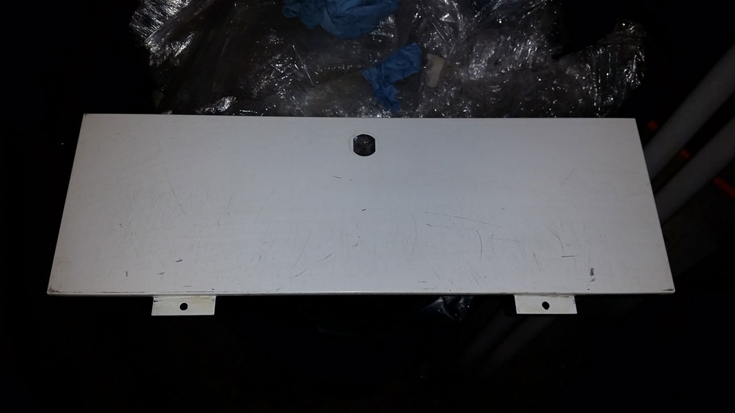

This whole cabinet is covered in nasty adhesive residue so I took off the PCB door to see what I could do to take it off.
I used some goo-gone and even after soaking it got softer but still didn't want to come off. so then I went for the magic eraser and I think the combination of the two made it work.
Still a long way to go to clean up the rest of the cab...

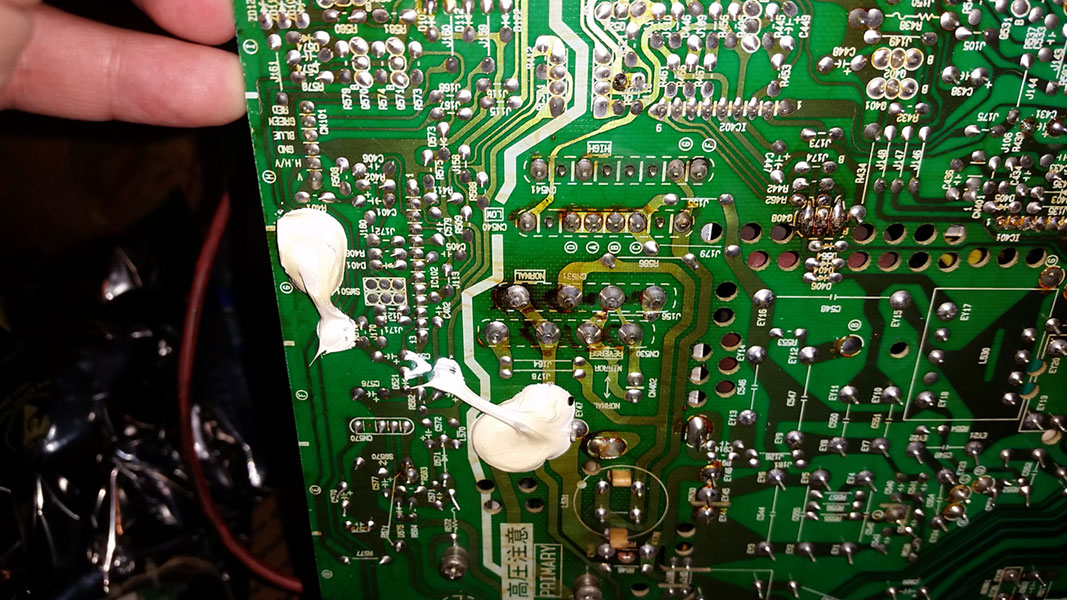

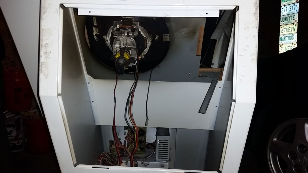

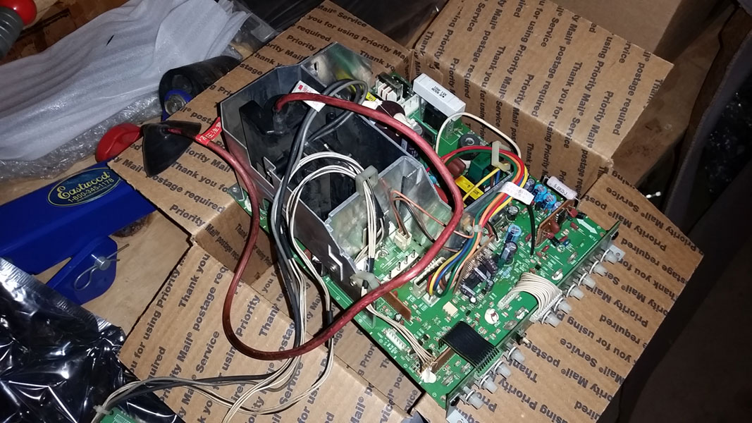

For some reason the monitor chassis on this cab had been removed and was shipped separate
it's a NANAO MS8-29 the tube and the chassis look correct, the chassis is very clean, like the cleanest of any monitor chassis I've ever seen. so I almost wonder if this had been sent out of repair.

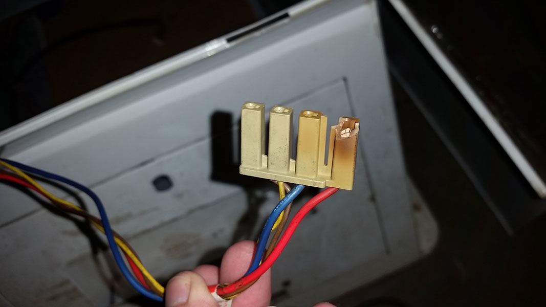

Looking the tube over I discovered this:
a closer inspection of the chassis and .. yup it's a match...
there doesn't seem to be any damage to the chassis but you can tell those pins have seen some heat
Seller assured me that the tube and the chassis were both in great shape, I hope it's true, though it wouldn't have changed my buying this cab either way. I wouldn't mind replacing that yoke pin before re-assembling.
Anyone have any idea where I might source another yoke connector or other things I should check before putting the chassis back in?
The Monitor Guru's on KLOV seem to think a cold solder joint on the yoke connector is what lead to the overheating. Yoke meters out ok so I reflowed that connector and a few other suspect parts. I've also ordered a new Yoke connector from Arcade Buffet on KLOV.

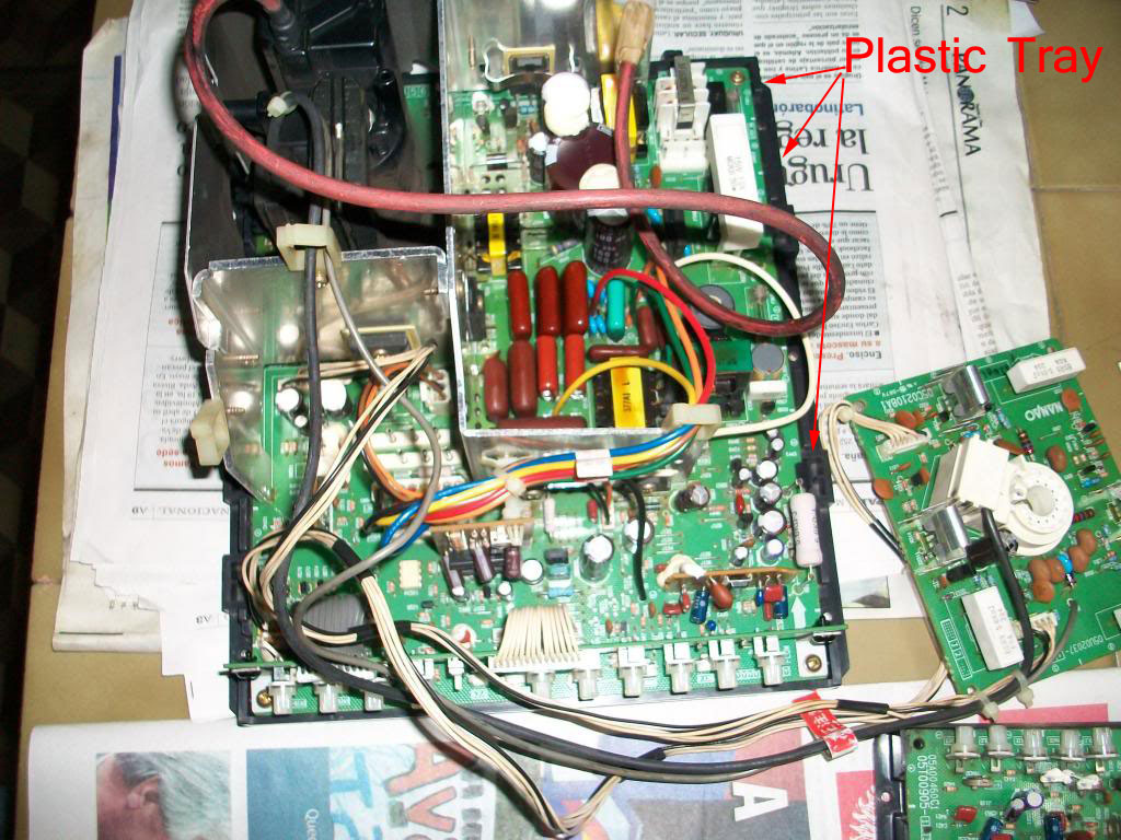

Looking at pictures on line to get an idea of how to mount the chassis in the cab I discovered that the Chassis is supposed to sit in a plastic PCB tray the slides into the cab. I'm missing this part :(
Not my Chassis... Example of missing part:
This part isn't listed in the the Egret 29 parts manual and it is shown in the Nanao MS8 manual, it also seeps to be present in just about every picture of an MS8 I've come across so I'd suspect this is a standard "part" of an MS8 chassis.
I've put up a WTB on KLOV and AO, but if anyone has one of these kicking around, or knows where I can get one please let me know.
