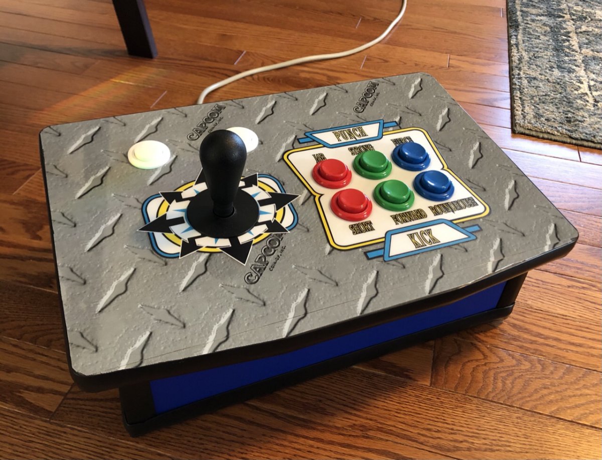

Might I chime in. I grew up with a few arcades around me using Old school Happ everything & concave buttons. I loved the feel so much when I started getting into collecting PCBs that I built a Capcom inspired custom controller for my MAS super nova using old school Happ parts (including the old school white nylon actuator in the joystick & concave buttons). The buttons I have in these also have the cherry switches oriented vertically into the button, as opposed to horizontally mounted below it. Nothing wrong with both ways (convex/concave) IMO for old school American arcade feel.
Nice looking yea, I love the metal diamond pattern overlay with Capcom on it.
