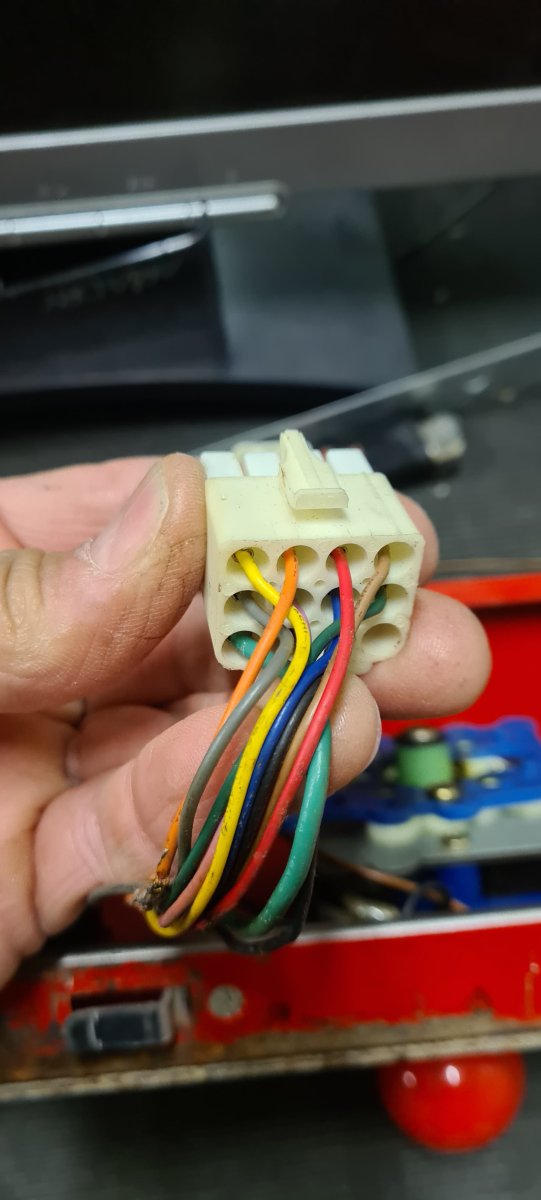

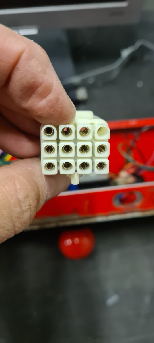

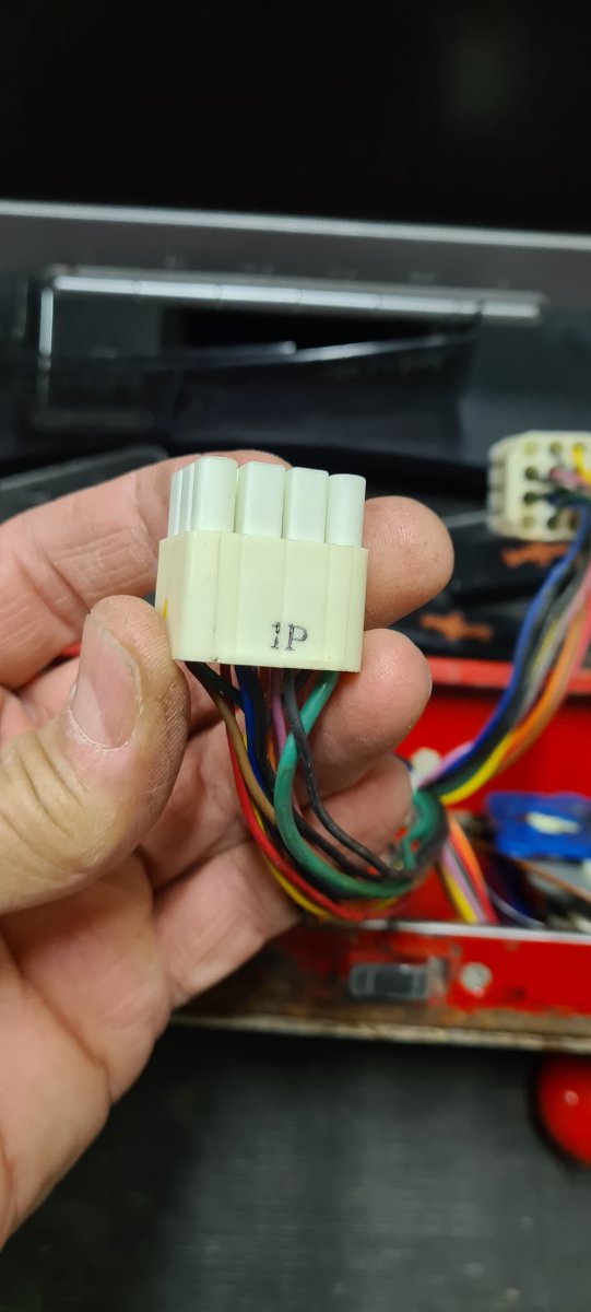

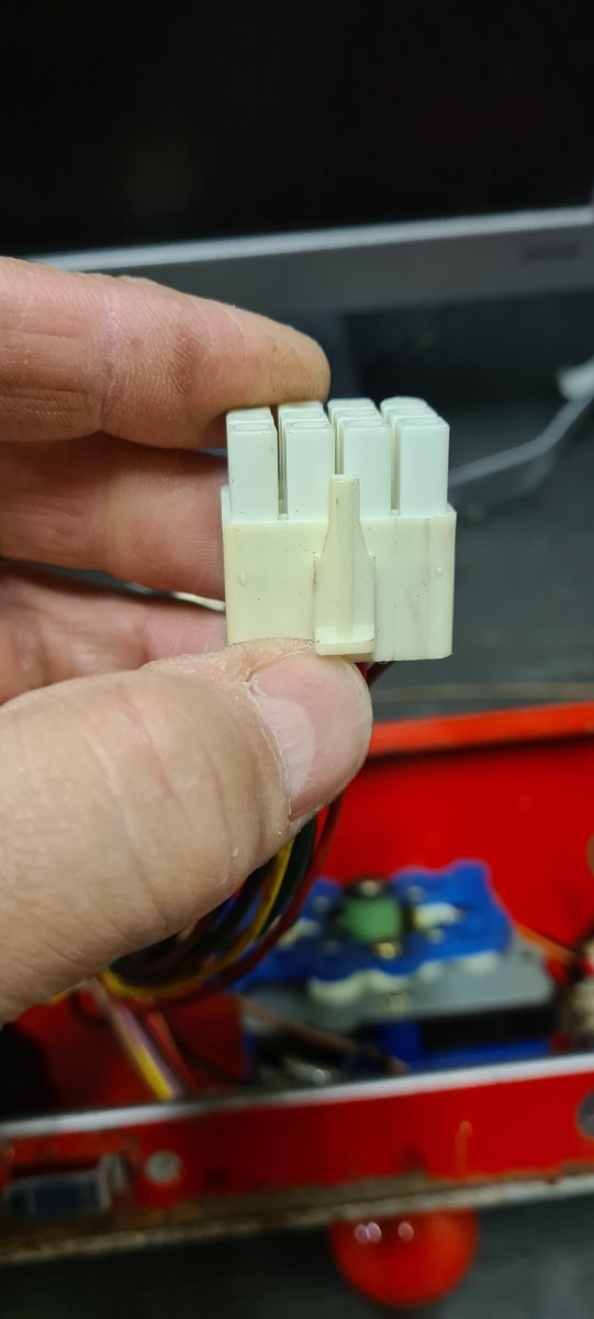

CPZ - SAVEYOURGAMES Champion Joined Jul 22, 2015 Messages 645 Reaction score 1,377 Dec 5, 2024 #1 Hey guy someone can tell me the code for order this type of pin and connector male and female (used by SNK) thank you in advance Attachments snk-1.jpg 70.9 KB · Views: 22 snk2.jpg 63.9 KB · Views: 19 snk3.jpg 57.2 KB · Views: 18 snk4ù.jpg 55.8 KB · Views: 18
nem Immortal Joined May 29, 2016 Messages 7,415 Reaction score 7,960 Location Finland Dec 5, 2024 #2 Looks like JST L series: https://wiki.arcadeotaku.com/images/7/72/Jst_l_connector.pdf Bad news, JST has discontinued it. You might be able to find some old stock if you google the part numbers.
