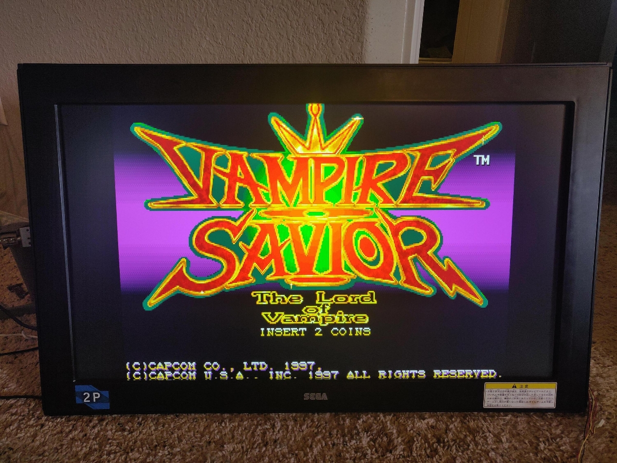

My Lindbergh's monitor was dying rapidly so, inspired by what everybody is doing with Vewlix monitor swaps, I decided to take a crack at swapping my Lindbergh's monitor too. It seems like 32" 1080P monitors of reasonable quality about the same price as 1440p monitors, and since I primarily run a PC or PS3 in my Lindbergh, it seemed like 1440p would be better for me than 1080p anyway so I decided to try out this LG 32QK500-C 1440p monitor. The picture quality of this monitor is fantastic, being that it's IPS, and I couldn't be more pleased with how it looks.
I found that with the anti glare coating on the original lindbergh glass I got some grainy moire effects on the the new screen, probably because it also has it's own anti glare coating and stacking the two created the effect, so my solution was to remove the glass and design a mount to press the new monitor into the front of the bezel.
The mount that I designed is 3D printable. It consists of 4 corner spacers to center the monitor in the bezel, and 4 rear spacers to attach to the stock metal frame of the lindbergh monitor to hold the new monitor securely in place. Below are pictures of the mount and installation procedure.
This design will probably work with other LG monitors that use the same housing design, and it can be edited to work with a wider variety of monitors by adjusting the dimensions of the spacers. I've uploaded it to thingiverse and I included the Sketchup source file so it should be easy to edit.
