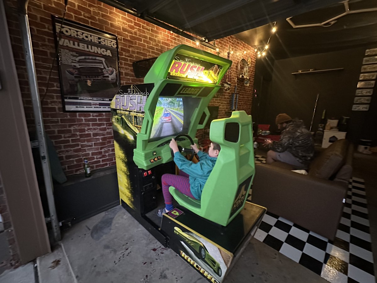

4. While the seat base and seat half of the cabinet is perfectly straight up and down, the cabinet housing leans to the left alittle bit. Not terrible but it bothers me kinda. Is there a way to make the monitor side of the cabinet stand up straight to match the seat section?

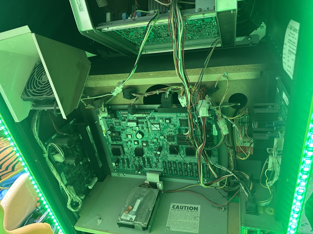

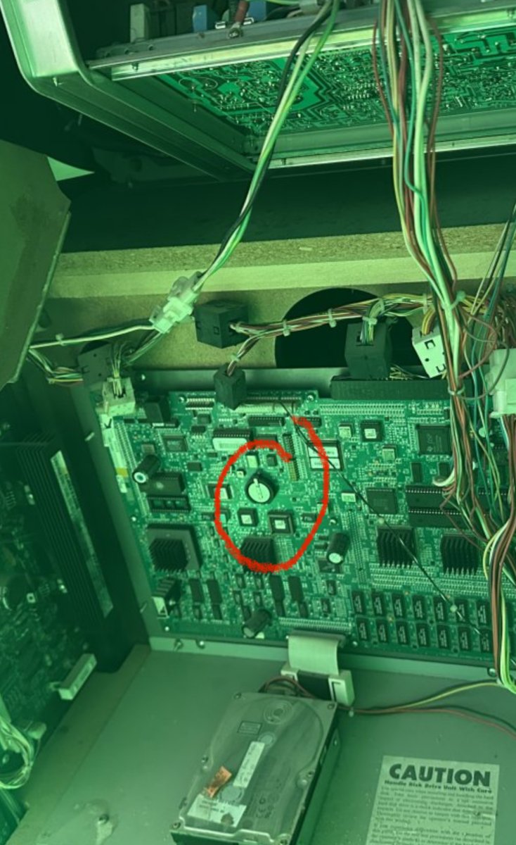

2. There's a battery on the board that you probably need to replace.

Thank you so much for the reply. Regarding number 1: its not the wheel itself, its the whole "steering rack" if you will. It moves up and down if i just gab the steering wheel and lift lightly and down lightly if that makes sense. Is there supposed to be a bushing or something that helps secure it?
Regarding number 2: so the leaderboard shouldnt be resetting after shutting it down? is there a diagram or write up somewhere that shows me which circuit board has the battery needing replaced?
Thanks for all your help so far you're a legend.
your cabinet probably got water damaged. I used to own 4 of these cabs. Atari used super cheap particle board and even if they never got wet if they were in a humid place the wood would get saturated and the weight of the giant plastic hood in front of the monitor would cause the wood to lean and sag. Then if the cabinet got tried out it would harden in that position.
I know this because that was the state of 3 out of my 4 cabinets.
if the side art on yours (or even the top painted surface) feels rough to the touch as opposed to a smooth laminate that's a good sign that the cabinet got soggy.
my bad... I posted the 1999 san francisco rush 2049 manual and board set and not the 1996 san francisco rush extreme one.
That was it! Thank you. Im still trying to sort out some minor steering issues but its all good from here.
