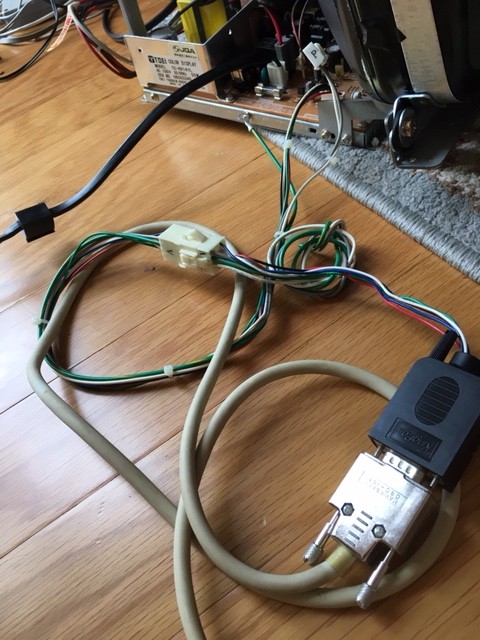

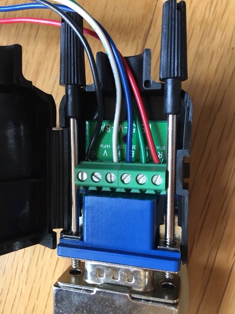

on the 13" monitor Amuzy monitor..
cable connected directly to the monitor and Mister - works fine
GroovyMAME - can not hold the sync but looks clean..I suspect an extron 203 will fix that
Xbox360 downscale with Ultracade UVC to 15khz works great..

Are you having sync dropout, roll, or no sync at all in crtemu?
You can also try combining hv from the dsub to csync.
I’m having roll.. I use vhold, it stays for a bit but then roll slowly..only happens with GroovyMame PC..
