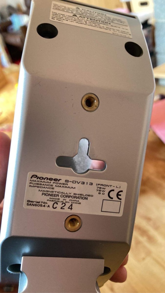

So…. Funny coincidence. @nem
Was helping the in-laws with cleaning the attic when I stumbled upon some old Pioneer speakers from a old surround system they bought like 20 years ago.
Decided to open them up just in case it was something I could use for a project…
and damn! What are the odds for a 100% match?!?!?
Old busted speakers in Mario Kart GP2

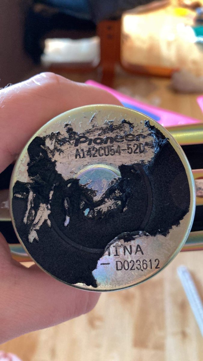

Speakers from the Pioneer S-DV313 speaker system = 100% matching!
Fun stuff!
All 5 speakers use the same Pioneer A142CU54-52D even though the center is a bit larger. Subwoofer was not usefull for anything I could find.
If you got a Mario Kart GP2 with busted front speakers, I would do a ebay search for Pioneer S-DV314.
