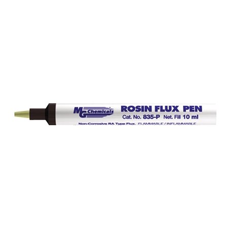

I use this, it’s that sticky-icky-icky:
MG makes a great no-clean as well, similar looking bottle to the one psykom1 linked.
If I'm doing rework on a dirty board I use rosin flux, if the work is cleaner to begin with, I'll use no-clean.
I like Amtech's VS-213A-TF. Makes drag soldering even fine pitch stuff a breeze.
