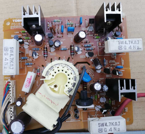

Hello. I'm looking for a Toshiba monitor because I want to buy it this time.
But this is the board from the Thrill Drive 3 monitor. I wonder if this is a 3-mode monitor board. I have a new net city dedicated to 3 mode, so I'm going to replace it there, and I wonder if this monitor board also has 3 mode.
I wonder if the above pictures are for 31khz only or 15khz and 24khz are also available. I'd appreciate it if you could answer.

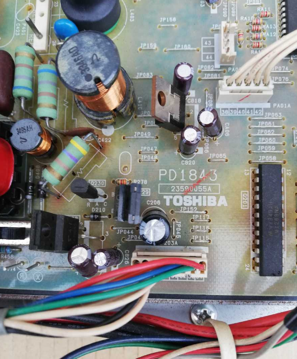

PD1843 is a tri-sync chassis.
Hello, Nem, thank you very much for your answer.
I think some of the pd1843 are selling it as a 31khz exclusive board.
Can I just say that pd1843 is a tri-sync, so can I say it's 3 mode?
The Newnet City board I have is also pd1843, but the numbering below is 23590055B.
By the way, the picture above is 23590055A, but I wonder if there is a difference between B and A.
Most likely they just don't understand the full functionality of the chassis.
It supports 15, 24 and 31khz.
