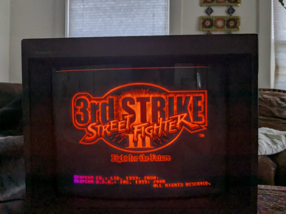

Hi folks,
I bought this PVM from japan. The description said the screen had a red tint...and I bought it for super cheap thinking it may be fixable.
Long story short the monitor was damaged pretty bad during shipping but I got a local repair shop to fix the damage to the neckboard etc.
The screen now works but with no color, and everything has a red tint. Any idea what the issue could be? The bottom image was from the auction, before any shipping damage.
the image is made up of three basic colours, red, green and blue and synchronisation obviously, two basic colours, the green and blue are failing or one of these two you would have to start testing from the rear input to the yoke rear part to know where the fault occurs which could be due to a line cut or a failing transistor it could also be something more basic like a capacitor, but if it has been taken to a technical service, they will have already checked that, but obviously if you don't do it yourself the hours are not going to compensate you, it will be cheaper to buy another one working perfectly
Lo he traducido con el traductor espero que se entienda bien
Please check the BNC connections on the back or on your BNC cable.
Perhaps there is a loose BNC connection or a broken cable on the BNC SCART cable
Try it out
Has it got a composite in? Might be worth giving that a go too to see if it's the connections or actually the guns failing.
