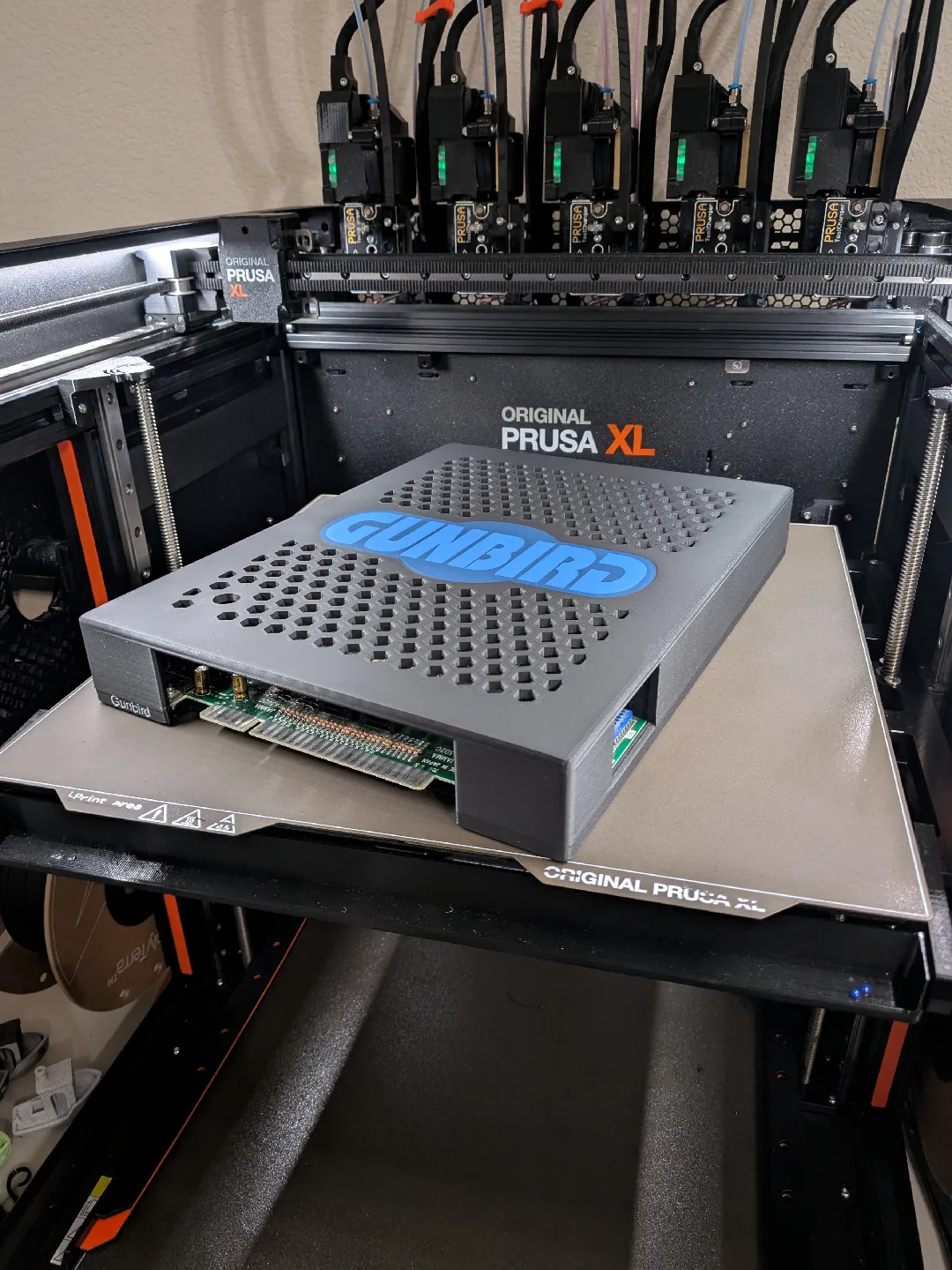

I plan to model and 3d print cases for some of my PCBs.
If you want me to print you a case, PM me for cost. 😁
Here are the ones I have complete so far!

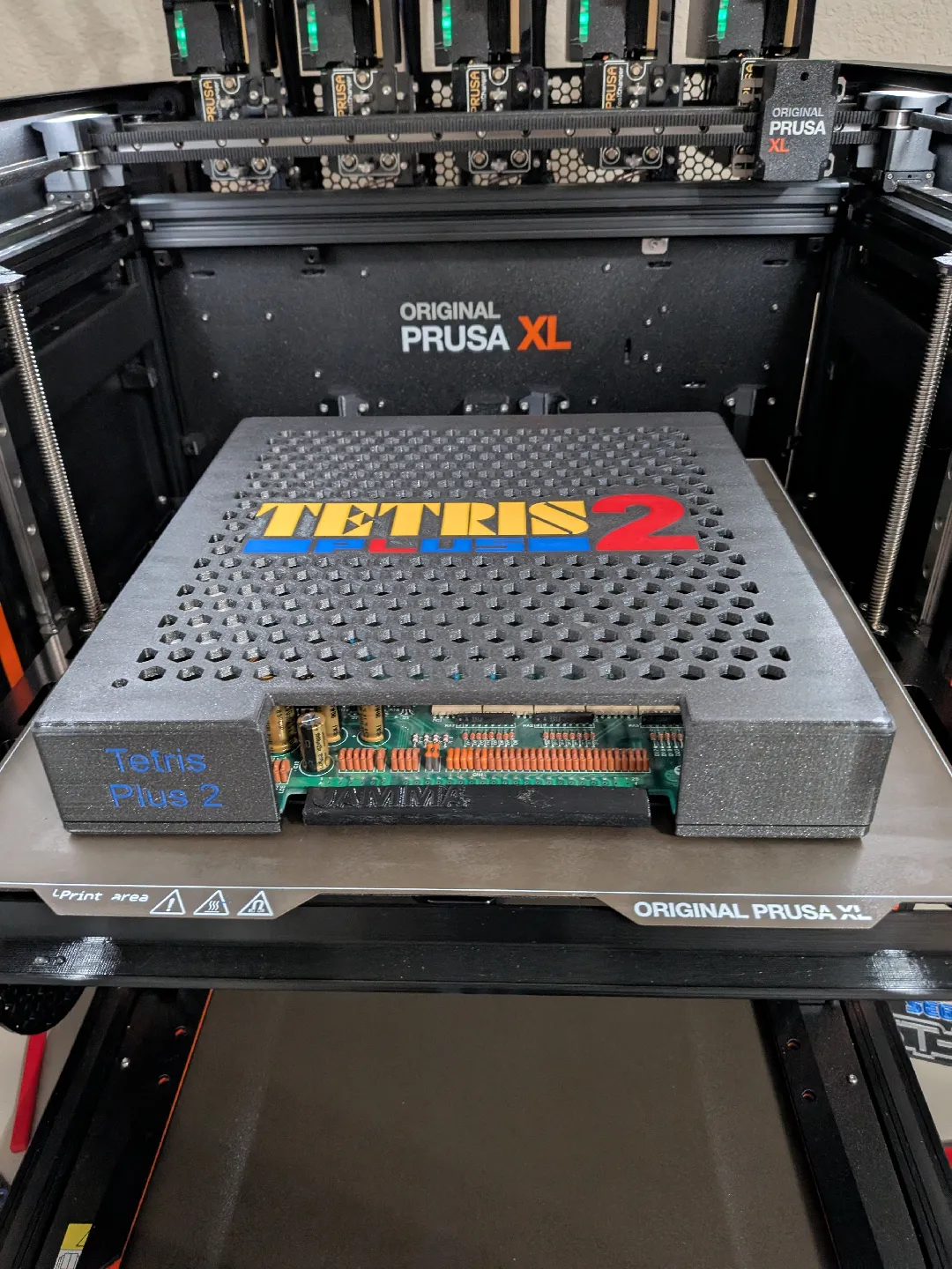

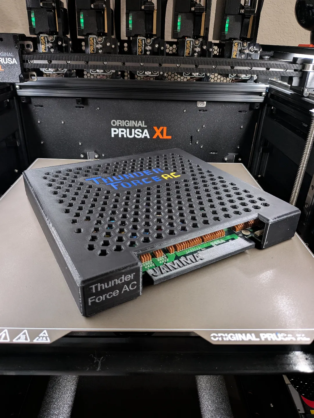

Thunder Force AC PCB Case

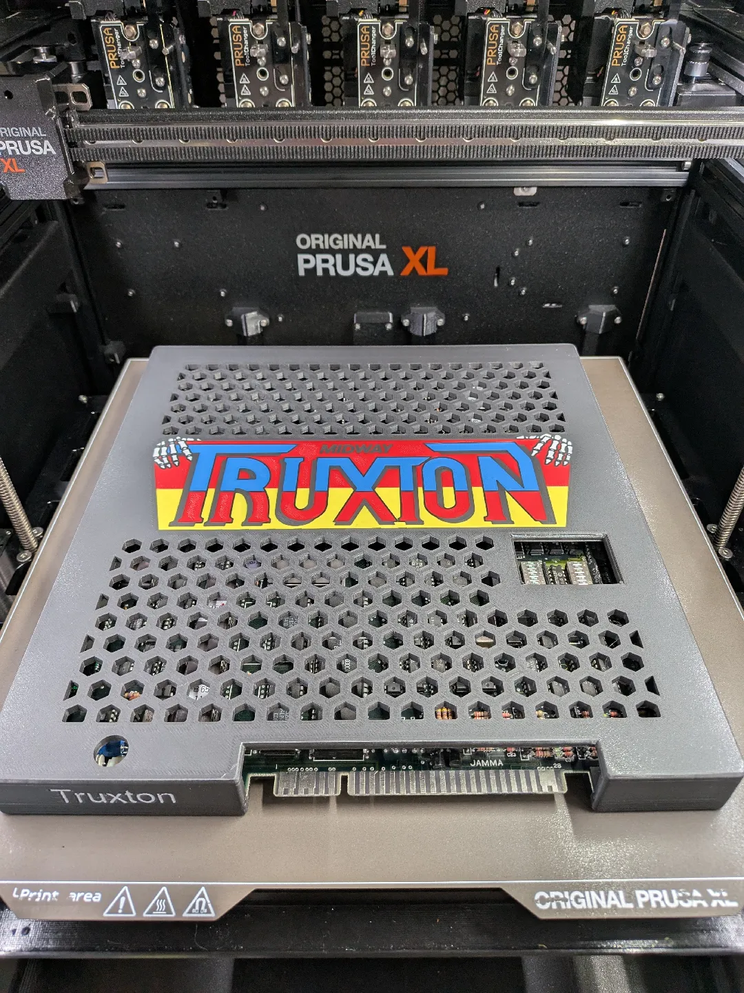

Truxton PCB Case

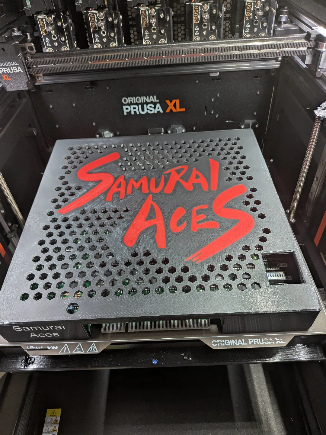

Samurai Aces PCB Case

A) for some reason i want to buy a Tetris Plus 2 PCB now
B) sadly i dont own a large printer :( - But your solutions gives me an idea of working on some cases (maybe never...) by myself. - I always thought of printing like acryl plates version and not as a case! Thanks a lot for that nice idea!

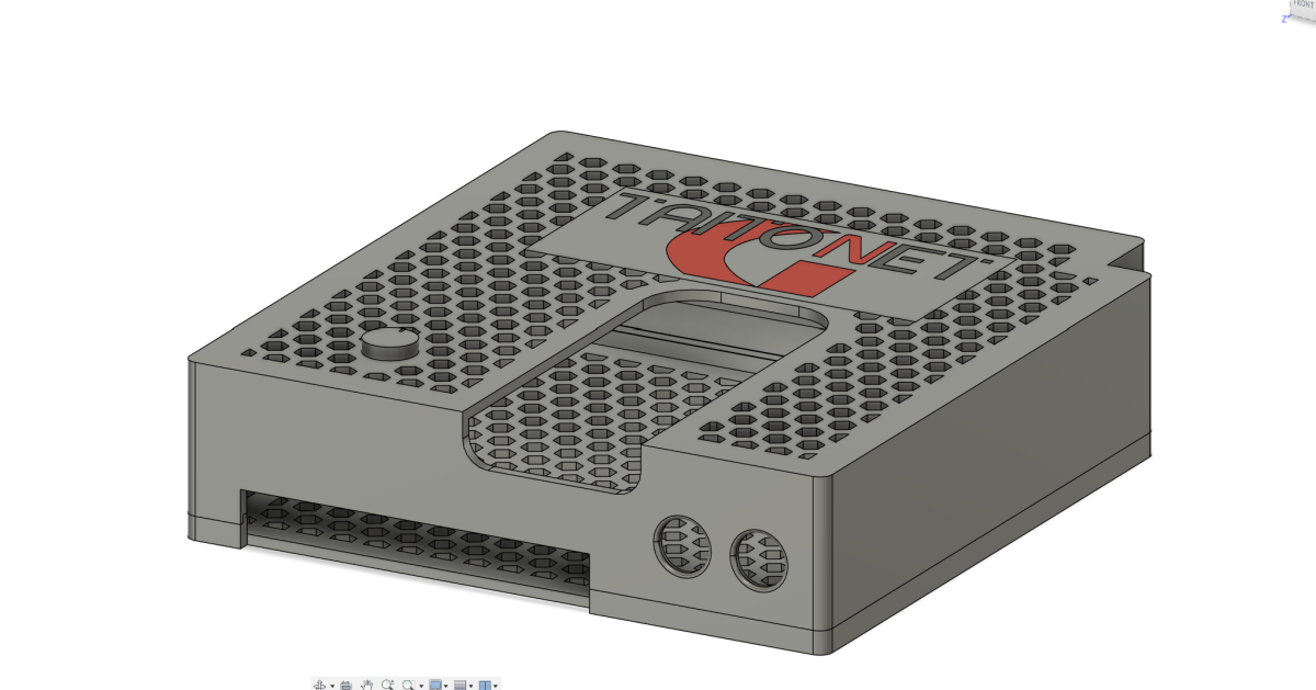

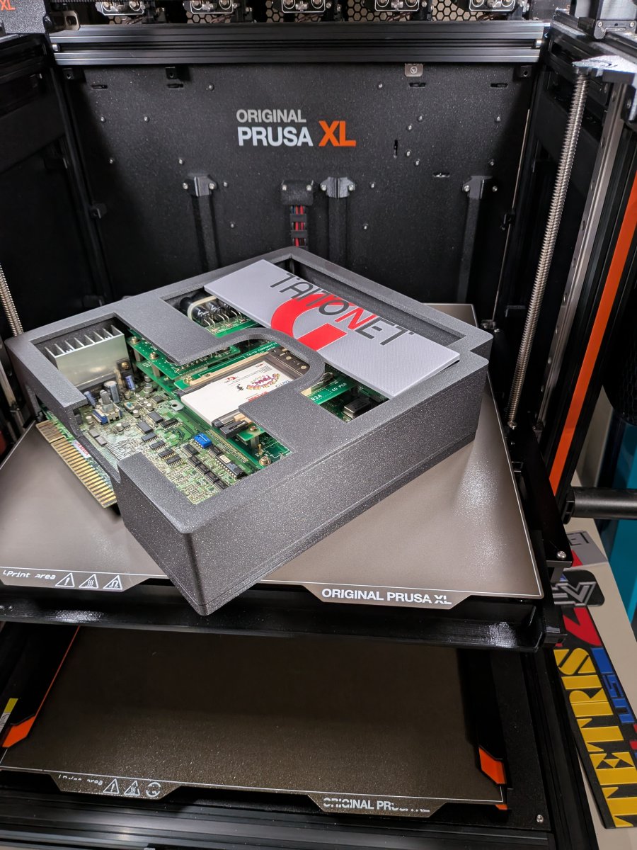

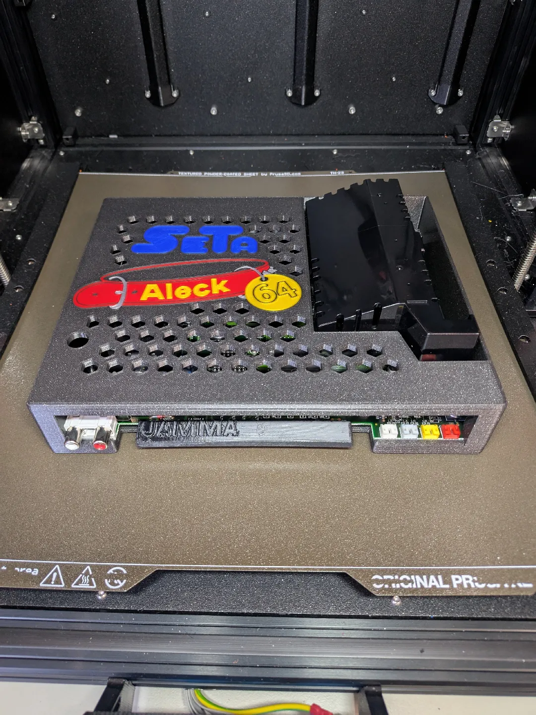

Oh! This already looks nice!
  • Why is there a corner in the upper right, but not on the upper left? :)
  • Make holes/openings for the heat spreader on the bottom left
  • Make an extension/hole for the volume knob
  • How to you connect upper and lower body? heat inserts? (maybe make some standoff feets
  • Mabe the dip switches (lower bottom) should be reachable (not sure if any of those were important, have to look it up)
  • Be aware that not everybody has multi color large format printers or want to print multicolor (i dont mind your design, i ll just print without the logo on top and add a logo with vinyl/sticker paper later)
  • How long did the print take? :)
Thanks for your input @Orakelschaf !
Waiting on some test prints to finalize this, but I'm getting closer. :)
I thought about just making it a square/rectangle, but decided to mix it up and just follow the layout of the gnet PCBs.
Could you elaborate what you mean?
When I printed the above pictures, I was using 0% infill and a few other settings just to make it print faster. Not sure if that worsen the lifting or not.
Was already planning to :) Just didn't include it in the test print to save on material
I'm designing with heat inserts being required. Standoff already already designed in too :)
I'm going to leave a large opening for the card to slide out. The dip switches will be accessible from there.
I considered designing for my mk3s+ before getting my XL. I just didn't like all the seams that would be required. If enough actually want it, I might consider doing it.
Print time TDB once I'm done :)
It feels like a strange decission, since i would always make square cases, but i don't mind either. Go for it :)
On the bottom left of the pcb there is a silver metal piece. That heat sink is collecting heat and can heat up (how much = i don't know) - This always should be ventilated and/or not to close to the plastic ( i think a lot of people will print in PLA). Not sure if this causes any trouble at all, but it is something you always should keep in mind :) - I think that is the reason why some enclosures (f.e. lion3 cps1 case) has an additional fan
Oh! Don't mind small printers, this designs really only work on large bed printers. I meant "single color" vs "multi color" prints - Just design it that i always can choose not to print a logo :)
I think i will print a logo on vinyl/sticker paper and use the logo area for that :)
