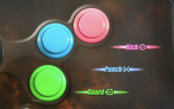

Problem is, I have a 2P 6-Button each layout, which is great for Capcom and SNK fighters, but it's really weird for VF...
All versions of Virtua Fighter 4 on Naomi 2 have the attached image in the manual, and the arcades I've played all match the layout of the stick they released for playstation, also attached for ref.
However, when played with the 6 button setup, the bottom three are ignored, and the top three seem to be
[P][K][G]
[_][_][_]
I'd like to have them match the 'real' setup, like so:
[P][K][_]
[G][_][_]
Is there any way to achieve this? The game has a test menu, but that's just to check the inputs. Not change them.
if I simply swap the wires, I'll mess it all up for Street Fighter and the like...
Cheers

In the arcade they'd simply swap in a dedicated VF panel that had the buttons wired to the correct location.
If there are no options for remapping in the test menu then there's really not an "easy" way to accomplish this.
If it were me and I was planning on swapping in VF a lot I'd build a little adapter harness for the control panel connector that swaps buttons 3 and 4. then when you swap in the game you can also swap in your harness.
or if you're cheap you can just pull the signal wires off the buttons directly and swap them.
