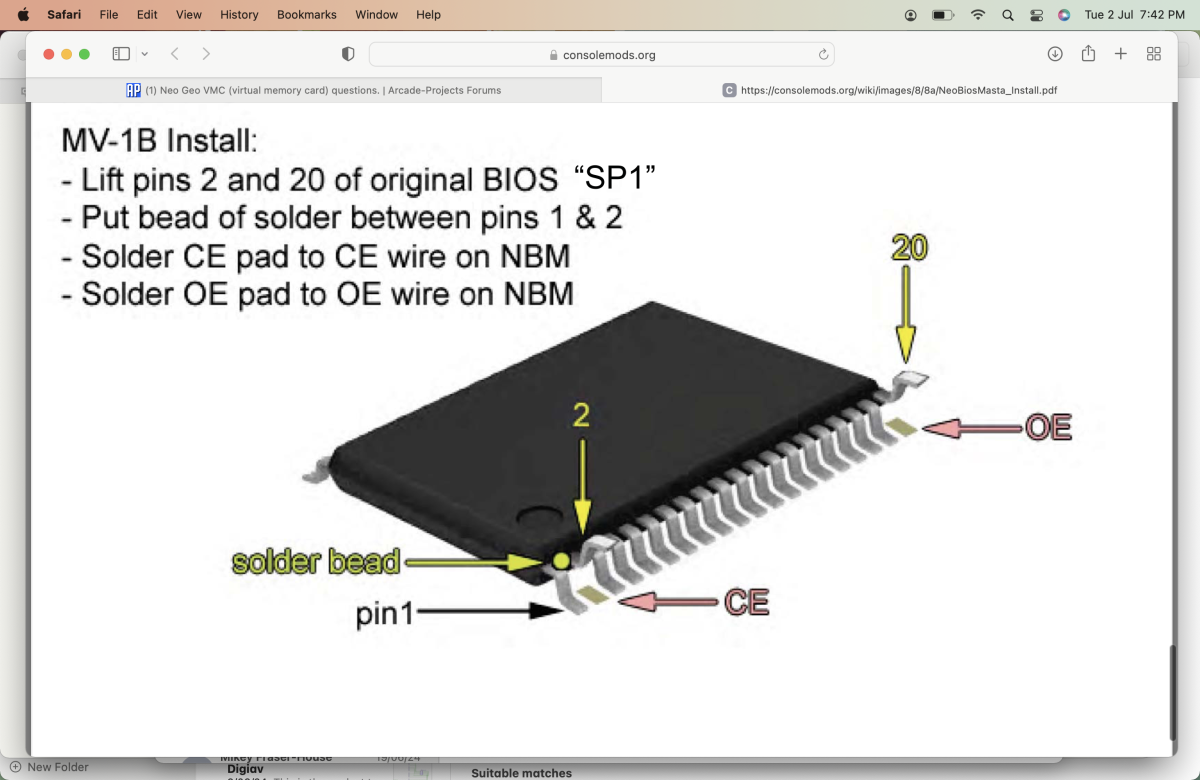

Agree with 300Wins that the stock bios needs to be disabled in order for the NBM to work.
Instructions on how to disable the stock bios are in the back of the guide, screenshot below
This is certainly a lot easier than before the neo bios master was invented - But if I had never held a soldering iron before and was choosing my first ever project I might not choose that one.

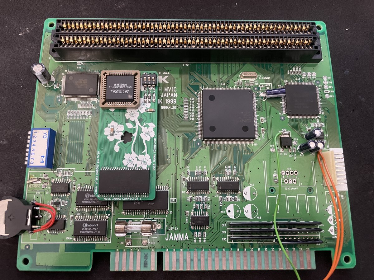

OK guys, i have installed two of them.
1 on MV1B and 1 on MV1C
On MV1B its not work if you dont deactivate che original bios or remove that.
On MV1C dot not REMOVE or deactivate the original bios.
This is for my expeirence and i dont know if it change on different model of VMC
