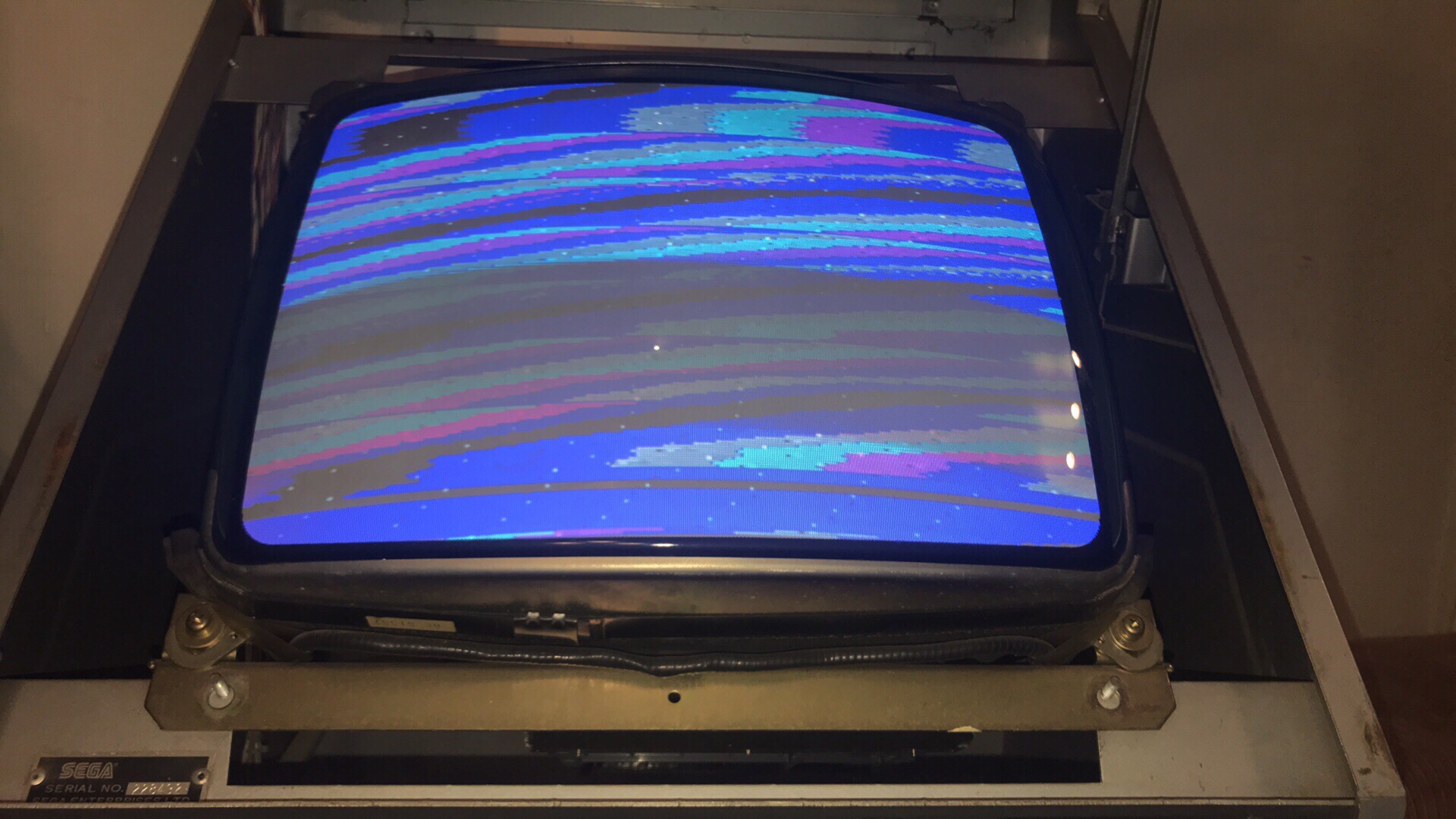

I need some help! I’m trying to get the monitor in my Sega City all set up and it’s just not syncing. the volatages are at 4.72 and 12.13 but they won’t adjust evenly. The ground and sync wires are hooked up properly to the harness. Not sure where to go from here.

There's no sync pot on the chassis?
that was my first thought. or the pot is broken.
if you adjust the v-hold or h-hold pots does it make a difference? if it has no effect then the pot could be cracked or you have a broken connection to the pot.
you shouldn't need to pull it out to adjust v-hold and h-hold. usually those are on a remote adjustment pcb or along the edge of the chassis and easily accessible since they need to be able to be adjusted with the monitor powered on.
looking at picture of the MS7 the hold pots should be right on the edge of the chassis:
looks like they're on the bottom right in this image.
if you turn it and the screen makes no reaction then the pot is bad. if you turn it and the screen reacts then it's probably good and the problem might be somewhere else.
check that first and if you think the pot might be bad then pull it and replace. after that do a cap kit then re-evaluate.
The screen does react but it doesn’t fix anything
if it reacts then it's likely still good and the problem is elsewhere.
a cracked pot will often not react at all (as if it was removed) One that is partially cracked will act like it's changing positions rapidly when just touching but not necessarily turning the pot. Though usually a partially cracked/jumpy pot will become fully cracked and non-functioning very quickly.
it couldn't hurt disconnect and reconnect the video connector on the chassis (with the power off) and then with the power on wiggle the connector on the chassis to see it changes. you can also test continuity of the video pins between the JAMMA edge and the connector on the chassis. to rule out any bad wiring or corroded connectors.
after that a cap kit may or may not fix the problem but it's a good next step.
while doing that it'd be a good idea to check/reflow any suspect solder joints as well as those under the hold pots and under the input connector to ensure that they're solid.
Alright. I’ve check continuity from the jamma edge to the point where it connects but not all the way up to the chassis. Will probably have to do that this weekend.

Think i may have figure out whats going on with the monitor. If you look at the pic of the chassis there is 6 pins for the video connection but in my picture there is only 5 wires coming down. Im going to pull the monitor when i get home and follow the wires all the way to the chassis. Hopefully it wasn't cut.
there's normally only 5 wires for video on a typical JAMMA setup
red
green
blue
ground
sync
a lot of video connectors have 6 or 8 pins though for additional sync connections
-V sync
-H sync
+V sync
+H sync
you only need to use -H sync, though on some monitors you want to split the sync wire to both -V sync and -H sync.
