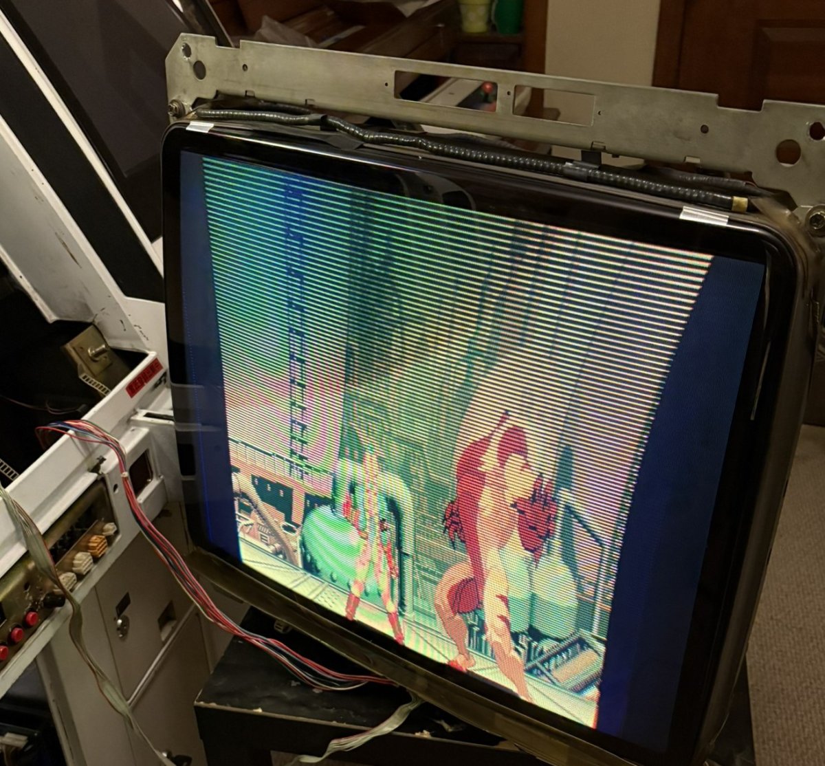

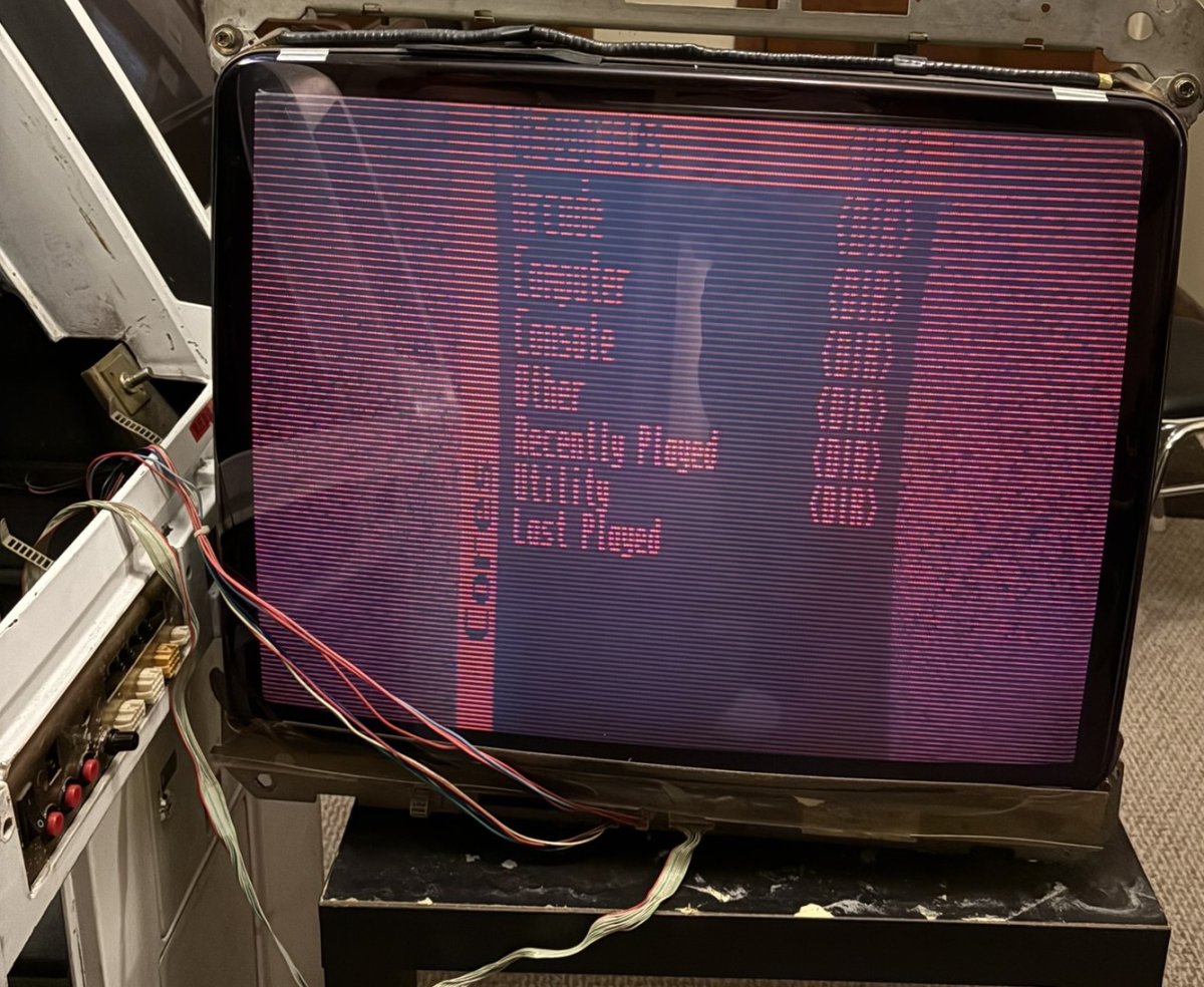

I started off by recapping everything except for the daughter board and the large B+ and filter caps. When I powered it on I got an enlarged image with overdriven red and bad side pin cushions (not pictured here). Tested it with a properly set up Mistercade (was outputting an image to this very same Blast just fine before recap) and then with a Taito-Gnet board just to make sure. Same issue on both.
Here it is after I messed with size controls on the remote board and R cuttoff on the chasis. Picture is still off.

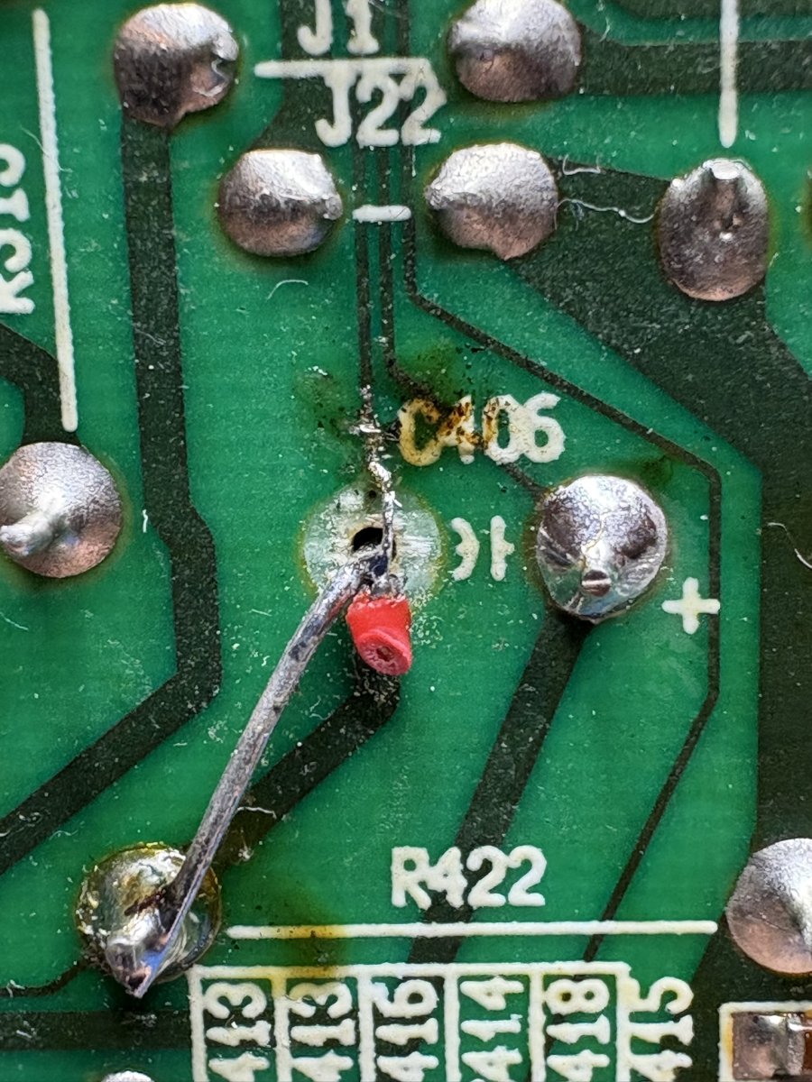

After inpsecting the chasis for broken traces I found and (jankily) repaired a broken trace at C406 using some 30AWG wire. Ugly as shit I know but continuity is solid (goes all the way back to the vertical linearity pot!) and I threw some kapton tape on top afterwards. Don't mind the lint I used too many q-tips doused in isoprophyl while cleaning.

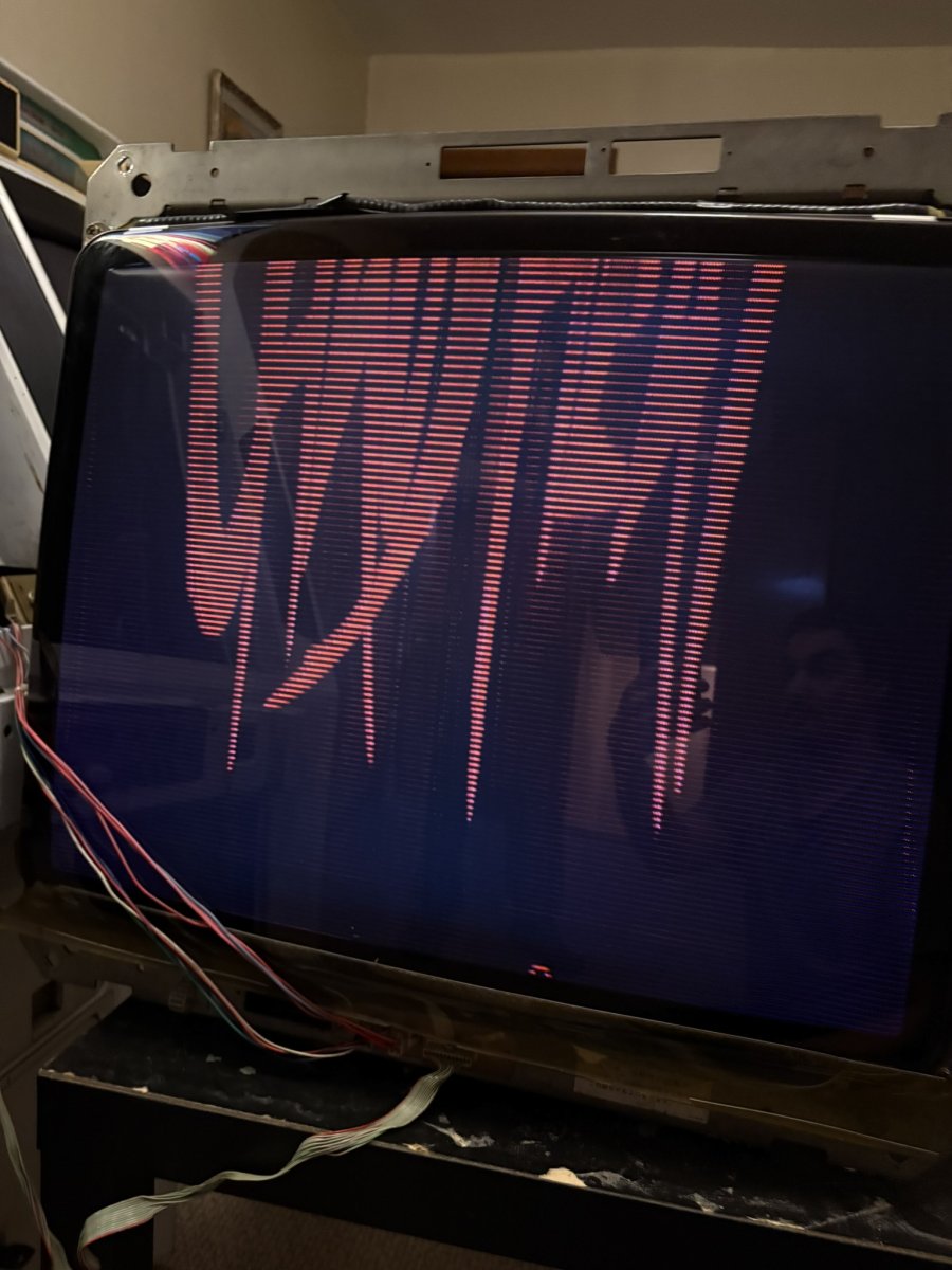

Plugged it in again after and the good news was that the image size and side pin cushion issues were fixed.. Also the image is no longer enlarged. But now the horizontal and vertical hold appear to be collapsing?
https://imgur.com/a/zhBk4ze
I tried messing with the horizontal hold 15kz and it only seemed to make things worse.
https://imgur.com/a/4PnpfUM
After this I went back and double checked continuity on every cap installed; everything seemed fine. Anyone have any ideas? I spoke to some of y'all on discord/twitter was told to start looking around the Mitsubishi video amplifier IC (M51387P). What pins should I be tracing the path on? Pin 17? (blanking pulse). I guess what I'm trying to understand here is a) what this issue is called and where to start looking first.

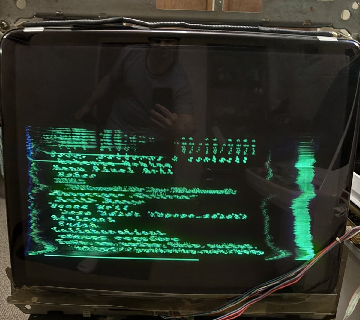

One thing I noticed is that if I mess with the horizontal hold pot there is still an audible change in frequency and a slight change in the image (but no improvement). Here is a picture of what it looks like running 240 test suite menu... Picture size osscilates sightly but stays at this height...
