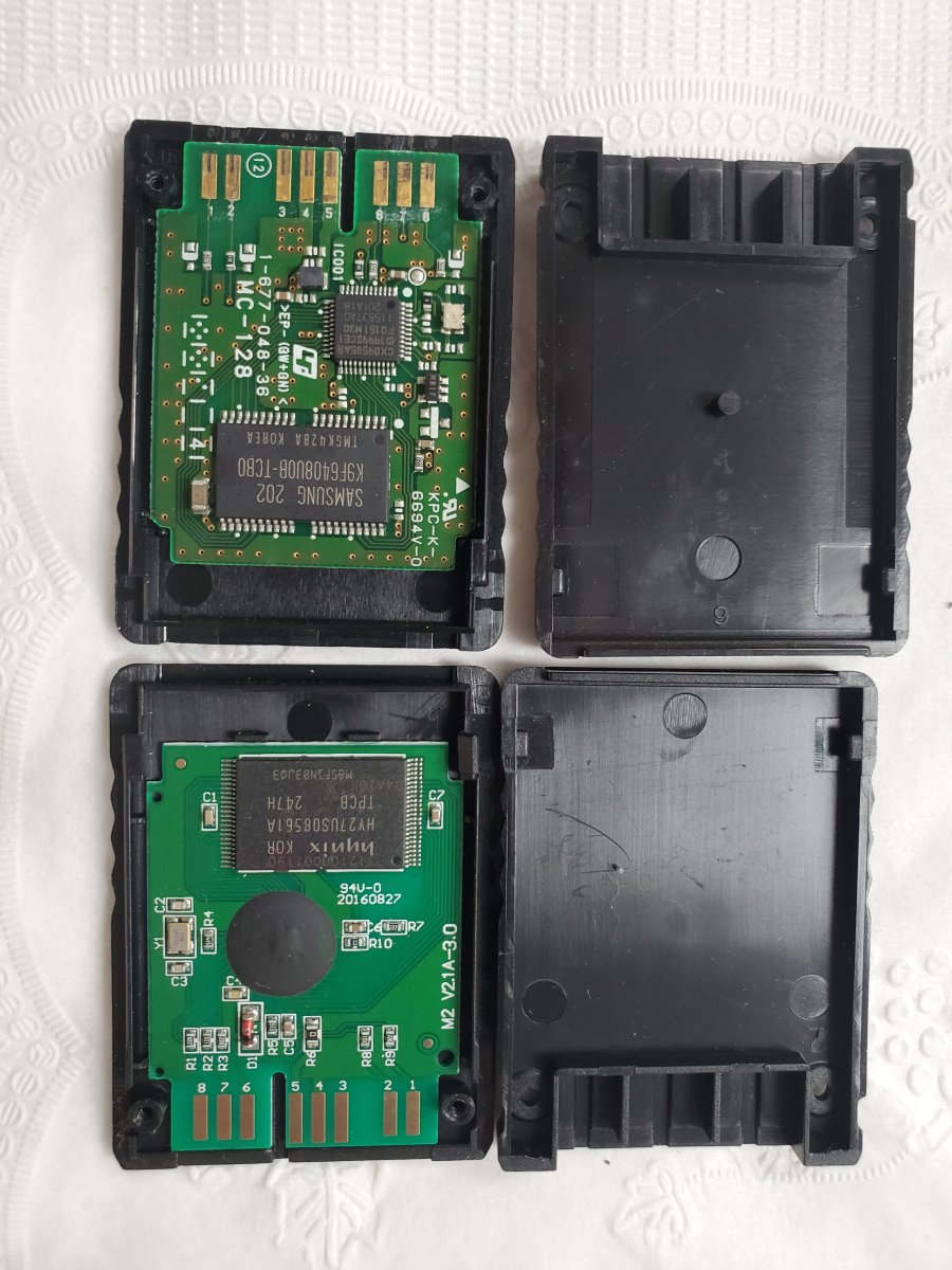

As far as Soul Caliber goes, I tried the eraser and Isopropyl Aclhohol but no dice, I wonder if the dongle is bad, I guess I'd have to send it in, I do have a CECHZM1 (Original) so maybe I can read it and or see if it even remotely smacks of the SC2 Key, but I have some more threads to read, I don't trust myself with soldering it onto a PS2 Memory Card, also because when I opened Both each looks very different... SC2 Memory Card on top (Virgin) PS2 On the bottom.
