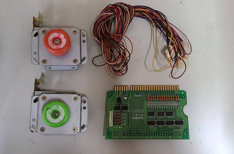

There are some really great games out there that either require or play best with a spinner, but I avoided them for a long time. I thought about building a spinner panel, but changing panels to play a small handful of games is pretty annoying, and considering my horizontal JAMMA setup right now is a supergun it would be double annoying playing outside of a cab. Regardless, I kept my eye out for spinners and when a set of Seimitsu LS-29s appeared on YAJ with a Capcom spinner I/O, I grabbed it:

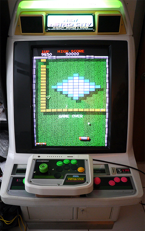

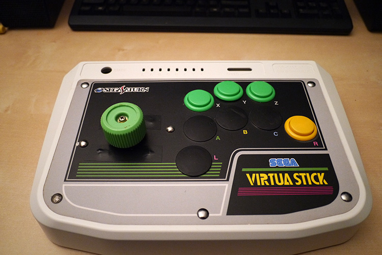

I cleaned them up and verified they worked with my Arkanoid PCB and Arcaniac JAMMA adapter, then I started looking around for some way to make using them pleasant. I spotted my old Saturn Virtua Stick and became enlightened, as the complete plans for what I was about to do emerged in my brain fully formed.
The thing already had some holes in it from a LS-56 install, and I hadn't used it in years because who wants to play arcade ports on the Saturn in 202X.

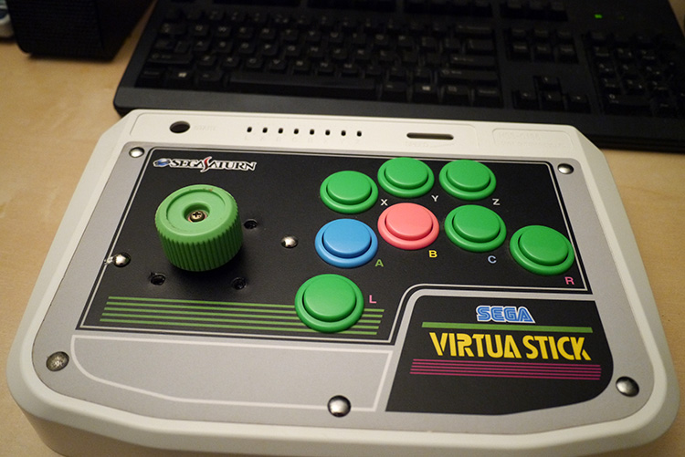

Originally I planned to be as lazy as possible and leave in the original buttons, but I ended up taking them out and boring out the holes to the correct 30mm size so I could have non-crap buttons and caps over the unused stuff. I'm not even sure any spinner games use all 3 buttons but it's the JAMMA standard so why not. Yellow button is staRt. Electrical tape is for covering holes, so it will look fully sick under the blue and purple mood lighting I don't have. I experimented with putting the buttons on the bottom row, as this stick had a weird design and that row is the one that lines up neatly with the lever, but went with the top row because it felt better when using it in my lap.

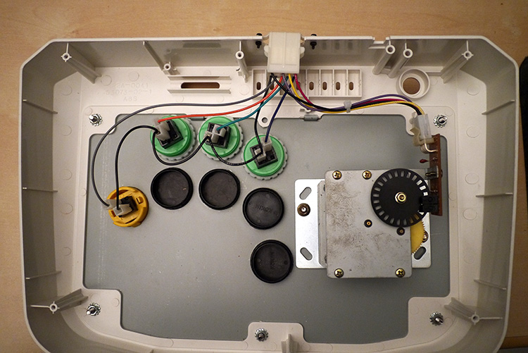

Wired everything up to a 10 pin AMP-UP male pin connector (same as used on Astro City kick harness wiring). I planned to use the panel mount feature of the connector as designed, but the case was too thick and it wouldn't lock in place securely enough to provide decent strain relief, so I improvised by spreading out the panel locking "wings" and drilling 2mm holes in them, then using M2 screws and nuts to bolt it to the case. Now it's "good enough"

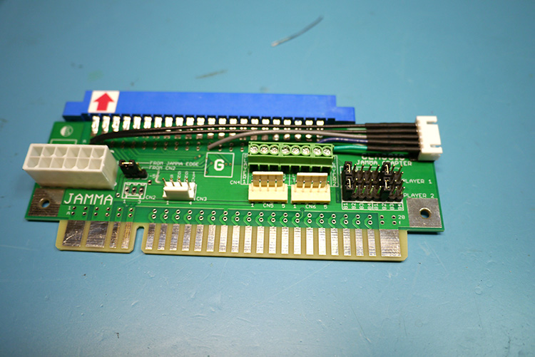

Now I can add a connector to the Arkanoid to JAMMA adapter:
I used a JST XH connector to tap the buttons and grounds for them from the vias on the adapter (thanks for including these Arcaniac). The wires are connected to the rear of the connector with Mini-PV contacts and then soldered. This sort of nonstandard use is the only time I think anyone should solder crimp contacts. The connector is held to the board with 3M's most brutally sticky variant of VHB tape, forged by Satan himself. I don't know the part number, I borrowed it from work. I also added some crappy knockoff Molex KK 254 headers for the spinner section because I ordered the version of this adapter with the screw terminals, thinking I would add JST NH headers myself. Surprise! NH and XH connectors are too wide for both players to fit and the only thing I had that worked are the Cholexes.

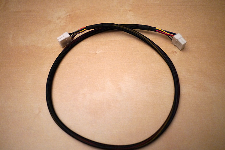

Now I can build a detachable harness for this adapter:
And a cable to connect to the controller:

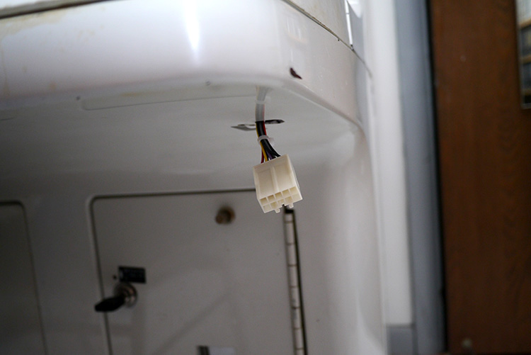

So now I can play Arkanoid sideways on my horizontal setup, but that's dumb. I need to be able to swap it to the cab with minimum effort. I will use the Astro City's fully populated kick harness connector, and run the cable out the control panel lock hole with a zip tie through the smaller hole for strain relief:
The hole is too small to fit the connector through, so I had to feed the crimped contacts in and then attach them on the other side:

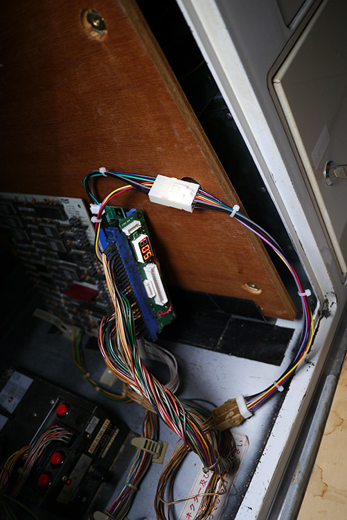

Now we need another cable to go to the adapter:
*click*

The Capcom spinner I/O is for interfacing spinners with certain CPS2 games that use them. It goes between your JAMMA harness and the CPS2 board and the spinners connect to the JST NH header on the I/O. I am not sure why Capcom went that route of a somewhat complex custom board.
The polling rate of the IO on a CPS2 isn't fast enough to count the pulses coming off of a spinner and decode them in software. so the board essentially does that in hardware and then converts it to joystick taps. The board you've got was designed for Puzz Loop 2. The only other CPS2 spinner game is ECO Fighters, but it uses a push spinner (like Forgotten Worlds) and has a different interface board since it's wired differently. Though that Puzz-Loop 2 IO board can really be utilized to allow a Spinner to be used on any 2-way JAMMA game (like spinner controls for Puzzle Bobble or Space Invaders).

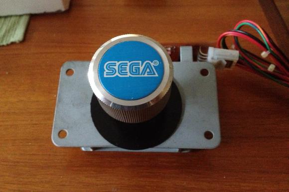

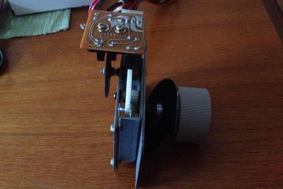

EDIT: @twistedsymphony do you have photos of the "normal Capcom Spinners" and "Sega 4-gear spinners"? Don't think I've ever seen these.
I do have some crappy ones I can post up later. the Capcom ones usually have a "B" on the knob as they were primarily used by "Block Block" (which BTW used an older revision of your Puzz Loop 2 interface board). the Sega ones were primarily used by Riddle of Pythagoras. Both are similar in design to the LS-29s

Come to think of it, I have seen that Sega spinner but assumed it was some cap for a Taito spinner or something. Capcom one is new to me and I kinda want one. Spreadsheet is badass, thanks for the great resource!
I thought the same thing unless I saw it from the side and realized it was a unique design.
