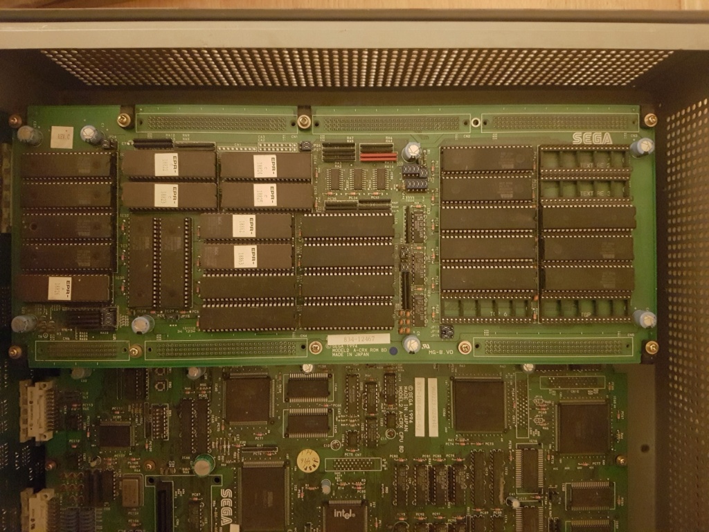

this the rom board I will convert, where can I find file and the mapping chip.:

but I dont know what eeprom used, I am pretty sure for the 512 ko files I must use 27c322 but other I dont know.
Nope. 2MB are for 27c160 (27c322 are for 4MB).
512kb are for 27c400 and 128Kb are for 27c1024.
You have to consider the 8bit mode while using these. Other thatn thatm youu have to burn & allocate in right spot. Then jumper setting. thats it
