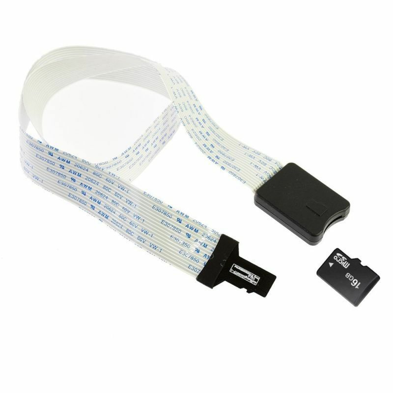

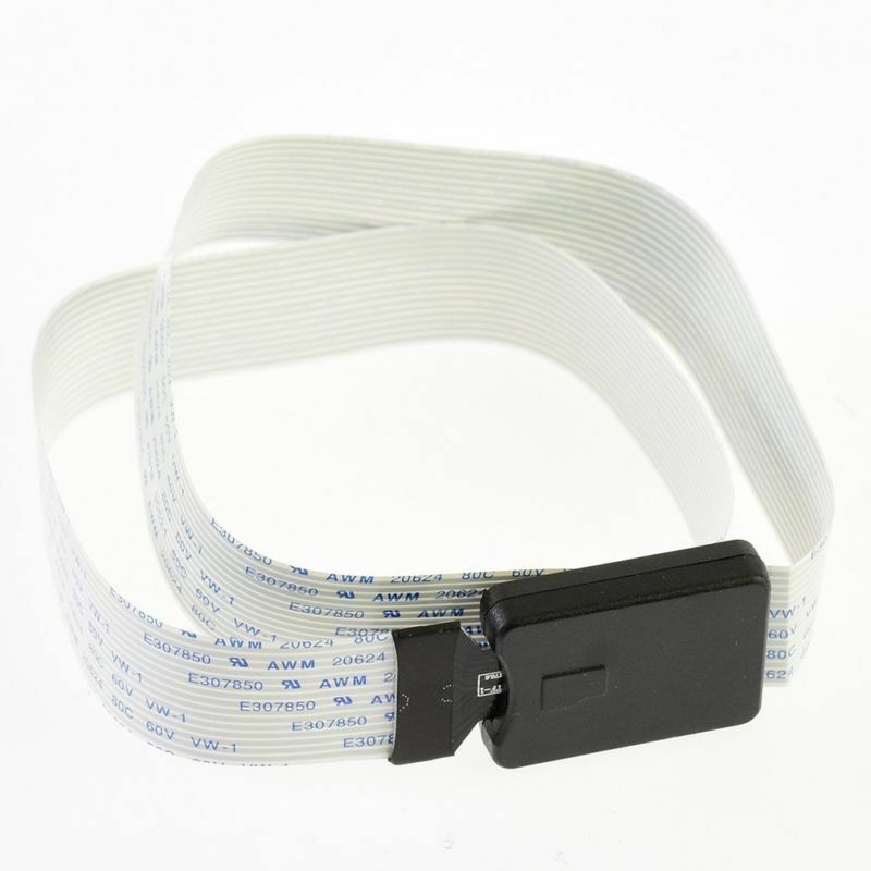

Here's the product. It plugs into the SD card slot and extends the cable. You can get them on ebay. Just make sure you buy MICRO SD to MICRO SD. It should plug into itself like the second picture.
