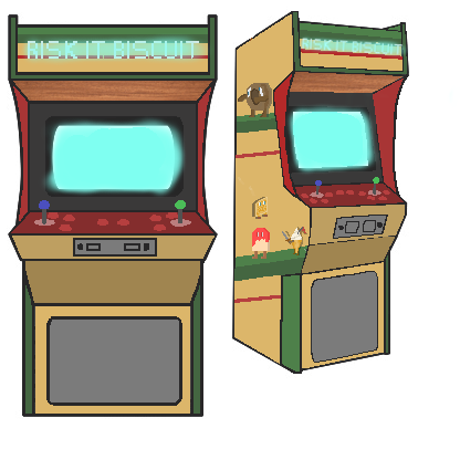

Now with the context out of the way. I would like to ask, What do you think of my design? I don't currently know a lot about Cabinets and what types are currently out there. I have done some research however.

I am not sure if the illustration is supposed to be accurate, but I’d recommend button layouts that obey the normal spacing and ergonomics instead of how they’re mirrored in your drawing. https://www.slagcoin.com/joystick/layout.html
Hey, I used a template for my first draft. Everything is subject to change. I'm a novice at all of this. What layouts would you recommend for a game that involved a lot of jumping and precise moving mechanics? This can be for single and double player layouts.

I wouldn't worry too much about an arcade cabinet design, and focus on a finished (or near finished vertical slice) of your game first.
Arcade cabs are somewhat of a niche interest, and takes a ton of effort and know-how from a design and build standpoint to get right. Juggling that on top of creating an entire game sounds like too much in terms of scope of work if you consider yourself a novice.

We currently are in the late stages of having a full beta. you can actually play our game. We are working on the intro and it will be a fully playable slice of the game. making this into cabinets is more of a hobby rather than the main reason of making the game. The game is very very portable.
I'm a novice to arcade cabinets. not to making and creating video games. We have a very experienced game dev team. Just not an experienced arcade cab team haha.
Getting the game completed is always the first option. But at the very least id like to make my own custom cab for the game for personal hobbies.
We have been making the video game for almost 6 months. This cabinet is a personal thing of mine. I'm the original dev that was working on the game. The team grew over time.
I hope this clears up things.

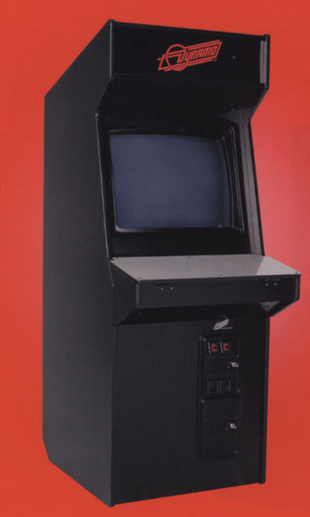

This is a typical US CRT cabinet (used standing):

I would base the design/proportions on one of these proven styles, or just use one directly. The slagcoin link above is extremely useful for panel layout. Regarding what controls to use for a game that requires "a lot of jumping and precise moving mechanics" that's pretty much the perfect use case for a typical 8-way digital joystick such as Seimitsu LS-32/LS-56 or Sanwa JLF/JLW and buttons like Seimitsu PS-14-GN 30mm or Sanwa OBSF 30mm.

thank you so much for the information. From first impressions id like to go for the first image that you posted. Its closest to my current idea. I quickly looked at the slagcoin link, ill definitely use it for my next draft where ill focus on the button design and placement. Ill note down exactly how many buttons would be needed for 1 player. I'm looking into the need for a joystick. currently one isn't exactly needed as in the PC version of the game, it is solely keys that is used for controls.
when you transition to an arcade cabinet those key controls become joystick inputs. it's a digital joystick so there's nothing really to change in the game code, you just map the joystick input to the corresponding key
understood. The controls don't use a mouse or anything. The joystick would only be needed to move left and right. Would buttons on the cabinet to replace the A" and D" movement keys be better than a joystick for precision movement?
It would be more "normal" to have a stick for movement and buttons for jumping/shooting/etc but it's your game so if you feel buttons work best it's up to you. I feel like buttons would be less precise, because it doesn't seem natural to me to control movement with buttons.
Fair enough, ill do more research on it.
