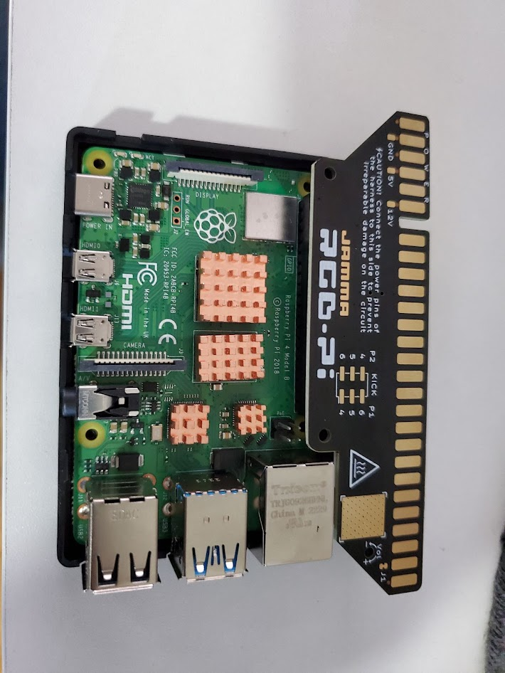

I use the Guncon2 in combination with the RGBPi in my cab, works pretty well. I assume it works just as well on a CRT TV.
Awesome! What does your hardware setup look like? And how were you able to get everything going from a software perspective? Was it just plug-n-play? Curious about games too. Are you going MAME, console, or PCB?
RGBPi, it's basically plug and play, only had to make a small rca adapter to hook up sync and that's it. There's a lightgun pack (with tested games) for the RGBPi.
damn, that's awesome! thanks for the info. can i ask if you're on OS2 or OS4? Curious if they have any 3D games in the pack (HOTD1-3, Time crisis 1-3, etc)
OS4, as OS2 doesn't have lightgun support. No 3D games yet other than Time Crisis afaik, but I might not be at the latest pack currently.
Ok thanks, I'll give it a whirl. This is a pretty neat piece of kit.
