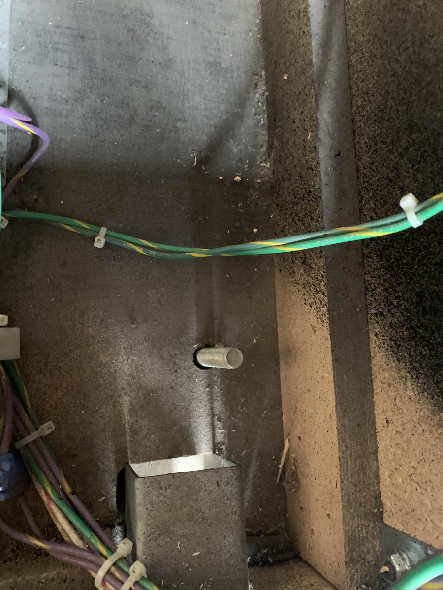

D darkairplane Student Joined Mar 22, 2018 Messages 23 Reaction score 5 Location Los Angeles, CA Dec 11, 2022 #1 Anyone know the correct size to replace leg levelers on a mortal kombat 2 cabinet? I would like to replace with Teflon/ nylon /plastic levelers so I can move the cabinet around easier. Attachments 5B8C65C5-1E45-4B06-8C7F-D5FCDAEA94E1.jpeg 204.5 KB · Views: 45

obitus1990 Enthusiast Joined Jul 18, 2020 Messages 195 Reaction score 112 Location New Orleans, LA, USA Dec 12, 2022 #2 I am pretty sure the bolt on a standard leg leveler is something like 3/8". Edit to add: they are 3/8-16 bolts. Here is a set of 4 for $12: https://www.arcadeadventures.com/set-of-4-glide-rite-leg-levelers/

D darkairplane Student Joined Mar 22, 2018 Messages 23 Reaction score 5 Location Los Angeles, CA Dec 12, 2022 #3 Perfect! That’s what I was looking for. Thank you.
