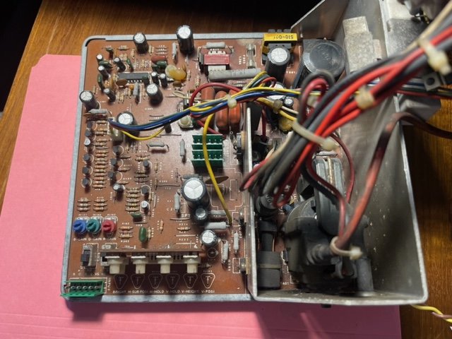

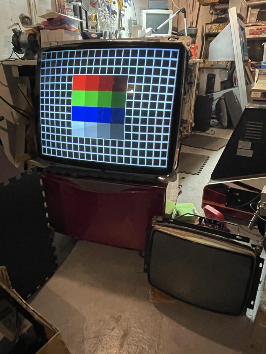

So after the 39 inch, I powered that small 19 inch:
though it was a hantarex but no, it appears to be a kortek? unsure of the model... anyone? @nem :)

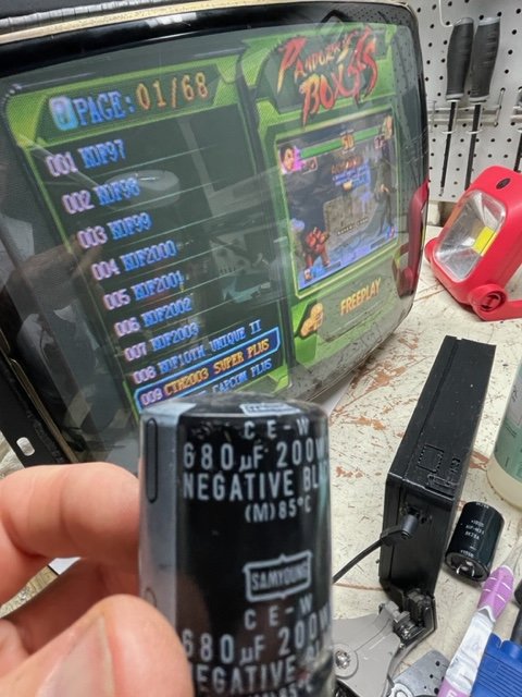

so anyway, on power on, total vertical collapse. (no picture)
checking it out, I see that the big snap cap is ballooned. happen to have an exact spare and voila, vertical collapse fixed:
well .. almost 100%: The top 1/2 inch can't line up. I changed a few caps that I had but still the issue remain. That is a cap issue yes?
thanks!

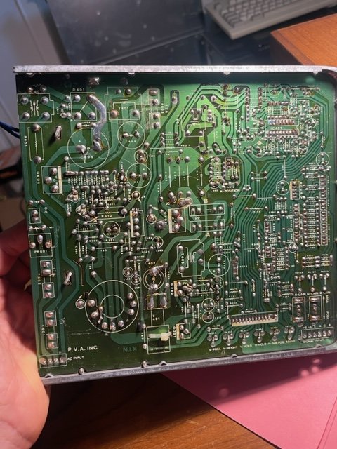

That should go away if you adjust horizontal hold.
It does not… the line goes left or right but never aligns properly. Caps should be here today so we’ll see if that fixes it or if it’s something else
