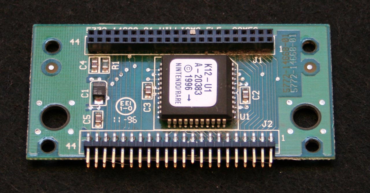

Killer Instinct Dual Board some discussion here though nothing public yet. Keep in mind the current simple/official conversion kit was for a KI 1 board, to easily become KI2 with a small adapter. but they did make dedicated KI2 boards that currently can’t be converted to KI1.

Well if anyone releases the info that would do it. Maybe even just a KI2, I dunno. Not public info! But the current public knowledge conversion (official from Rare) from KI1 to KI2 requires a small ide pcb with a security chip on it too.
it’s rare to see for sale by itself. If you keep an eye out for KI2’s for sale sometimes you’ll see it. Buy that one, it’s a KI1 that’s been upgraded, and you can downgrade.
