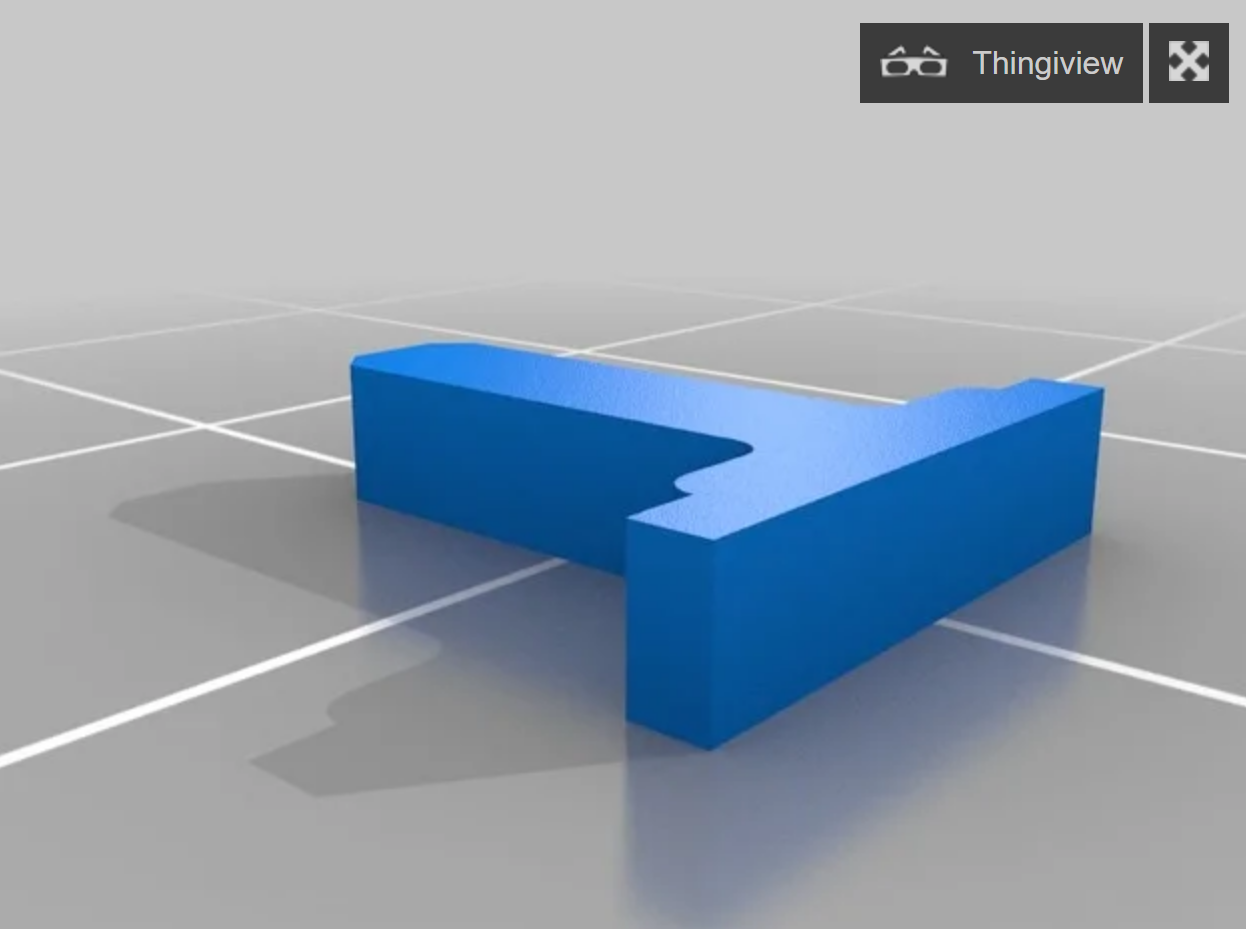

I did design one specifically for the Namco/Tekken kick harness since they have a somewhat different design: 3D Printed Tekken (Namco System 12) Kick harness connector key.

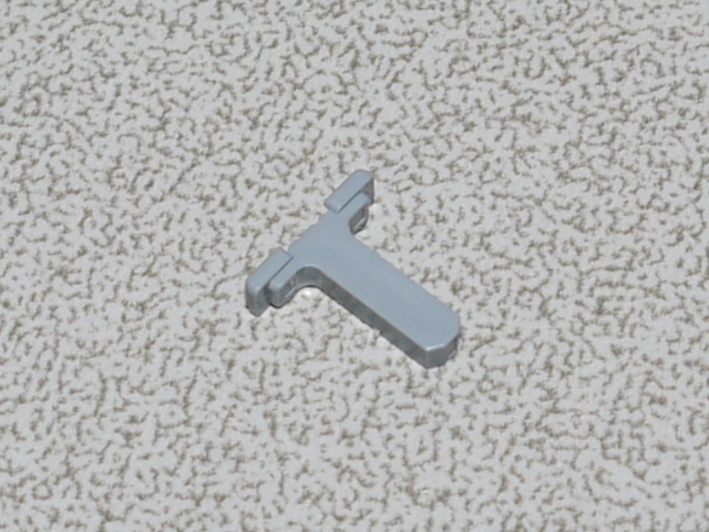

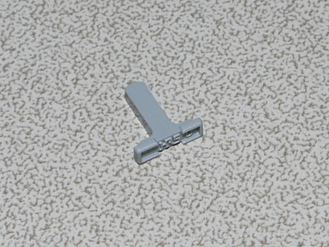

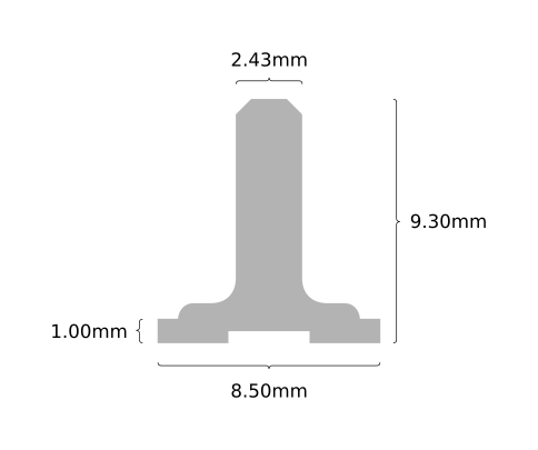

All of my cabs have Hirose connectors, so here are the specs for the Hirose key (aka G-pin):
Width is 2.00mm except for the feet which are 2.60mm.

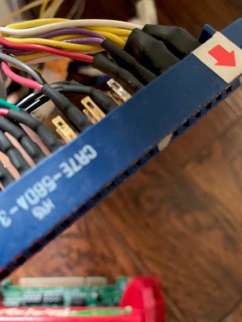

I bought these for an EDAC brand connector for the Minigun project. They fit the Hirose edge connector perfectly as shown below:
US Happ edge connector are a different story as the pins are pulled from that position and requires a different key. Still trying to find a good source for those.
