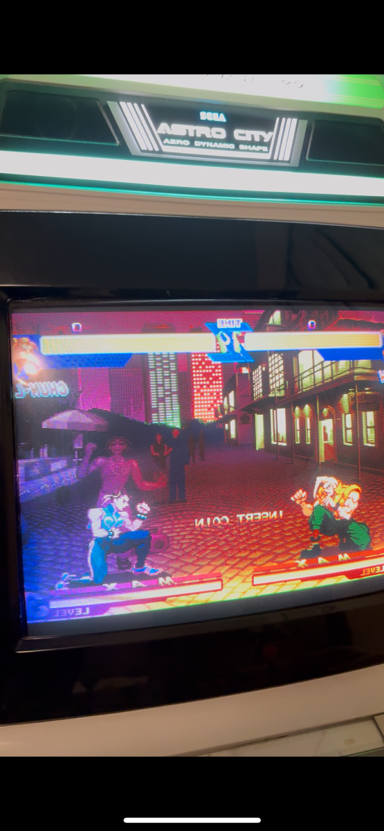

Just got an Astro city and hooked it up to a CPS2 game and the the image came out upside down and inverted.
I found out how to flip the screen in the test menu settings for street fighter alpha so it’s up right but the actual text and video is still all inverted (see image)
I did research and saw I need to mess with the yolk connectors but I can’t seem to google what those look like or even what to do once I find them? Any help is appreciated
UPDATE: I found out how to flip the yoke connectors, but that doesn't seem to have done anything it's still upside down and inverted unfortunately. Even if I were to flip the monitor 180, the inverted image is a bit odd. Wondering if it's the CPS2?
Update 2 FIXED:
Saw a suggestion to just flip ONE connector instead of both yolk connectors , did the red and blue horizontal ones ONLY and the screen returned to normal. Unfortunately every game I’ll need to enable the invert screen option upside down but that’s okay.
