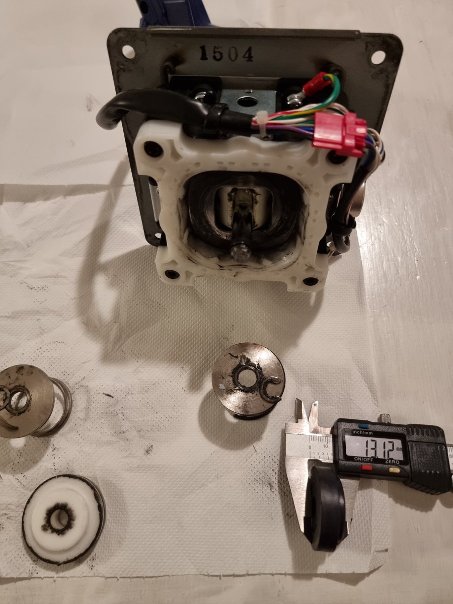

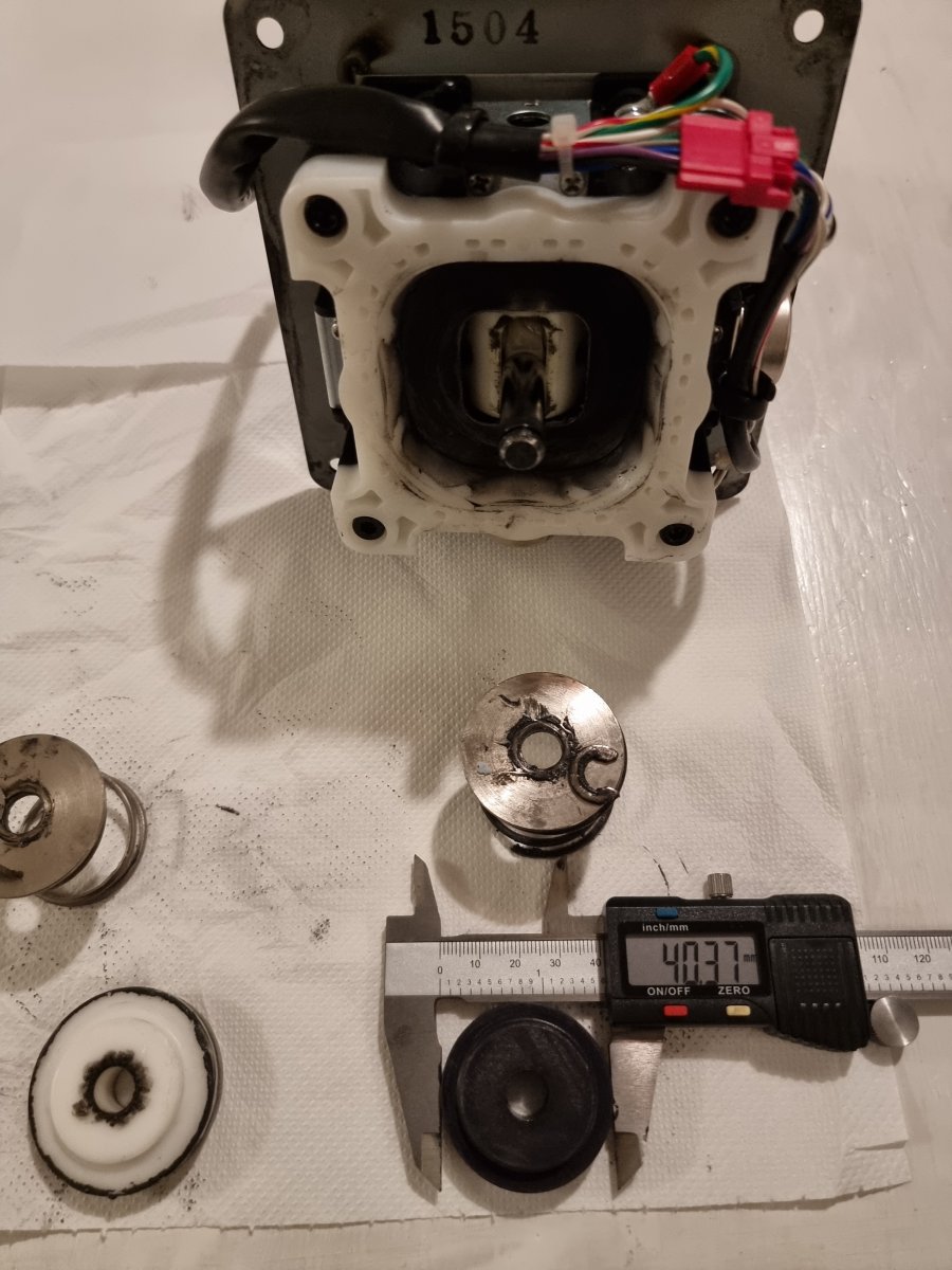

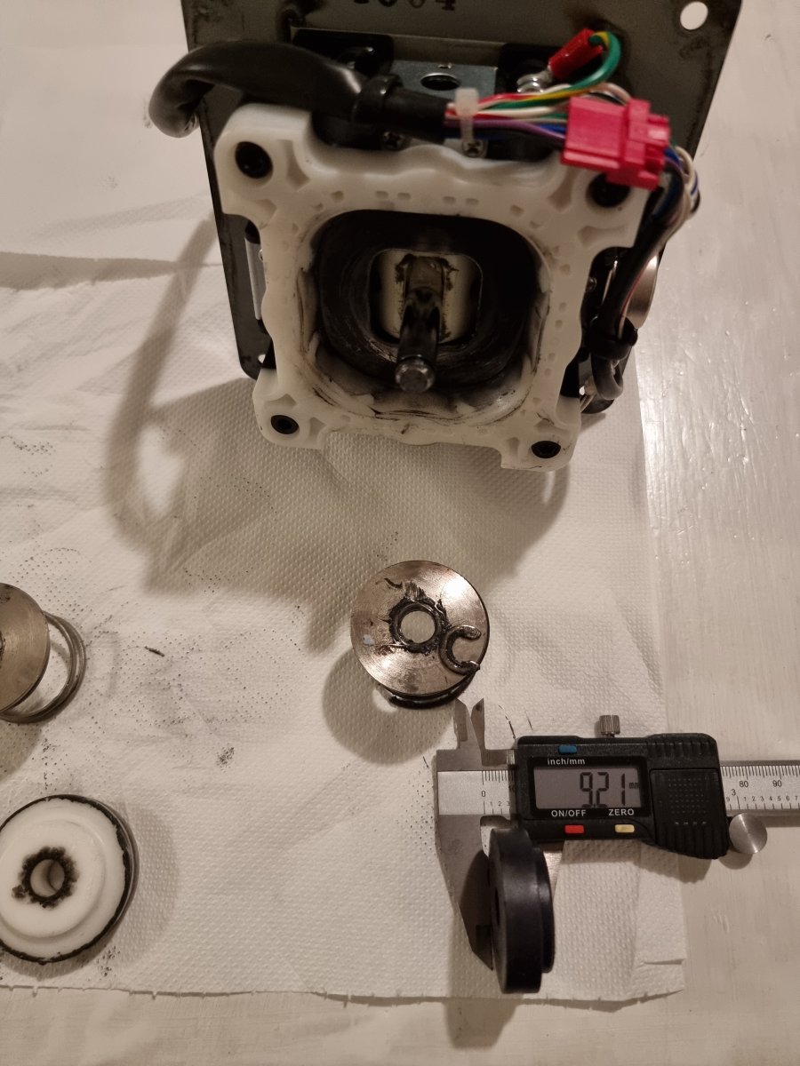

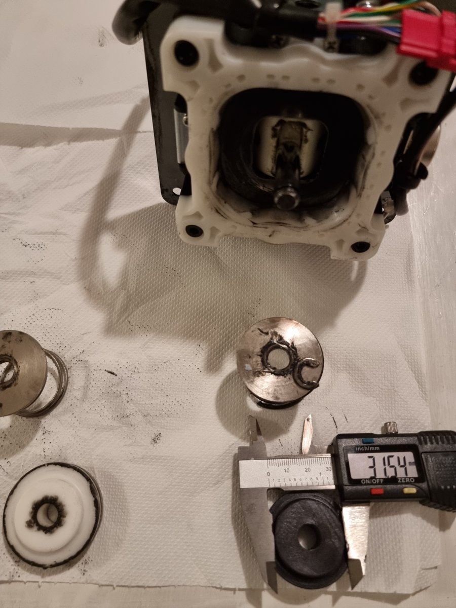

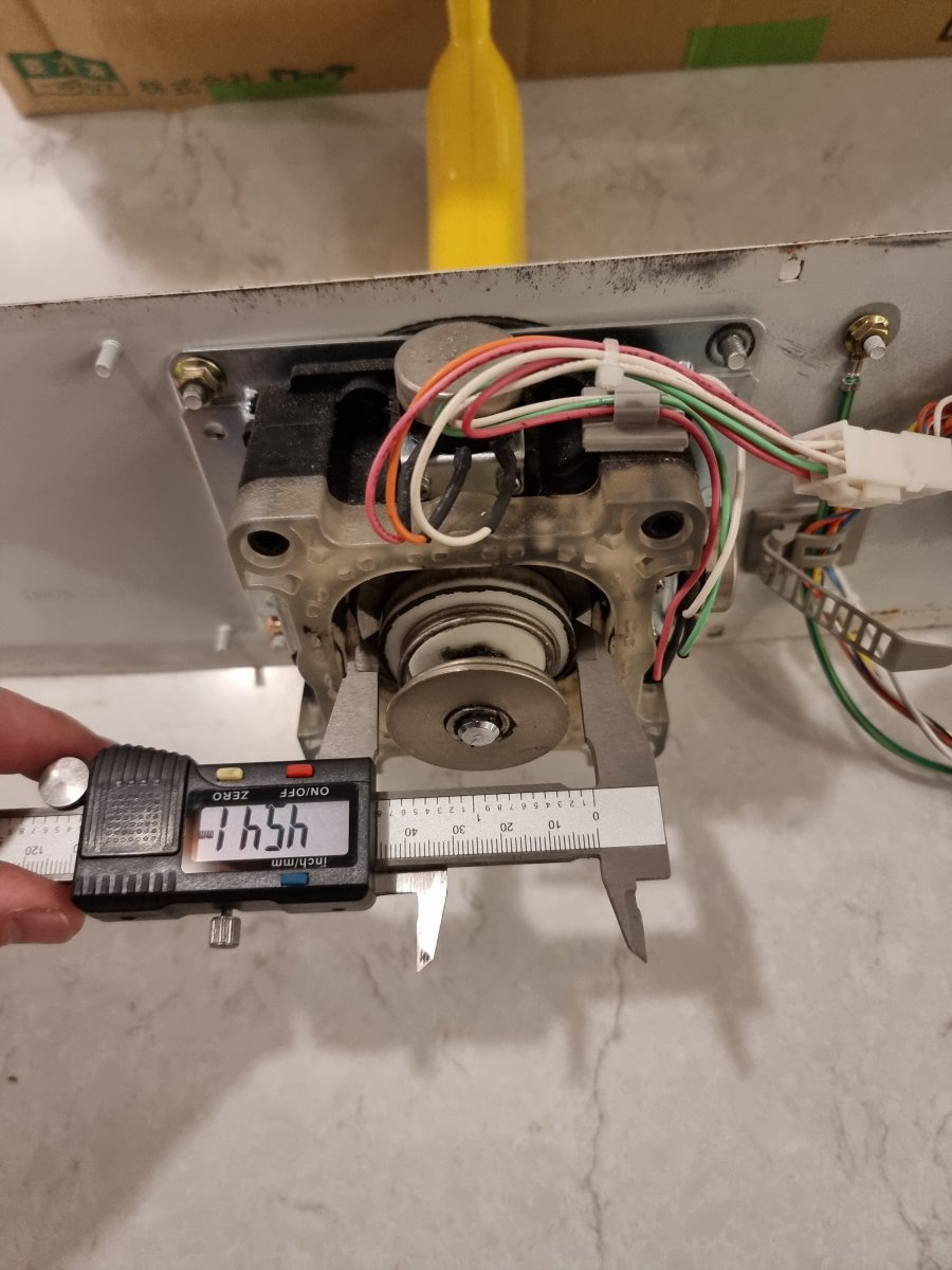

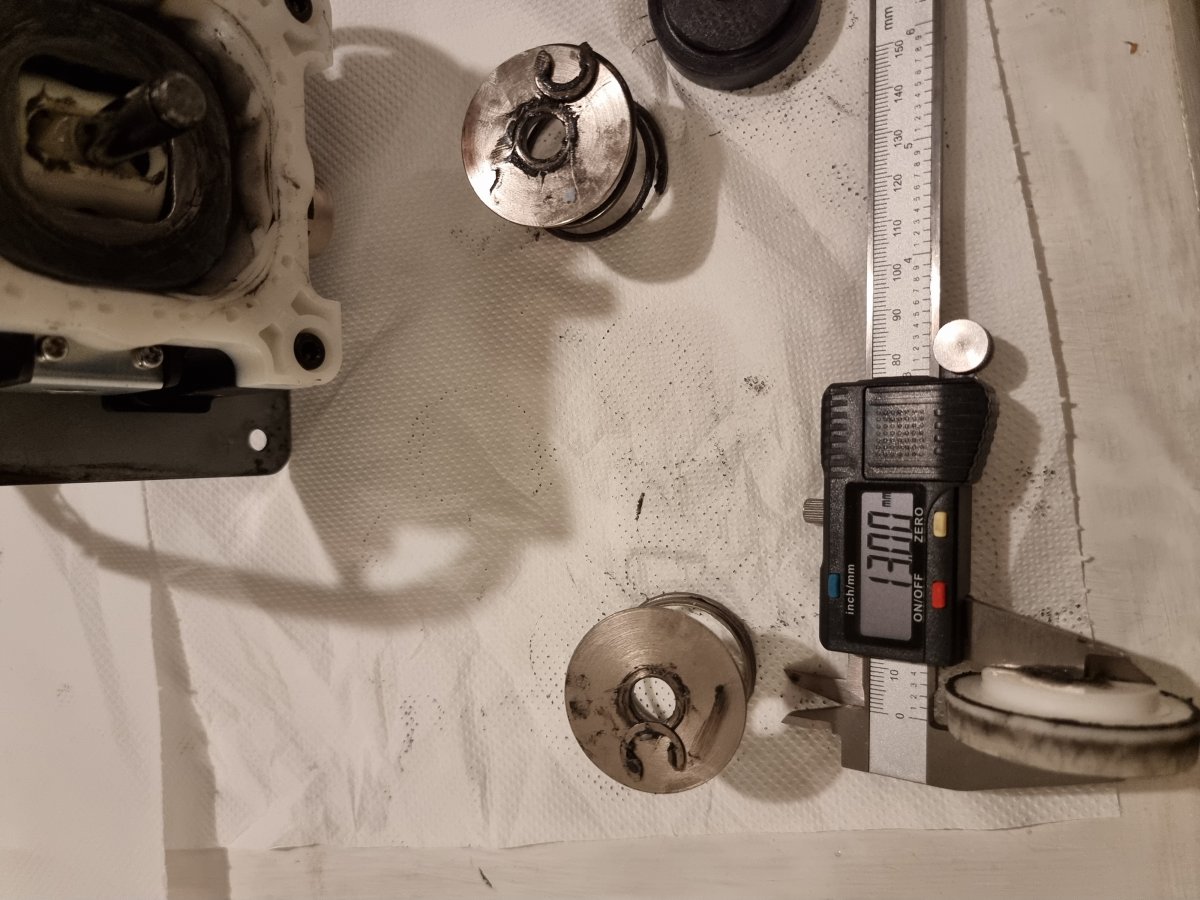

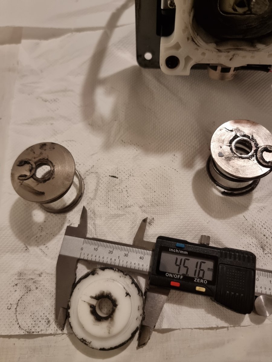

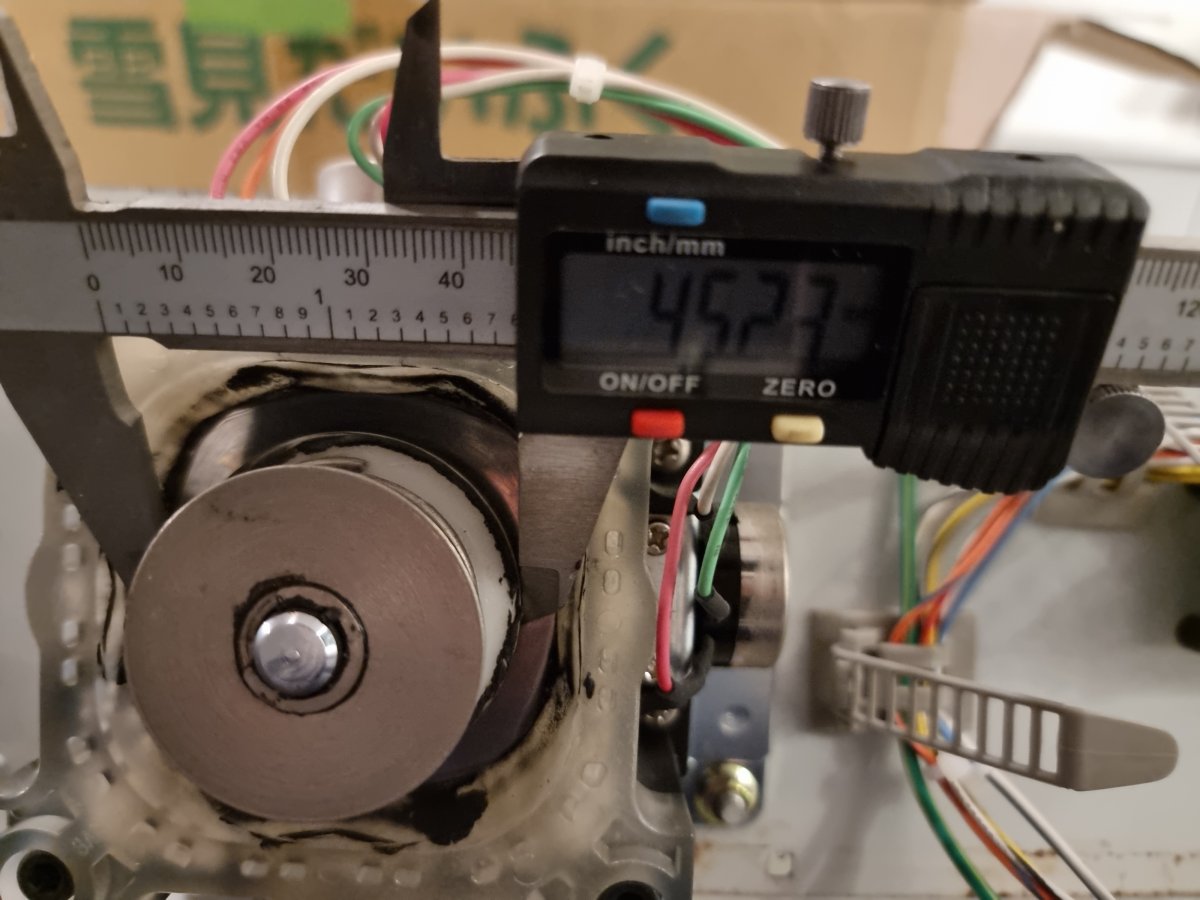

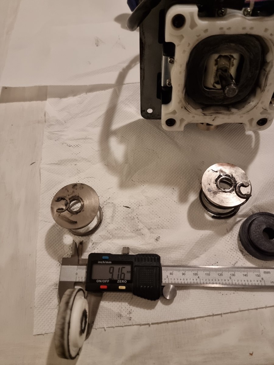

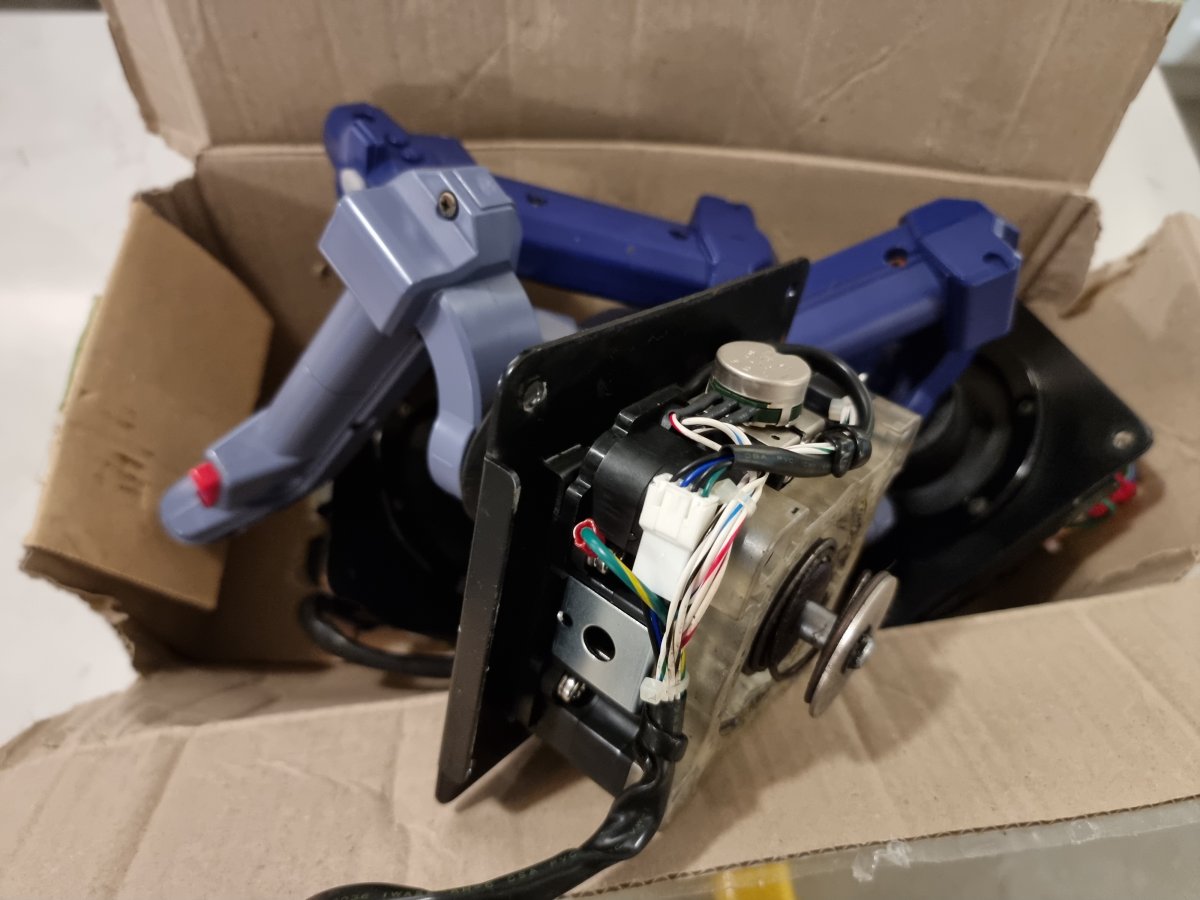

You are spot on the gundam ones have way more movement in them. I've checked a few types here:
Original monkey ball restrictor. 45mm diameter.
Gundam:
Both types the same 40mm restrictor disc:
Also the connector from the gundam sticks is different due to a ground cable and the 2x trigger buttons.
Original:
Gundam:
