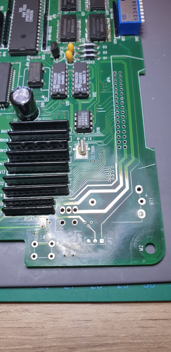

I have both 133-14 and 133-5 MB, cap are the same and value are written on PCB.
Did you installed CR2032 battery ?
I just finish repairing my 133-5 PCB damage with battery leak and I found on other website R24+D2 might be remove.
