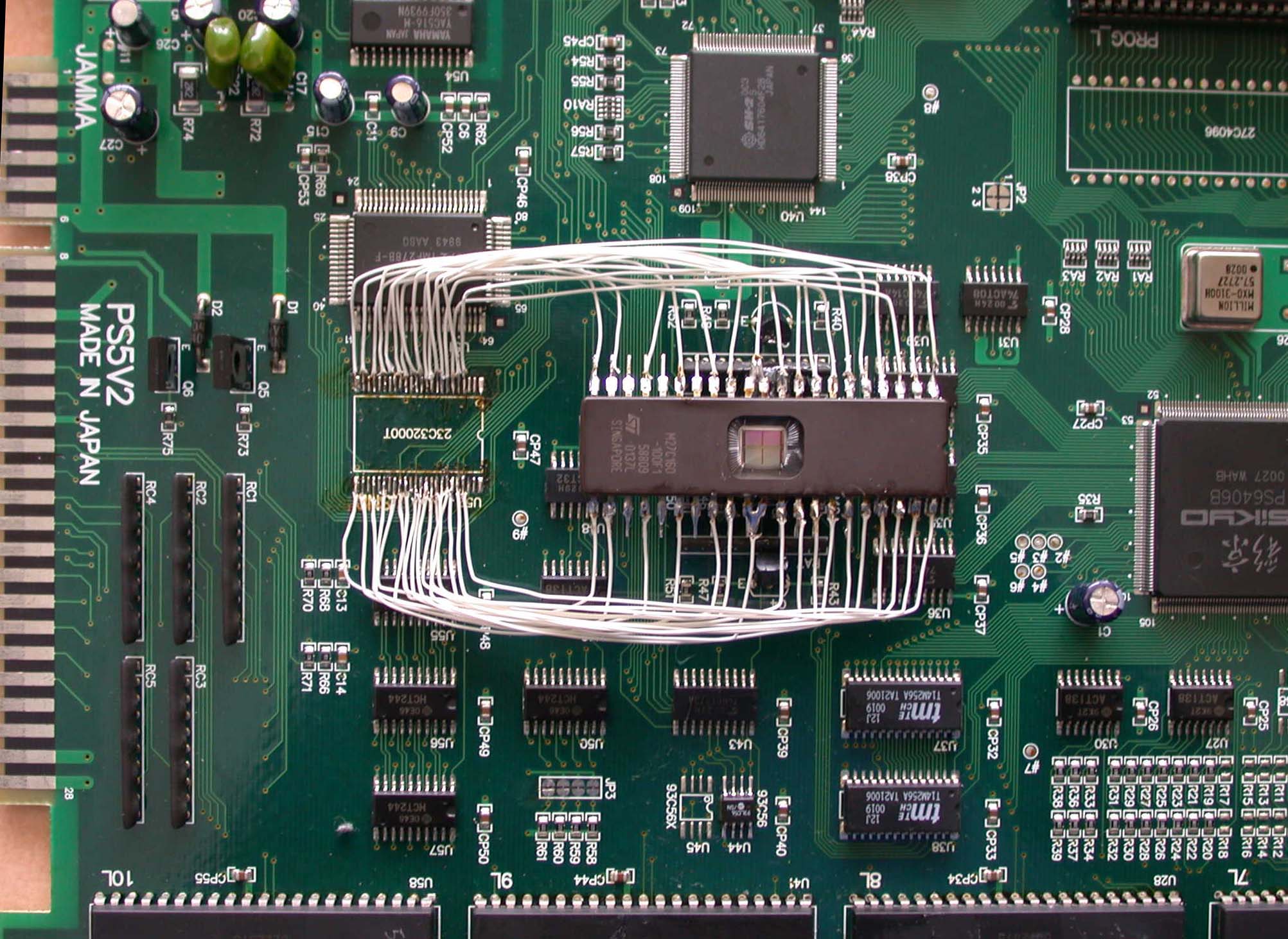

but I've been known to do some crazy manual stuff too....
