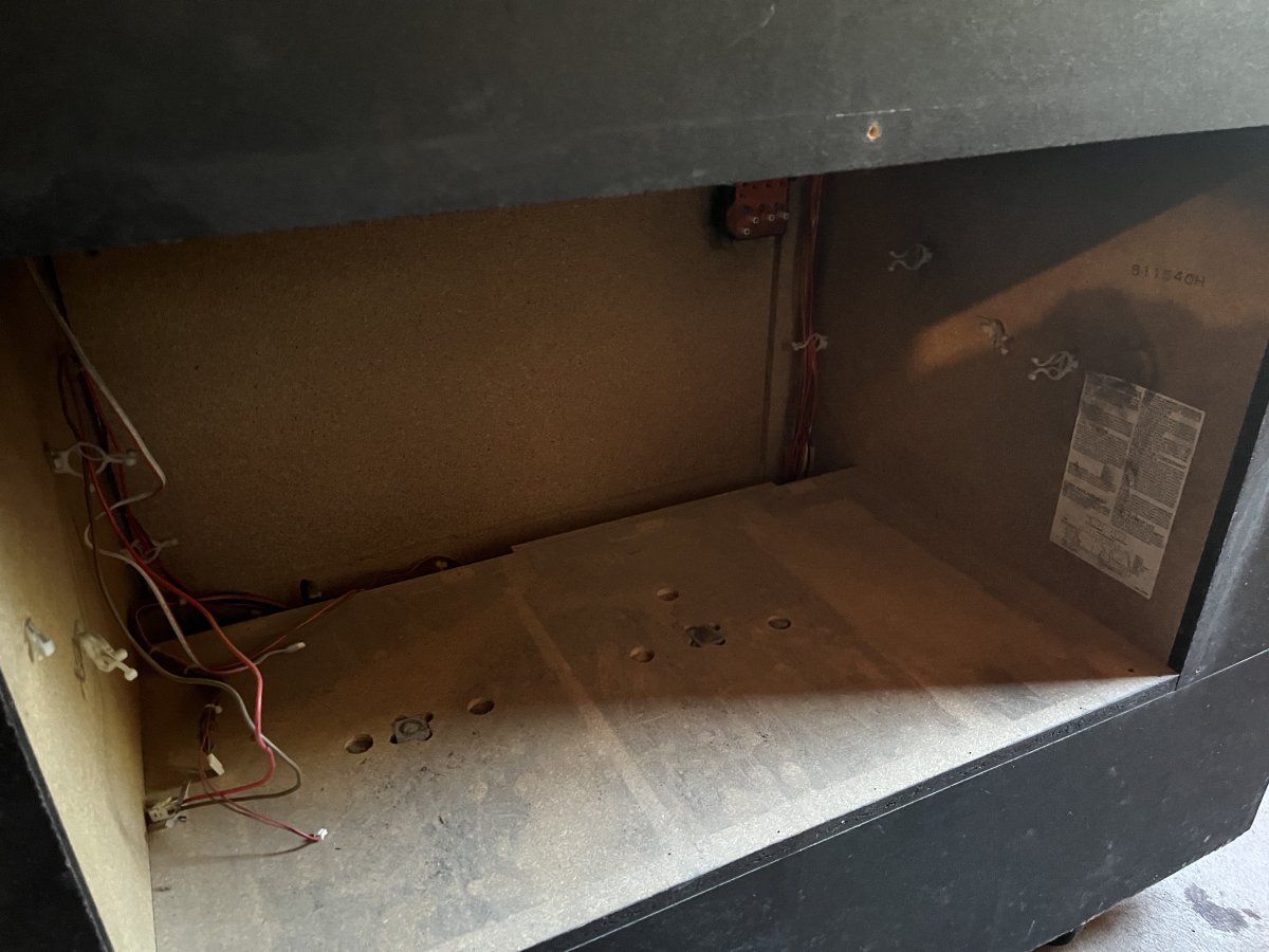

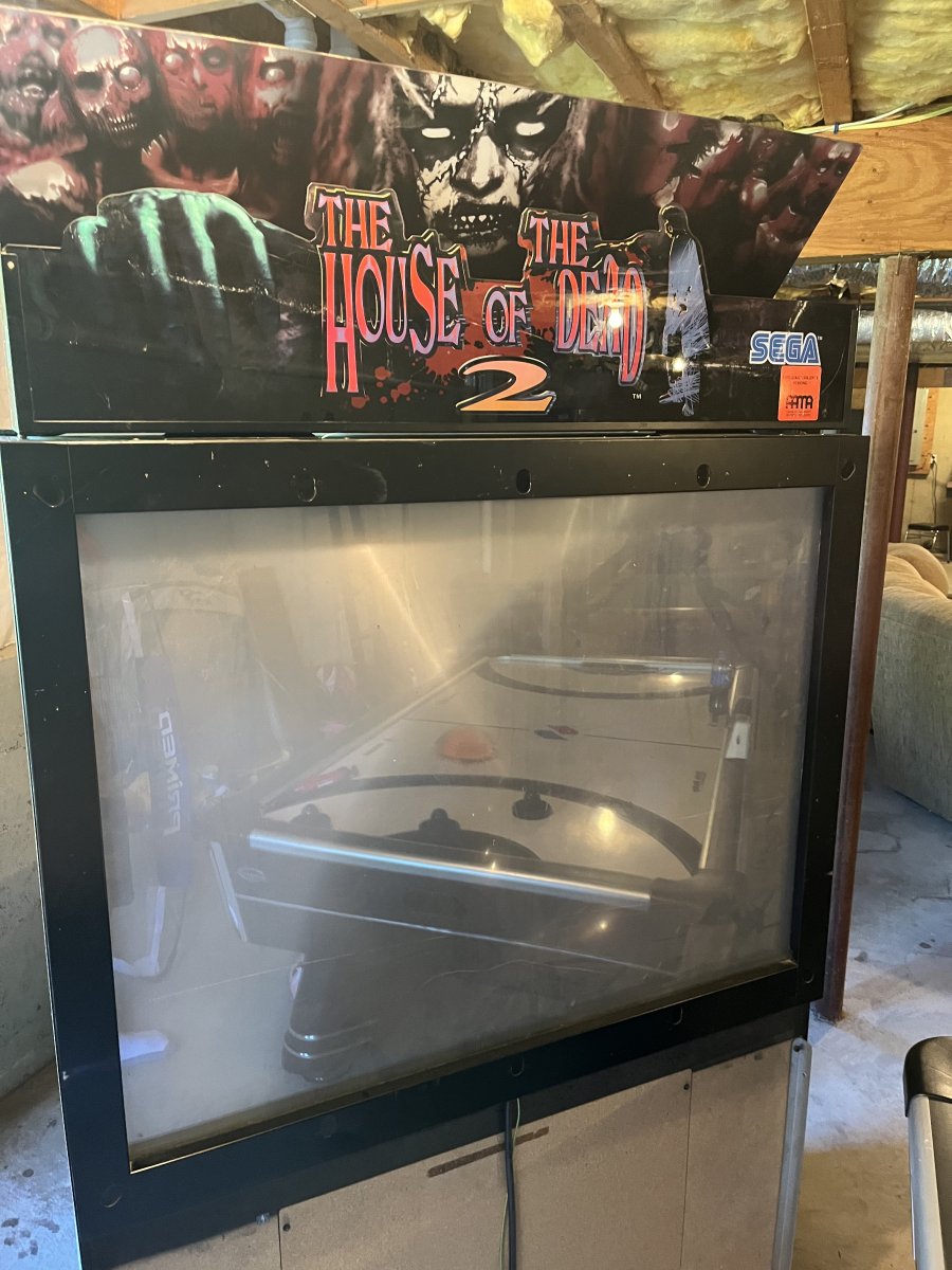

Hi all! I recently grabbed a HOTD2 DX. The projection screen hardware is missing from the unit.
I’m wondering what the best conversion would be for it: I’m not finding many good LCD fits for the 40 inch width frame, plus it still has the actual screen attached, and I also have no idea how to install a projector into the case if I went the old rear projection tv route.

There are some threads on KLOV and elsewhere with people finding new Projectors to install in these old rear-projection units. This is your best bet. You want what's called a "short throw" projector. These are designed to sit on the floor directly in front of the screen.
check out this video:
View: https://www.youtube.com/watch?v=WvcDSMM9v1U

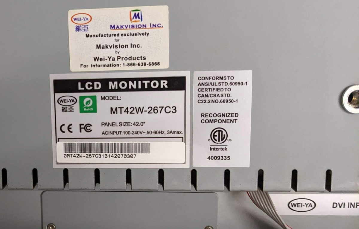

I picked up one of these recently myself and saw it still had the projection hardware when disassembled for transport.
When I further took it apart for cleaning, I found that It had also been converted to LCD screen and has a Makvision MT42W-267C3.
I haven't been able to test the whole thing. Still getting the grease/dust out. The LCD works though so that's good.

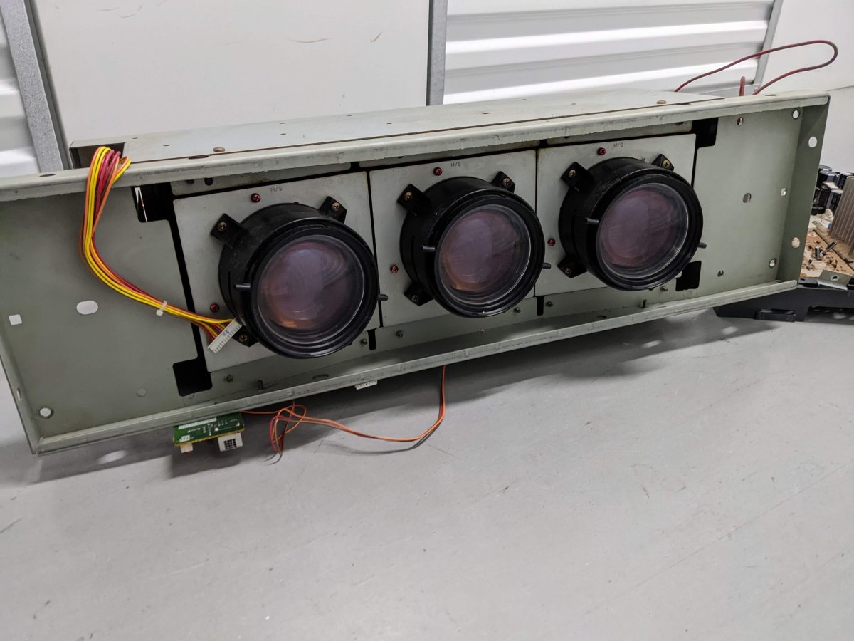

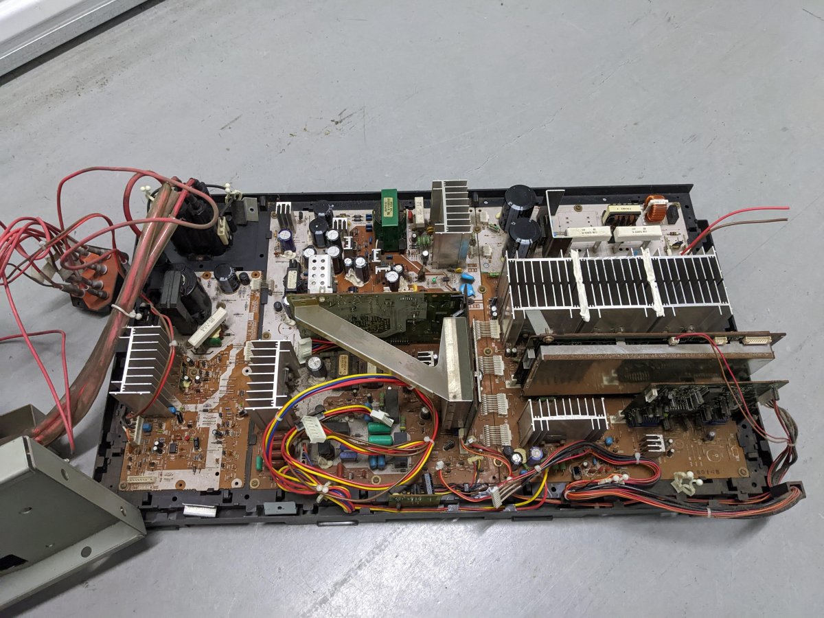

I took out the projection hardware as it is pretty heavy. Its intact save for what I assume is the cut power wires but I have no idea of its functionality.

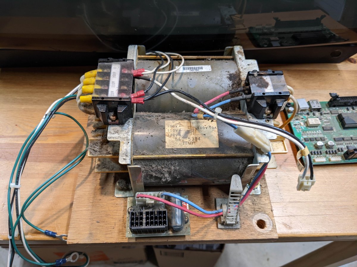

It also had this transformer in it which is heavy as all hell. Is this for the crt guns like the small transformers in a regular crt cabinet?
That dust/grease was in everything inside. Its nasty though I think the layer of grease provided some protection because fans are quiet and everything looks real nice after cleanup.

I actually ended up running with a ultra short throw projector. I still have to work out some details with making the fresnel lens work right, as the field of vision seems really off, and the picture is blurry as all get out from grime. Plus I need to check how to flip the screen still, which I’m assuming is just a digital option.
Can anyone help me with how to figure out the proper position for the Ultra short throw projector? Has anyone done this project before? I’m having issues with getting the height and distance right to frame the screen perfectly.
