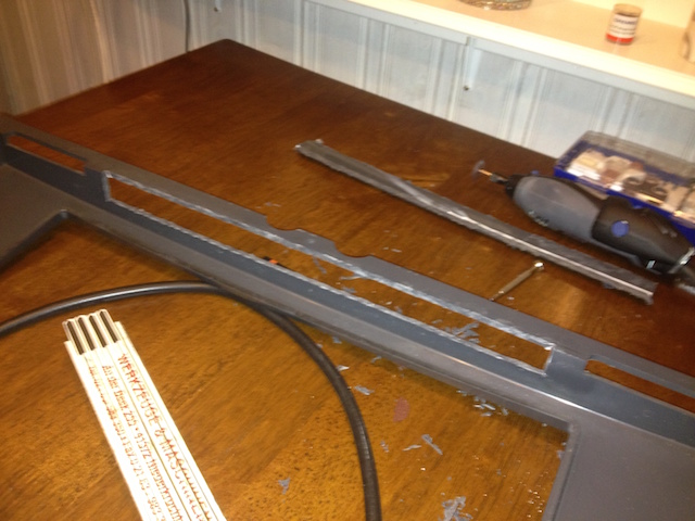

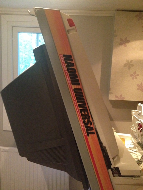

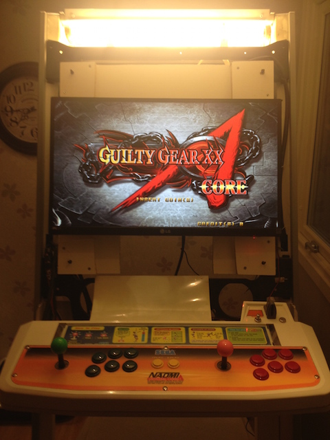

I needed a test cabinet and since I have a couple of NUC-cabinets one of them had to be converted :)
I wanted a cabinet that could support JVS and Jamma. At least six buttons and all resolutions. This would allow me to test all systems and games.
It had to be easy to switch between vertical and horizontal. And I wanted the biggest screen possible.
Switching between horizontal and vertical in a standard NUC is a pain in the ass. For newer systems you could use HD-resolutions (Type X/X2 Lindbergh etc). So i decided to use a IPS flat screen mounted on a rotating arm. IPS has great viewing angle compared to a regular TFT screen. For lower resolutions I use a EGA to VGA converter. I will in the future use a scanline generator to get the screen a little more arcade like.
The bezel had to be modified a bit with a dremel, as the upper and lower part of the plastic front on the cabinet to accommodate for the bigger screen. I used wood and bondo to rebuild the bezel since I couldn't find a big flat screen in 4:3 :P . The result was however very good and I now have a great cabinet for testing just about anything. You can see the finished result in the last picture with a game in vertical mode :)

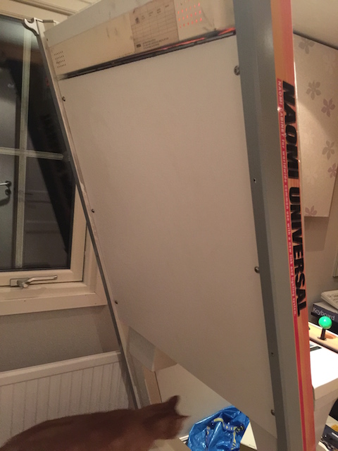

Since I converted it to a flat screen I was also able to trim the fat a bit. I made a backside out of wood and removed the big plastic one making it a tiny bit more sexy (or easier to move anyway).

I used a 26" tft screen.
Later in my E3 HD project I used a 27" IPL screen.
Hello Jonas :)
Yes, I tried to find a 26" first. But then I thought what the hell... if it fits it fits ;) Seems hard to find a good 26" for a good price.
Great Job! Really love the back side, sexy as hell.
Can you please post a picture of the cabinet from the back?
Best regards.
what material is that? i know you said wood did you paint it?
It's laminated wood. I used to work as a carpenter (and now as a developer... life is full of changes) so I pretty much get material for free/dirt cheap from my old work. You usually use this material as the backside for kitchen cabinets :)
