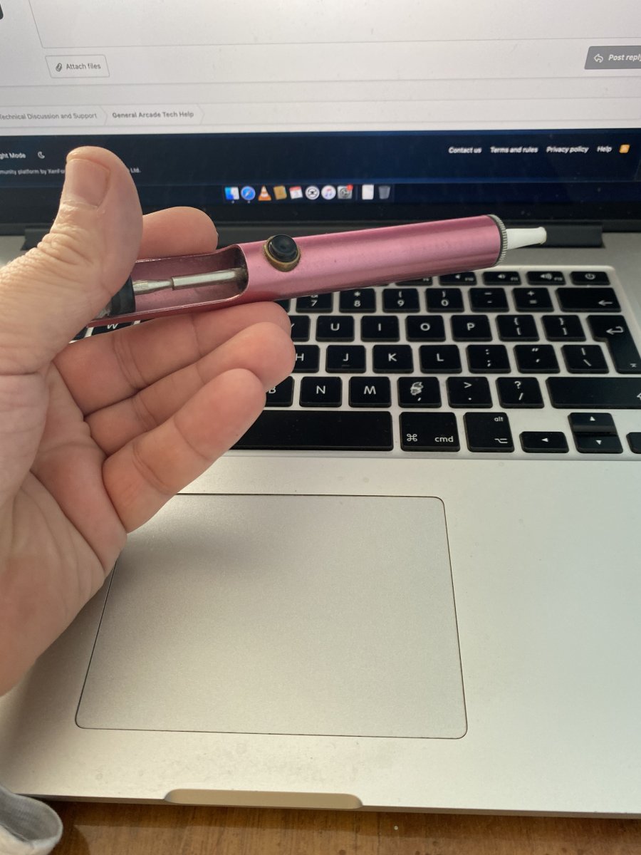

I used ZD-915 , but i purchased FR-301 from Japan to have a alternative desoldering tool ! Anyway , i also use mechanical like what is in picture with good results :happy:
