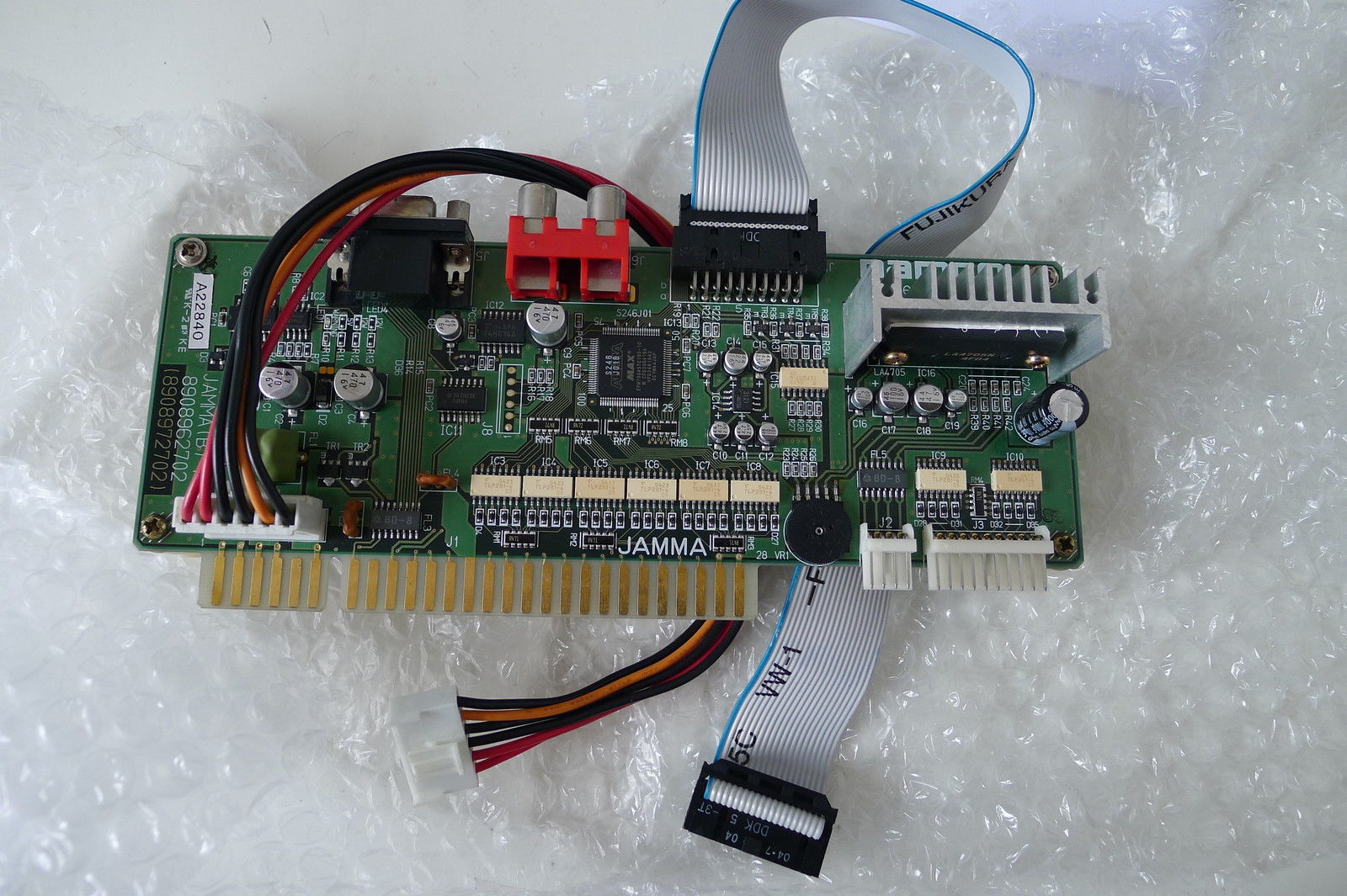

How do I power this thing, is it the same connector as what I've got going into my HAS? It's a different pinout though.
@twistedsymphony where can I get those IOs? They look like they come with a power cable that'll make things very easy. Although how does it connect? I don't see where that ribbon goes on a 246. (I am getting a 246C)
the usual places... eBay, forum marketplaces etc. @defor might have one
The ribbon cable plugs into the side:

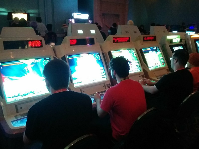

I had not noticed this thread, but I just started messing with linking my 256's. I got Z Gundam DX on 2 cabs going after a small headache (didn't have a switch/hub laying around, had to use a router. I had to change the routers own IP to not interfere with the games network traffic).
Pretty sweet to just hook up lan and go. The menu settings took some trial and error though. Definitely not any worse than doing optical on NAOMI's.
Error screen if you screw up
Settings that ended up working ^^
Victoly ^^

If you have the namco 2x6 jamma IO it powers the board via a small cable.
You also have the option of using a jvs psu with the 2x6 adapter looms, and virtually any jvs IO in that case.
