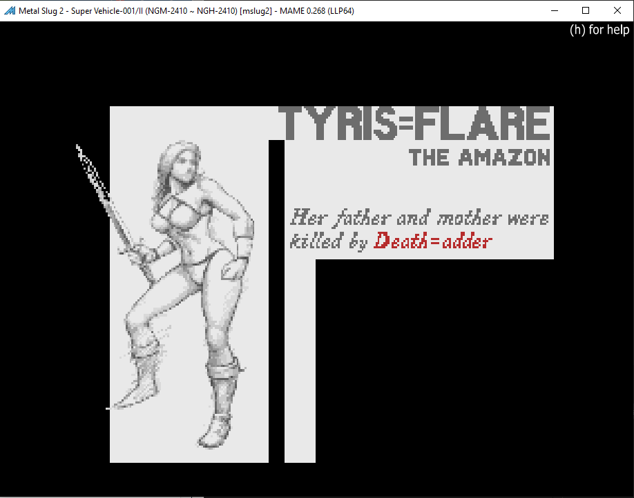

The below screen is an interesting one. The system 16 tiles are 8x8 and 8 colors. The below image uses 16 grey scales, so to manage this it implements two tile maps on top of each other. The "proper" way I guess would be to composite the image then convert it to something using less sprites and c rom. But, I like to get shit done, so instead I've left this using two layers. Just makes things simpler. ( yes I'm fully aware I've not set the background color yet ;) )

Implemented a function which latches the Neo Geo tilemaps onto each of the layers scroll values. Made for moving all this stuff on the title screen increadibly simple.
Edit: something you may not notice is the color fade on the Sky on the original is a little glitchy and I didn't like it, so generated a fresh set of pre-faded palettes to run through.
