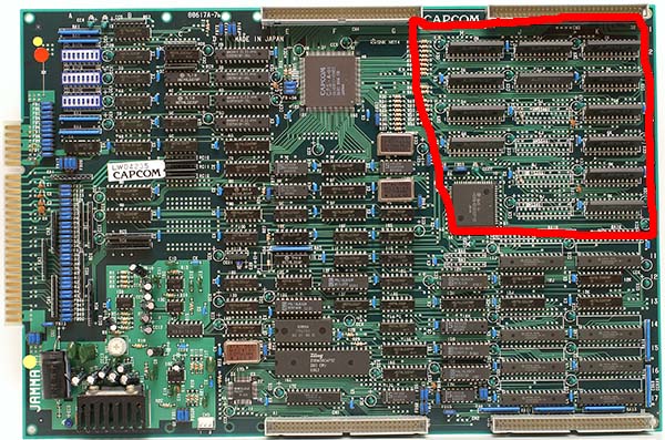

video ram is on the A board. look for a bunch of chips all together looking the same on the top right side.
unfortunately for you, not knowing what is ram also means not knowing how to remove them and not having the correct equipment.
you probably wont be able to fix it yourself.
the PROGRAM eproms will always be different unless you pick the same region. if the graphics roms match then the roms are ok
is your version (program roms) in MAME? if not please send them to me so they can be added.
Thanks for the help. I will look into MAME and see if the ROM from my board is already there or not, but I suspect it is. Also, you are correct that I need help identifying the RAM chips, but I can solder and know how to replace a through-hole component. I've done many repairs to neo-geo carts before by replacing chips with eproms, so I'm comfortable with that. Only thing is that I am not very knowledgeable yet in the CPS1, so I will need a little guidance.
I'll check the traces that go to/come from the chips you mentioned and update this thread.
BTW: my board looks exactly like the one you posted on the right, the chips have a single line of pins (SIP?) as opposed to the other one which has DIPs.
Thanks!!
