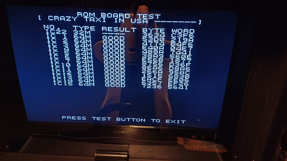

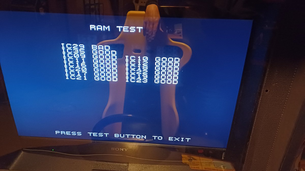

Can you take a picture of the rom test in the test menu?
ROM test and RAM test attached. Looks like WangDrum is right. IC29 is the super cap I replaced.

The high score is stored in nvram that is powered by the super capacitor after the power is turned off.
If the high score is not saved even after replacing the super cap, check whether the trace is rusted due to fluid leaking from the super cap before replacing.
Breakdowns due to supercapacitor fluid leakage are common.

Thanks. I did notice some corrosion on the board and cleaned it. I'll take a second pass.

Fixed!
Thanks for the help everyone. WangDrum called it. The IC29 super capacitor I replaced was good, but the corrosion from the previous one was causing a bad connection. Scores are now saving after power cycle.
