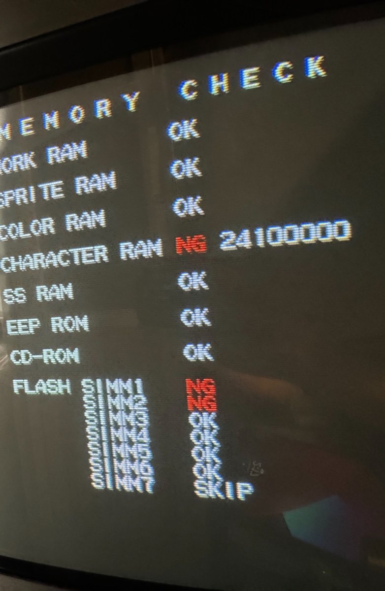

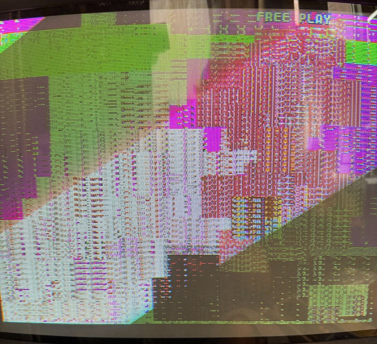

Hello all i would like to request some help on identifying the issue with my board.
I get perfect screen in setting page (like when there is no color) but then in game it will become scrambled
I am sure the cart is fine because i used it on another board. Could it be issue with my Simm? I can complete the flashing though
thankyou very much.

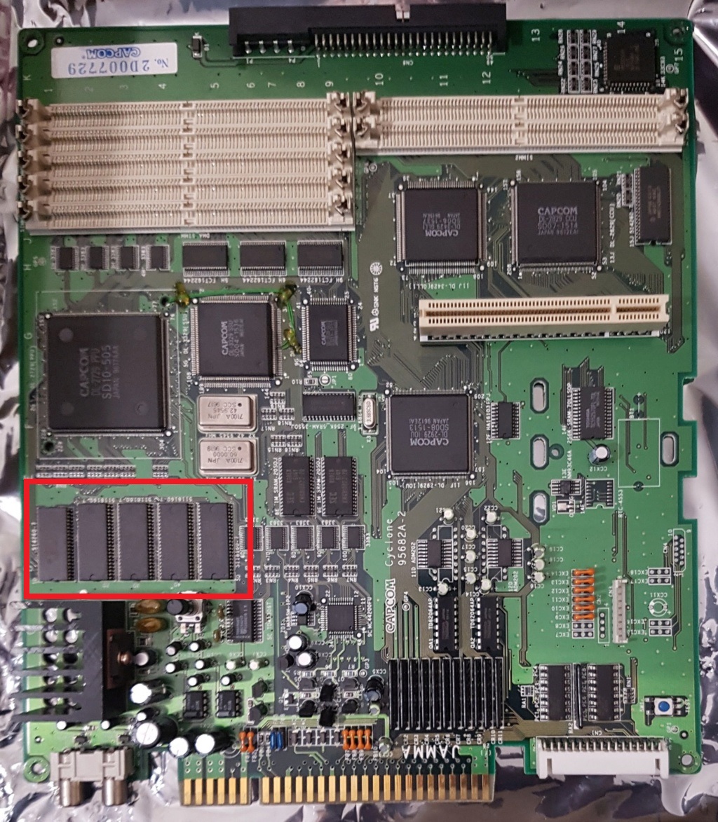

Is this Darksoft BIOS? Seems like the results on the flash SIMM are glitched, but I am assuming 1 & 2 show NG because you have a Darksoft BIOS.
Presumably the CHR RAM is bad? Is there anything obvious going on in that area (corrosion, etc.)?
Thanks all, yes it is darksoft custom bios. the simm1 is back to NG after 2nd round of rewriting. looks like i will need to get someone to fix 2D-5D. hopefully i can get it working again.
The flash SIMMs 1 and 2 will always read NG when using the Darksoft image because removing the suicide protections changes the checksums that the game expects in the diagnostic routine.
Thanks man , i was gonna make a post about it , this saves me time 😊 thanks again
