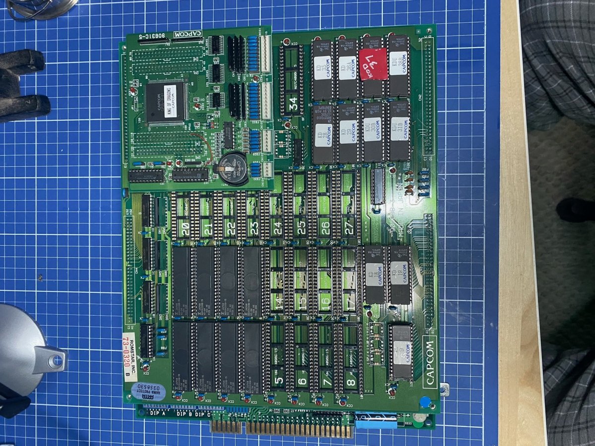

I will attached a photo of the board but if people need other photos or videos of how it behaves just let me know.
