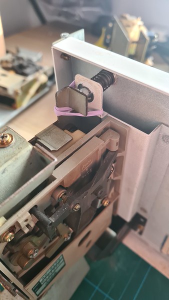

One thing I just thought of though… I’m using universal coin ramps for my 3 candies (as pictured). They will accept *any* coin or token, and it doesn’t have the coin jam mech, so the reject button won’t stay in place. Does this make it incompatible with this system?
Thank you!
Can the lever behind the button freely rotate/pivot or does the universal coin ramp stop the movement?
If it can move freely then you should be able to use this kit. You would just need a means to return the lever back after pressing the button. You could either add a spring etc or go all McGuyer on it's ass and use a rubber band :D
If it can't freely rotate/pivot then you might be able to mod your ramp or I could maybe look at making a version of the ramp that has clearance.

Thanks for the videos. Yes, they'll work fine in that case. You'll just need a spring/rubber band or something to pull the lever back to the 'unpressed' position.

Yes, the kits for these should (I've jinxed it now) work no matter what type of mech you have as they mount to and are triggered by the coin mech frame, not the actual mech itself. They'll also work if you have no mech, you'll just need a spring or rubber band as mentioned a few posts up. I can include a rubber band for an extra £20 (or source your own) :D

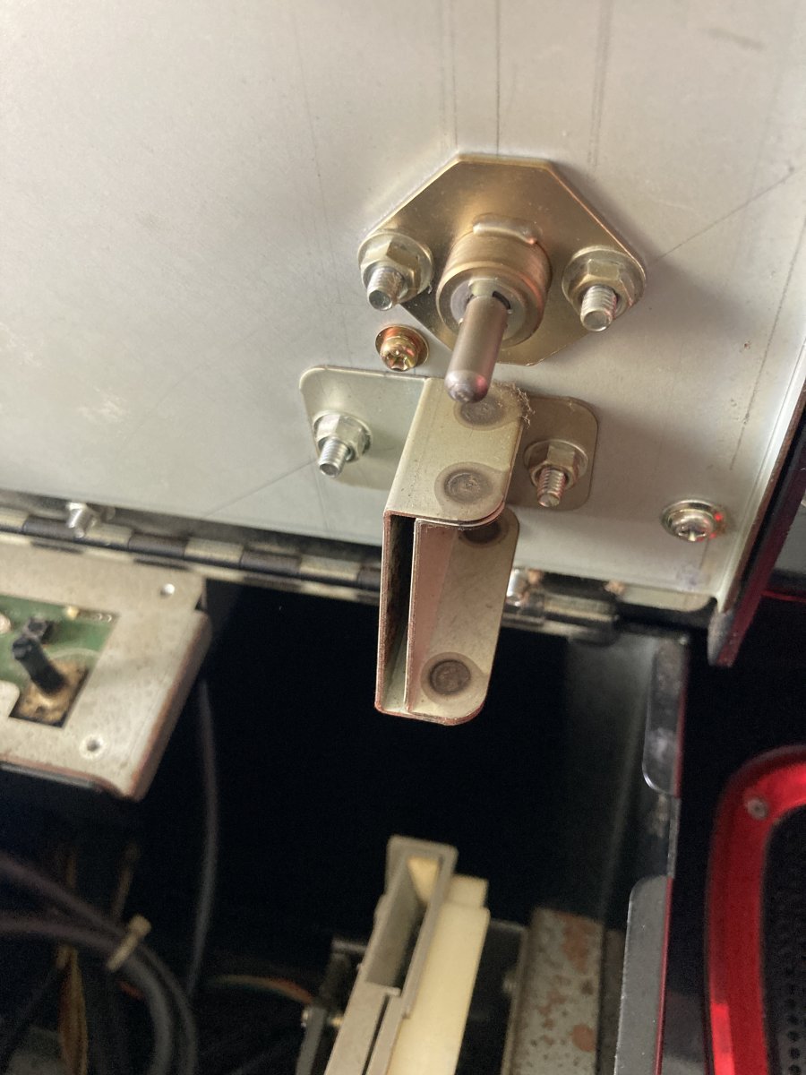

@djsheep - Thanks for the picture. On all of the other kits/mounts I'm using the 90 degree levelrto actuate the microswitch. As the reject button is aligned with the plastic lever on the mech I can't use the same solution. I might have an idea though. Can you take any more pictures inside that area from different angles? I realise it probably a bit tight in there but let me know if you can.

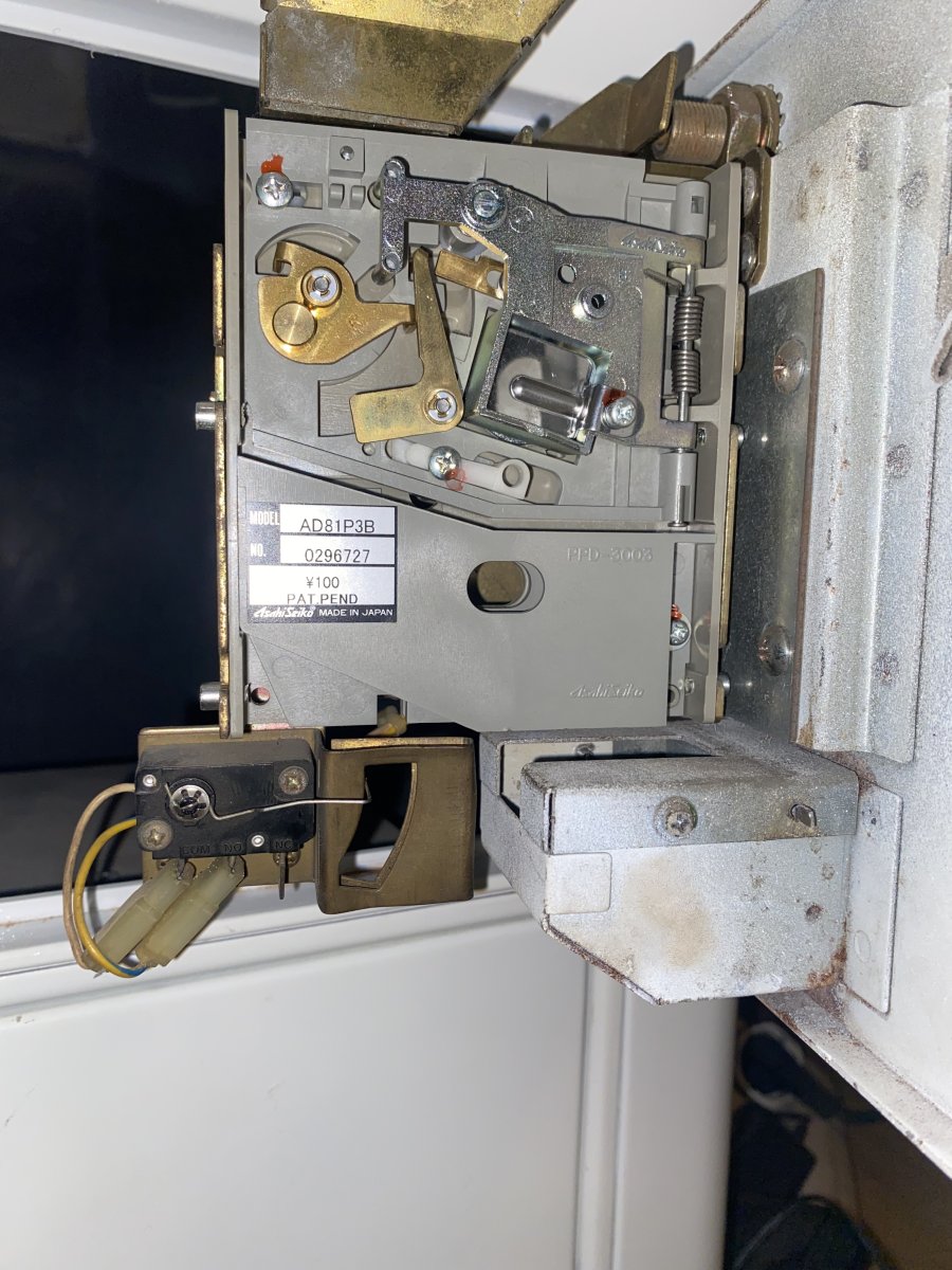

@FrancoB … what im wondering if the kit can be used on Aero too . Is possible for this cab too?
Thanks for the confirmation.

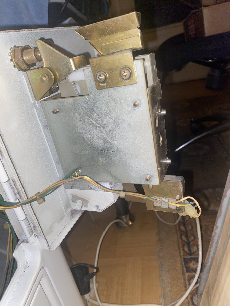

Is that a picture from your Aero, it certainly looks the same as the N/AC/Blast version. Is there a number printed on the other side of the mech - CY1009 by any chance?
No , is from NAC cab , but i also checked Astro 2 cabinet few days ago and is the same as NAC. I have a friend with Aero & Neo Geo cabs (u4 and super neo 29 or something like that style) and i will be happy if this kit fits in that coin mechs too . Friday we can have answers from him about this , but if other owners of these models can confirm, will be great until then too ✌🏻
@FrancoB Confirm for “CY1009”
