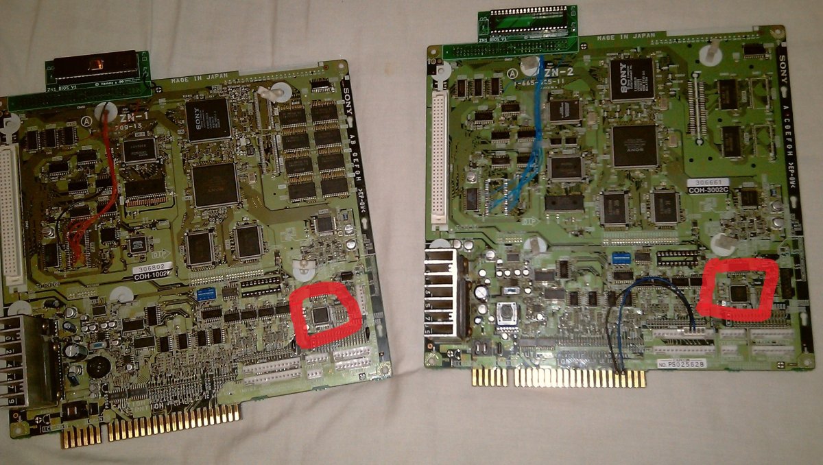

ok i found Sony CXD8661R is custom overclock chip request by capcom :thumbup:
I have a spare ZN 1 motherboard, I don't know if it's the same reference, I'll look ?(
the cps2-b is about the kick buttons only so not this fault.
it may be the mcu - this one , i think its the same for zn1 and zn2 but never tested mixing them...
also maybe the regular input buffers faulty

I looked at a ZN1 motherboard that I had as a spare, it's the same MCU, but no luck, it was corroded and a leg was missing X/.
Is there an equivalent today or is it a custom chip for Sony ??(
