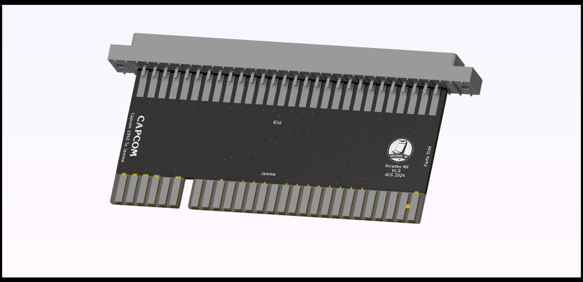

I got a 1942 board recently from a local ex arcade operator, the board looked in good shape but then I realized this board is not JAMMA even when its a 28 pin EDGE connector, after some digging in the internet I just could find some adapter for sale so I would like to share this open source project, so everyone can make his own adapter and share with the rest of the community, this is a JAMMA adapter for 1942 and Vulgus boards.
here its the 1942 pinout where I based my design
https://www.mikesarcade.com/cgi-bin/spies.cgi?action=url&type=pinout&page=1942.txt
here its the github link where you can download the GERBER files and the schematics, you can also find the files attached to this post
https://github.com/AcrZg/Capcom-1942-Vulgus-2-Jamma.git
Thanks everyone for this great community and thanks as well to the Arcade community in ArcadesMX
