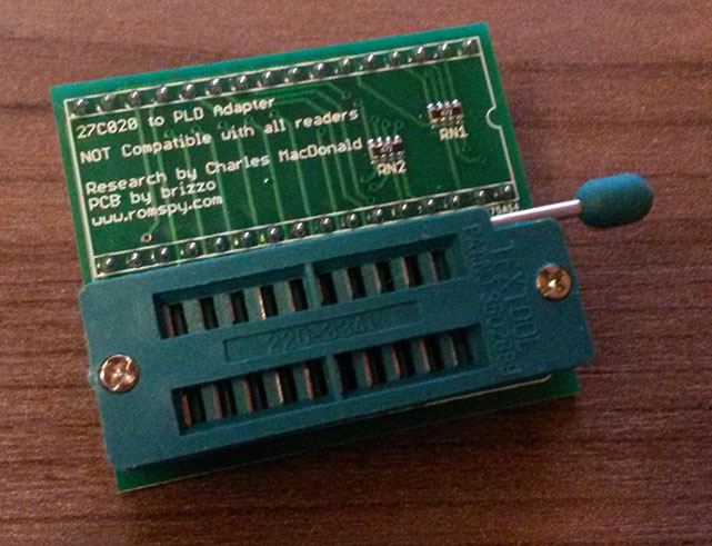

@invzim touched on the subject of how to 'dump' programmable logic. Here is a photo of an adapter that I built that is used in combination with software written by Charles MacDonald to solve logic from non-registered PAL/GAL devices. It is used with an EPROM programmer and read as 27C020 device in order to produce an output file that is technically all combinations of inputs and outputs toggled. It is not compatible with registered PAL/GAL devices, which for example use a clock source to drive the truth table (think state changes based on a counter value).

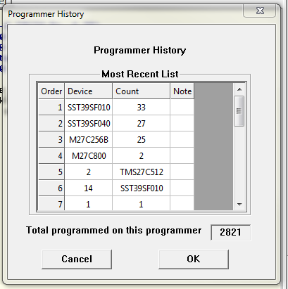

twistedsymphony said:
I've got a Top3000 and a GQ-4X that I use for burning ROMs I'm hoping I can do at least GAL22V10 and GAL16V8 on them.
GQ4X does not support GAL/PAL.
My unit works exactly how it should, never had a problem. Literally programmed thousands of chips, and this is one of many programmers in the fleet.

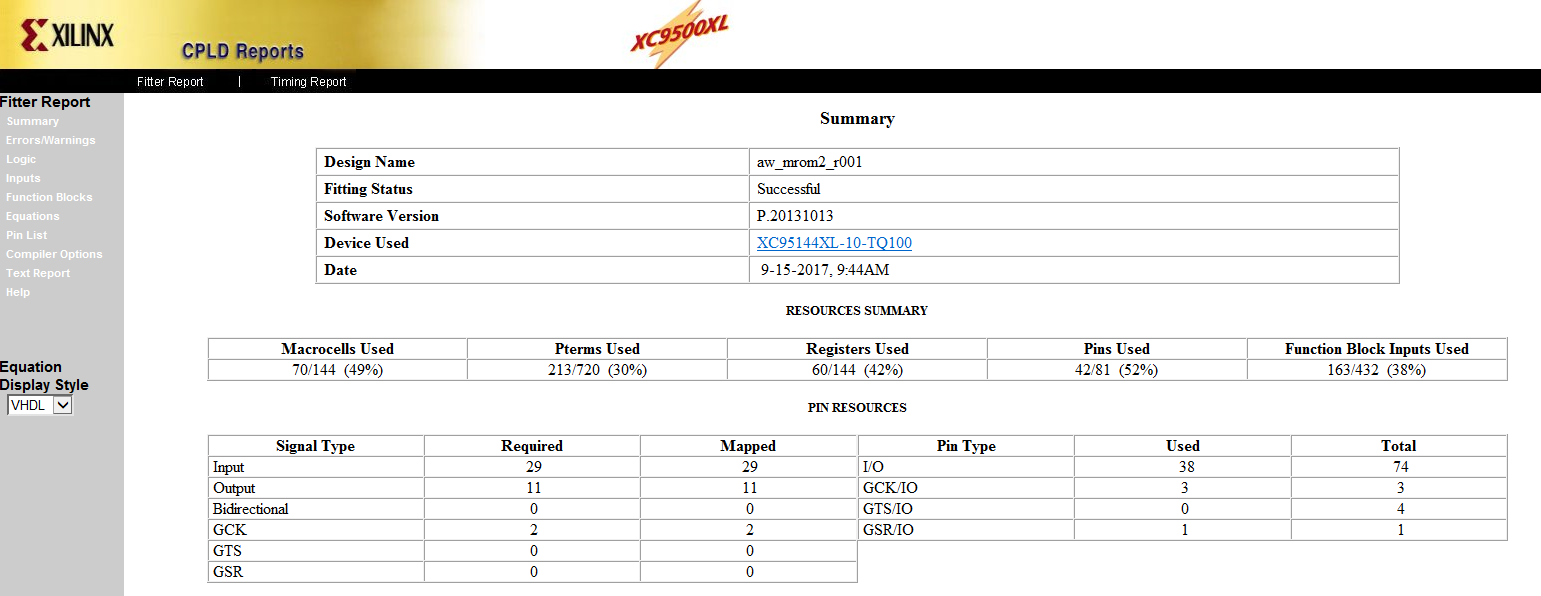

Are there limits to the length/complexity of the logic you can use? Also how do the fuses fall into this and how do you avoid blowing them when brute forcing the logic?
Yes, there are logic limits to devices. For example the PAL/GAL part numbers indicate pin count and macrocells (available logic).
Different devices use different units to describe and measure available logic, but an easy summary would be this:
PAL = 50 logic gates (a few 74-series parts)
CPLD = 50-500 logic gates (20-30 74-series parts)
FPGA = 500-millions logic gates (able to replace complex logic devices like CPUs)
Here is an example fitment report for a Xilinx CPLD from a project:
I bought one a few years ago when I wanted to burn some new BIOSes for my 6 or so NAOMIs I bought the GQ-4X with the adapter for those chips and 10 or so brand new chips.
It programed the first 3 flawlessly, I packed it away in a box for about a week and then it refused to program reliably anymore. it would verify that the chip was erased, write about 1%-2% and then claim that the chip was write protected, I tried re-erasing the chips, even bought an industrial chip eraser, tried a different external PSU, tried some alternate settings that people recommended to no avail.
Basically it seemed that brand new chips would burn if they were fresh out of the package, but anything that had been erased, or even minimally exposed to UV (like sitting out in the open for a few days) would fail. It read chips fine and it burned non-uv erasable chips fine too. Once I picked up the Top3000 it was able to burn all of the chips that the GQ-4X failed to do.
It's kind of moot now that I have the Top3000, I'll see how that does with GALs and if it gives me any grief I'll pick up a TL866 ;)
