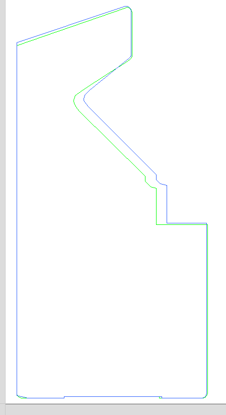

TMNT and Simpsons are different cabinets; TMNT is slimmer in the middle, and has a Mono Speaker grill below the marquee.
Aside from an original Simpsons, you can also look for the Konami cabinets with the double speaker grill. Basically the later Konami games that had stereo sound: Simpsons, X-men, TMNT:Turtles in Time, Sunset Riders... all of these are the same for cabinet measurements.
I pull this from a thread on KLOV:
I took the plans and overlapped the side panels below. The green is TMNT and the dark blue is Simpsons. The control panel boxes are also different heights.

The issue with the side art is that the variation is enough so that Maggie will loose part of her head if she is put onto a TMNT cabinet because the TMNT cabinet in narrower across the middle.

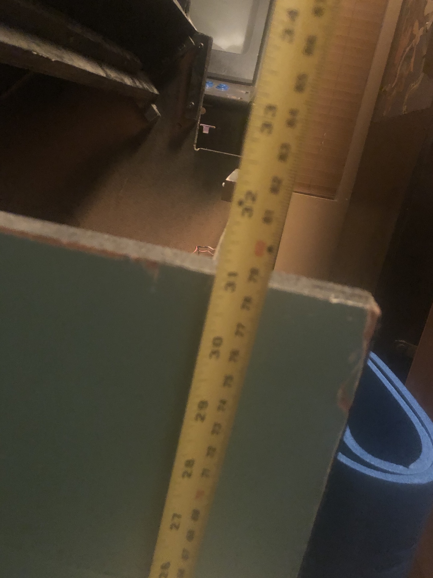

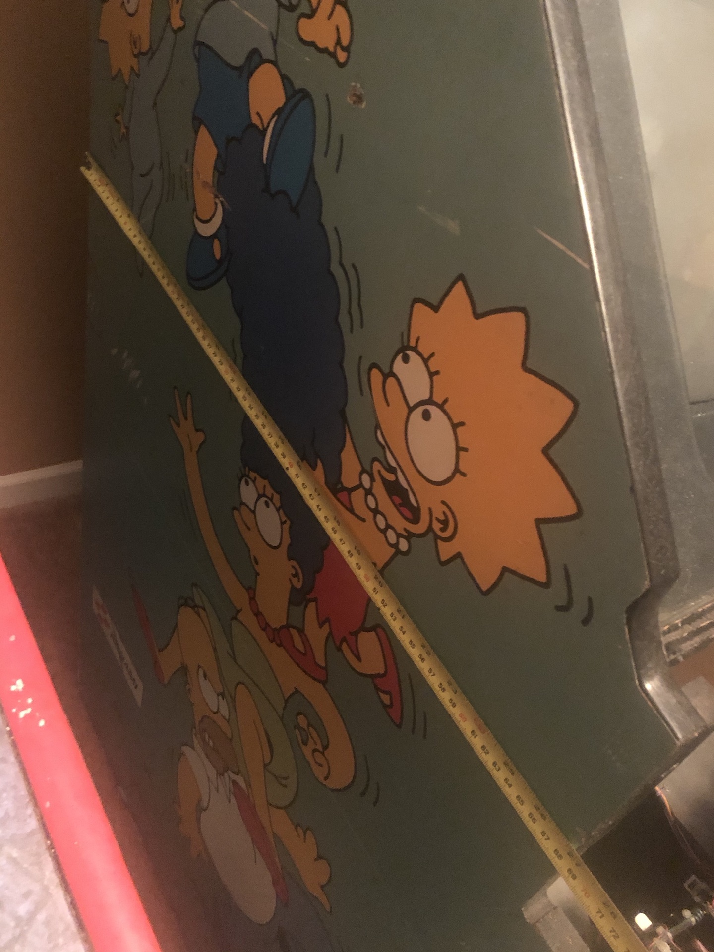

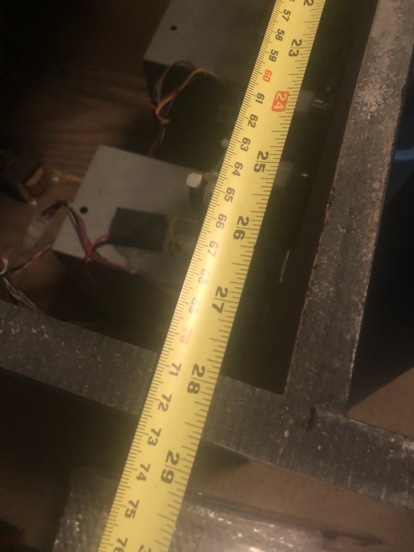

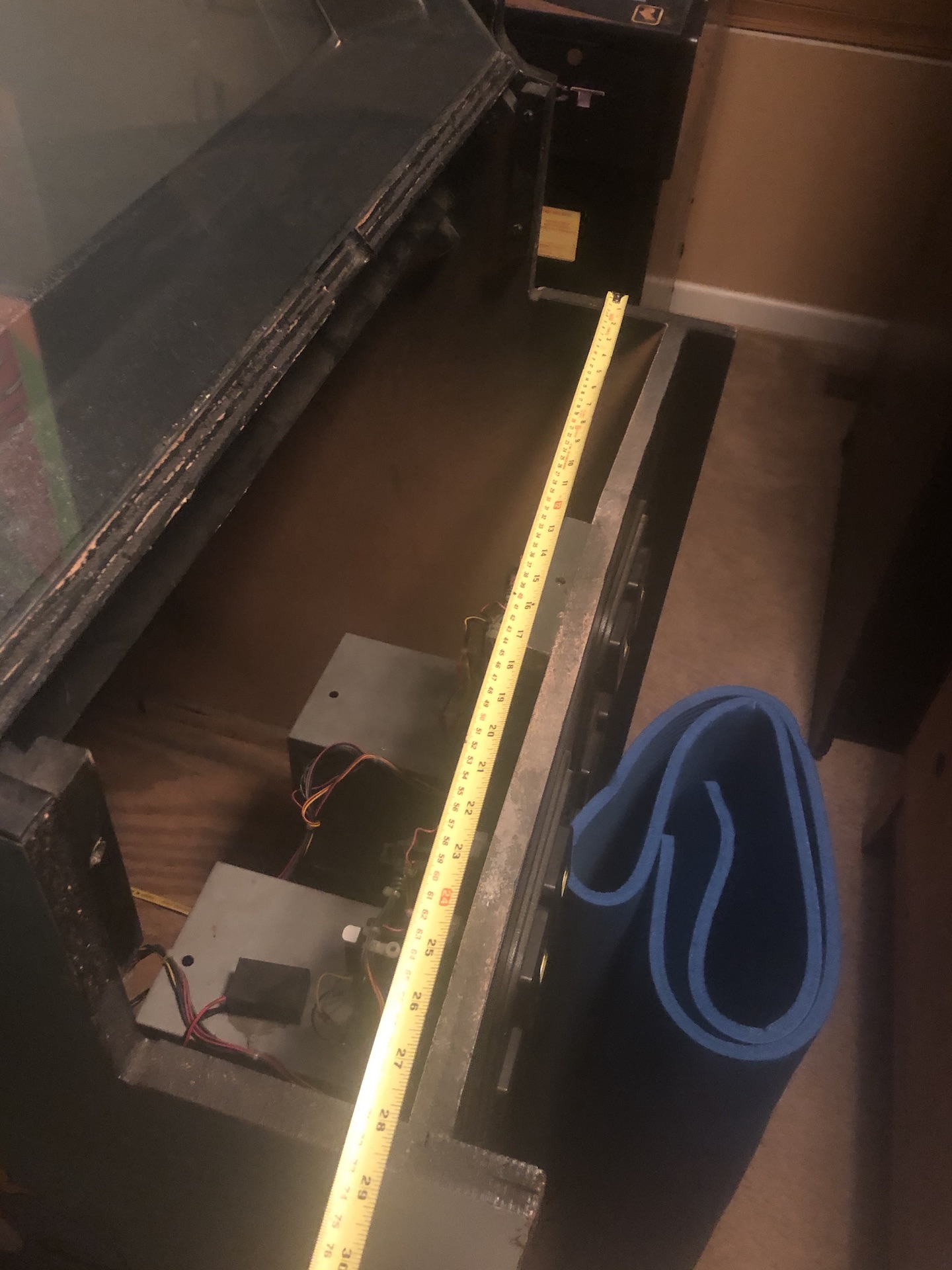

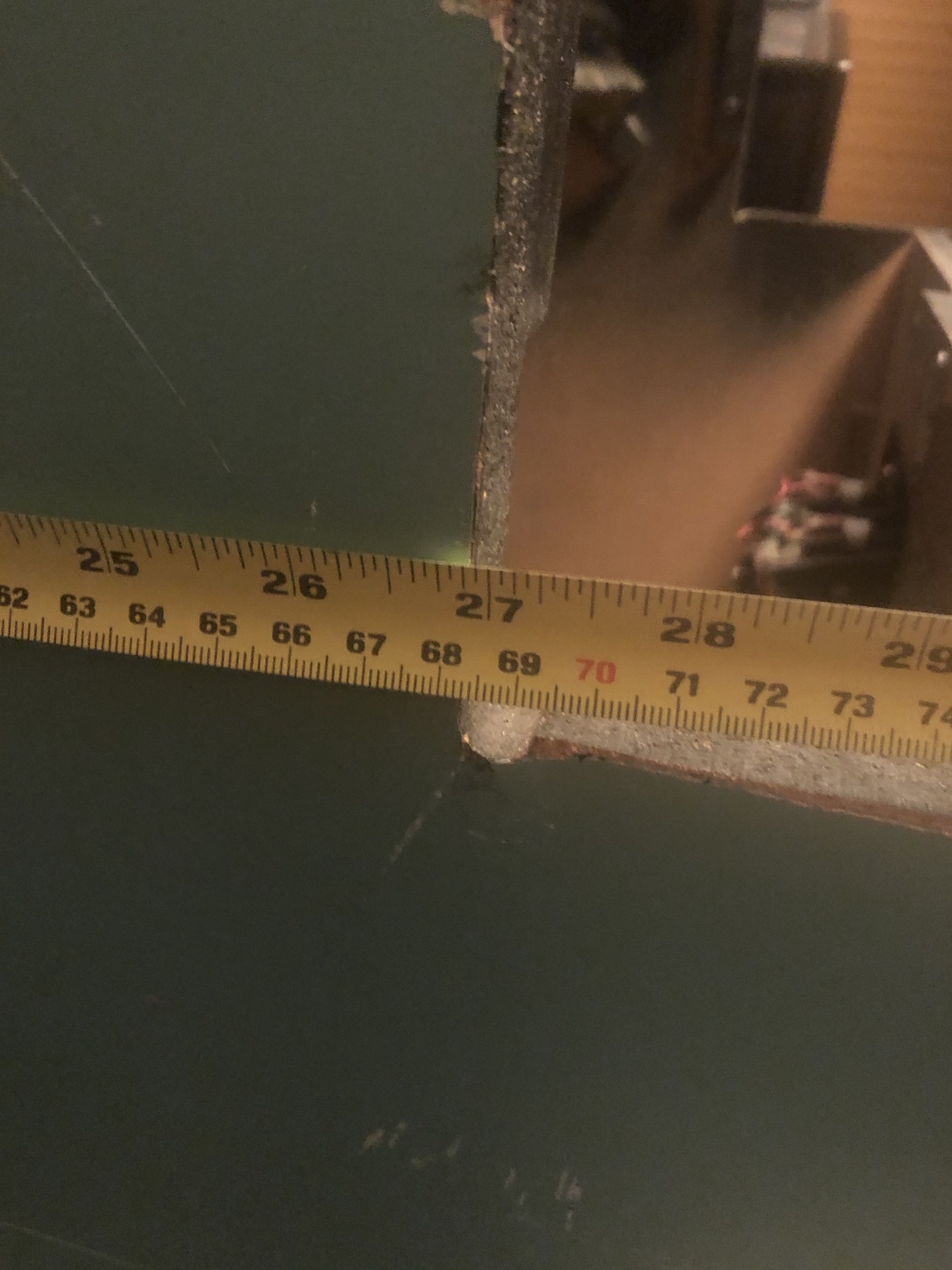

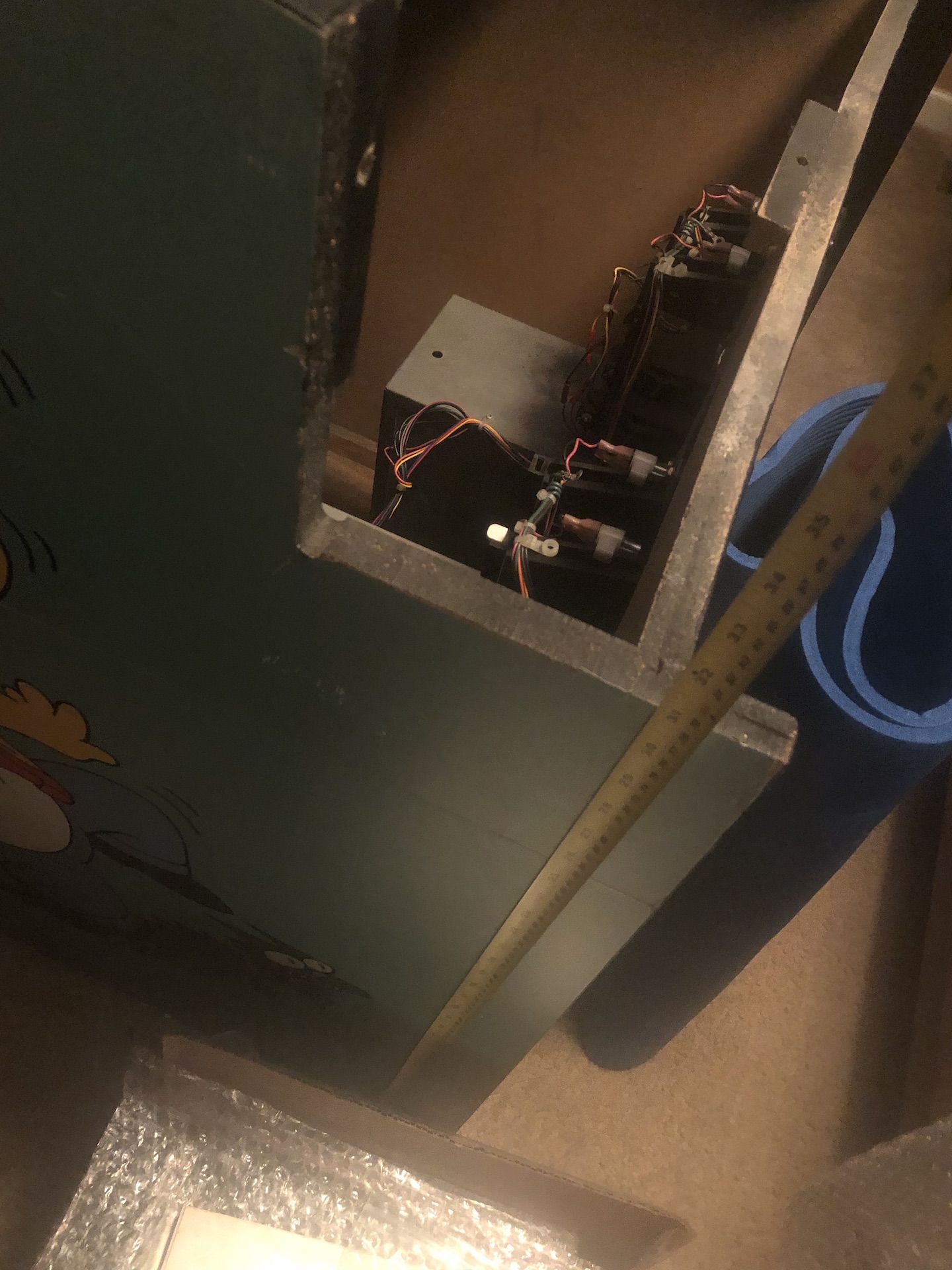

I have an original Simpson's cabinet. Tell me what you need and I'll measure for you. The problem is, I only the a standard hardware tape measure, so it will only be as accurate as that.
Do you need the whole thing or just certain areas?
I'm glad to help!
I'm glad to help!

HelloThank you my friend. The problem is i need measurements as Metric version. Do you think can you find MM meaure ?
Like, metric as in millimeters? I think you can just use Google to convert, no?
Can you use the numbers on the tape measure as is?
