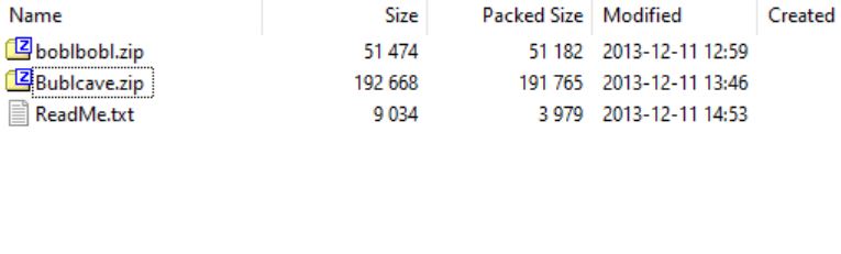

The zipfile doesn't contain a bootlegLostCave.zip...

Basically Lost Caves uses the original assets from BB as well as some additional.
The files you have above, one zip file is all the required files for an original board and the second zip file is additional files required for a bootleg board. Ignore the file names, burn and install everything.
The reason the bootleg needs additional ROMs is because it's a bootleg some of the assets and code are modified, incorrect or missing. You need to restore these to make it function like an original (you can also use Redux like Elgen did)
