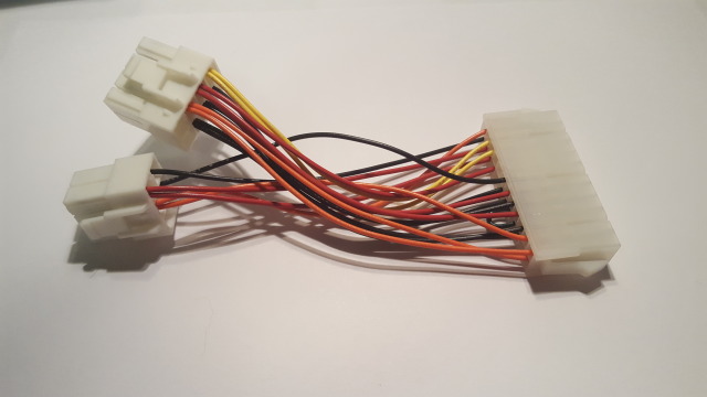

This high-quality, hand-crimped adapter will allow you to power your entire Naomi setup including the main pcb, DIMM or NetDIMM, and GD-rom or CF Kit (with separate cable) using a standard PC ATX power supply. This adapter is wired by default to power on automatically when you power the ATX supply but there is an option available for leads to allow you to mount an external power button. This adapter runs a wire from EVERY SINGLE 5v, 12v. 3.3v and Ground connection on the 24-pin ATX connector for more robust voltage control to prevent starving the Naomi of the necessary power.
Adapter shown is wired for auto-power when ATX power button is flipped on

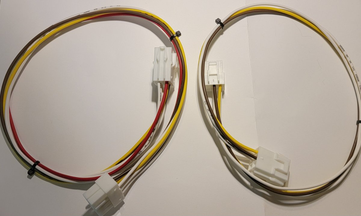

2 FOOT EXTENSION CABLE SET
PRICE IS $20
Extend your ATX-2-Naomi adapter or even your original SUN PSU an additional 2 feet.

All very true. The preferred method is to use an adjustable supply. I've made these adapters before with mixed success. So many people ask about these that I decided to try a new version as an homage to the model 2 and 3 power wiring. Many of you may have noticed that Jasens Customs have been pushing his version on twitter hard lately. His version, though cheaper, is very similar to my old version. It uses the 20-pin ATX (as did my old version) connector and only uses the number of wires to match 1 to 1 how many are used by the two connectors on the Naomi. As I said earlier when I built mine this way I had mixed results and often would have resetting randomly and the dreaded Error 01 (not enough juice).
So instead I've switched to a 24-pin ATX connector. Most modern PC supplies have the 20-pin plus 4-pin that you put together to plug in at least. What this provides is an etra 3.3V, 12v, 5v, and Ground wire to use for more reliable amperage. My adapter now uses EVERY available 3.3v, 5v, 12v, and ground pin available on the main connector. So my adapter uses:
2 yellow wires for 12v
4 orange wires for 3.3v (important!!)
5 red wires for 5v
7 black wires for ground
I also connect the green wire to a ground pin for auto-power. If you want a power toggle switch connector then there would be a free hanging green and black wire.

He is using a thicker wire than I am now. My old design used the same gauge he is now. I found going up in gauge a bit and adding more points makes it more reliable. It was necessary to go down in the wire thickness (higher gauge = thinner wire. I know, confusing) so you can crimp multiple wires into one pin on the Naomi connector side.
The same adapter above ran my Naomi for 10-hours last night with no hiccups at all using the same old ATX supply that wouldn't boot the Naomi reliably with my old adapter. I feel really good about it.
