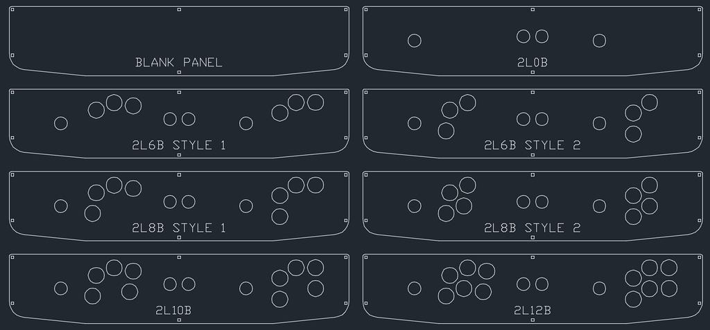

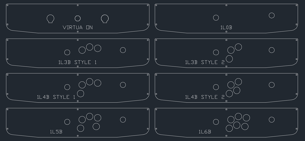

SEGA CONTROL PANELS
I brought my 1L6B and 2L12B panels into work and took all the dimensions for them and I made CAD drawings of all of the layouts possible from each one.
I've got the following panels uploaded in .DWG and .DXF:
You can download AutoCAD 2000 versions [here] or AutoCAD 2015 versions [here]
I can also export them to .EPS if required, just let me know.
Please note that some hole positions may vary from one manufacturer to another. If you're designing an overlay to fit an existing panel it might be worth doing a test print prior to getting your CPO printed to make sure everything aligns as it should.
I do know a few panels have been cut from these plans and I've been told and they fit Sega cabs nicely.

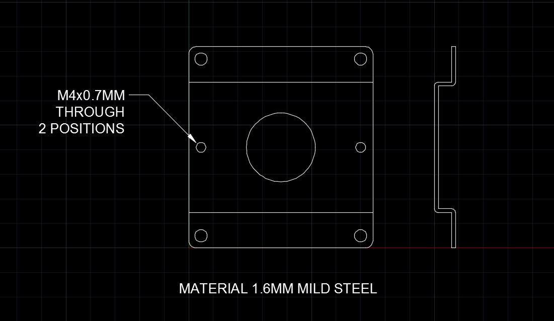

Vewlix_Mounting_Plate_E3018350A.dxf
E3018350A joystick brackets for use with E3102171A panels.

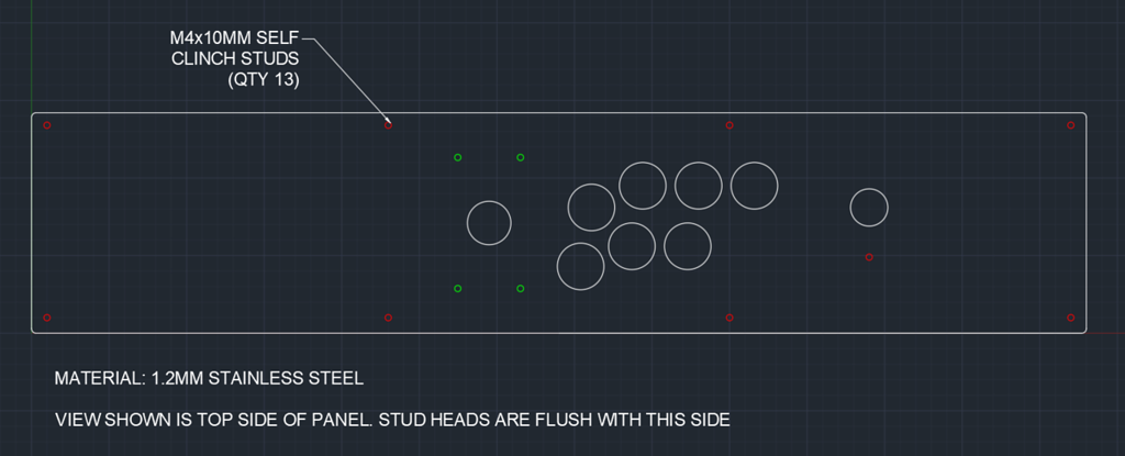

Vewlix_1L7B_V2_Fixed.dxf
I've taken as much care as possible to ensure all dimensions are correct and I've printed multiple scaled .dxfs off to confirm accuracy. I'm as confident as I can be without actually getting a panel cut and offering up overlays etc. I would appreciate feedback from anyone who gets one cut so I can update the model if required.

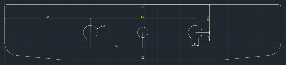

do you know the actual dimensions on that Virtual On panel?
I've heard that the layout floating around online is not accurate to the legit panel; though I'm also not sure if the VO OMG and the VO OT panels use the same dimensions.
I have a VO OT panel that I can confirm against
defor helped me with the Virtua On panel. He took some overhead photos of his panel for me and I imported them into AutoCAD, scaled them and took the measurements from there. This isn't the most accurate method due to camera angles etc but it's the best I could do without the panel to hand.
I've noted the dimensions on the picture below. Please do check them against yours.
I'm not sure exactly which Virtua On panel defor has, I'll see if I can find out in case there are differences between the VO panels.

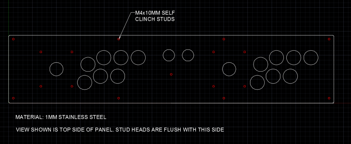

VEWLIX CONTROL PANELS
Modelled from a E3102171A 2L14B panel kindly donated by Derick2k
Vewlix_2l14B.dxf
Standard 2L14B panel for use with E3018350A joystick brackets.

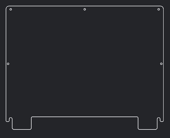

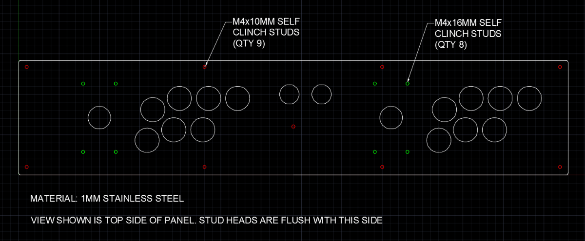

Vewlix_2L14B_V2.dxf
Identical to the E3102171A but with a stud arrangement to a range of joysticks:
Seimitsu SE - Fits: LS-32/LS-32-01, LS-34/LS-34-01, LS-40/LS-40-01.
Seimitsu SE-P40 - Fits: LS-55/LS-55-01, LS-56/LS-56-01, LS-58/LS-58-01 and LS-60
Sanwa JLF-P-1 for the JLF
Mounting studs for the joysticks have increased to take into account the ~7mm spacers you'll need to use to achieve the correct joystick height.

* After feedback with the Vewlix panels files I have reduced the overall width by 3mm to fit the CP recess better. If you have the older files please delete them and replace with the _Fixed suffixed files.

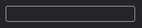

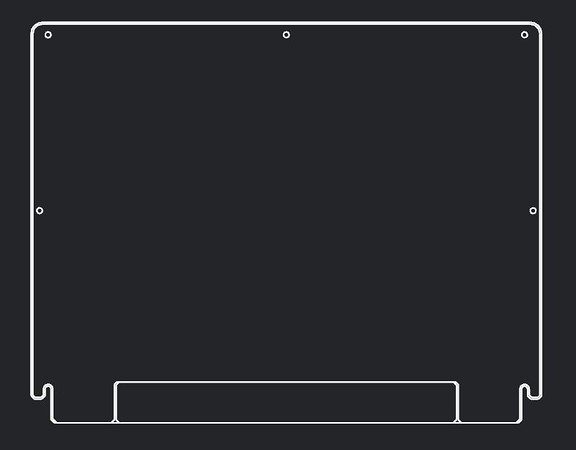

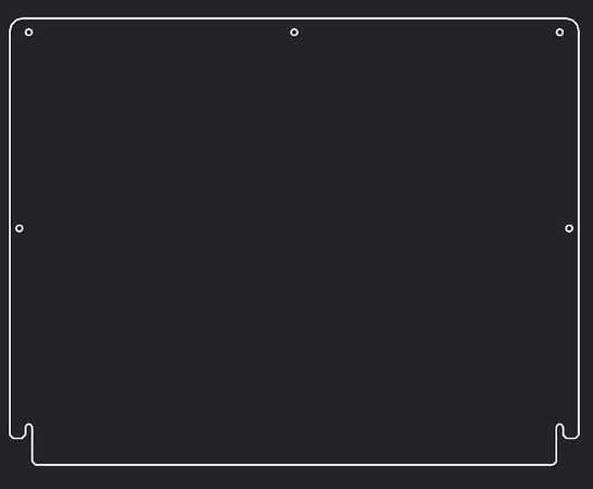

Added - Vewlix marquee holder
Vewlix_Marquee_Holder_Main_5mm:
Vewlix_Marquee_Holder_Sheet_0.5mm
Vewlix_Marquee_Holder_Support_1mm
Vewlix_Marquee_Holder_All

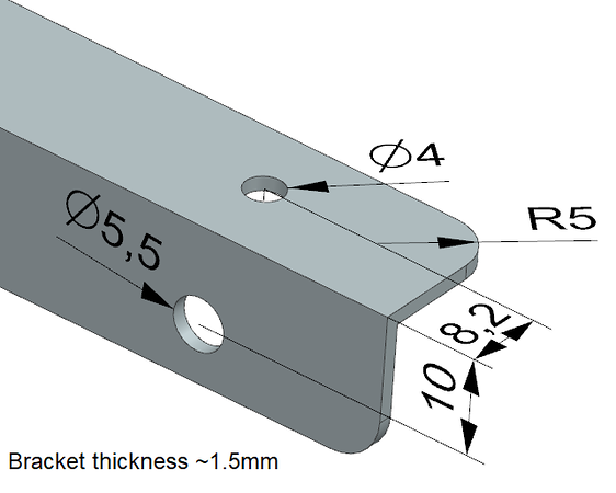

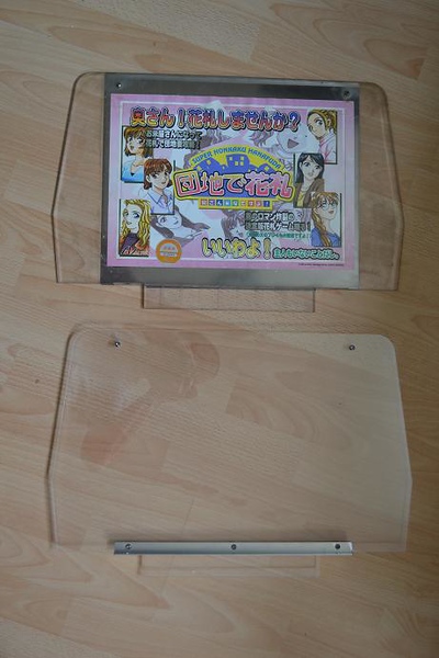

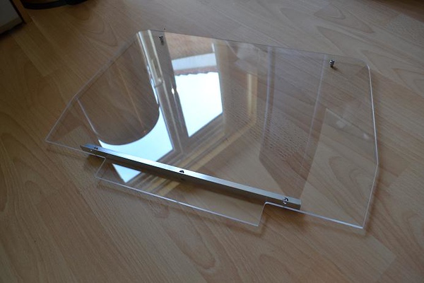

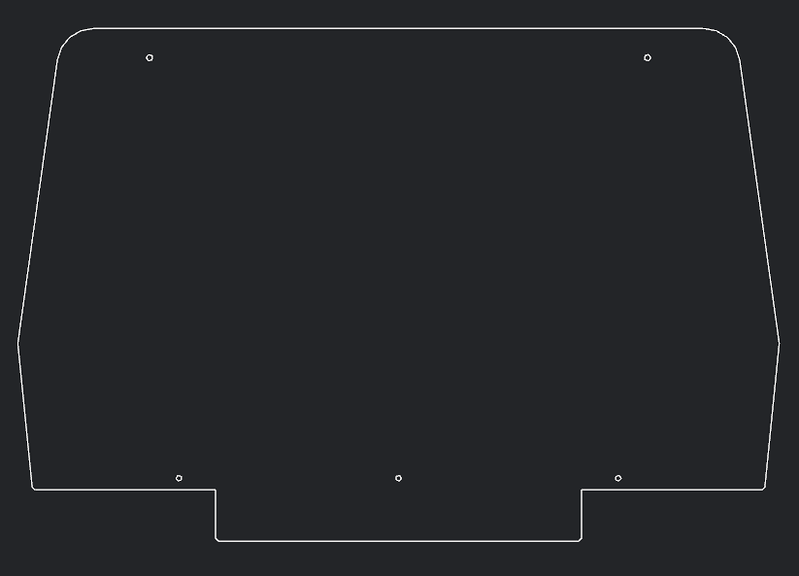

By request I've modelled up my version of the Irem Madonna marquee holder.

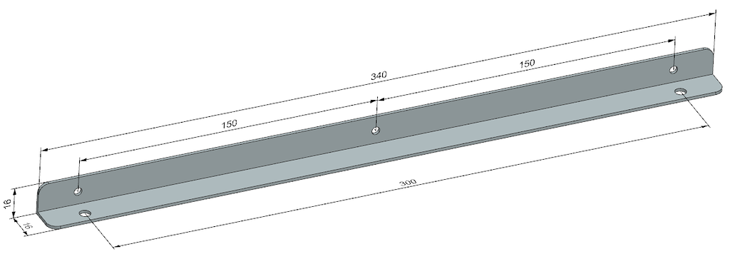

The one at the top is the original, the other photos are of my repro. The original Is a single piece of thick acrylic with a bent steel back piece that bolts to the top cab and keeps the whole marquee holder in place. I couldn't repro that part to I made mine from two 2mm sheets and then made a bracket from aluminum section that bolts to both the marquee holder and the top of the cab.
Marquee DXF:
Bracket dimensions:
Thank you for sharing! My Vewlix is in need of a Marquee holder.

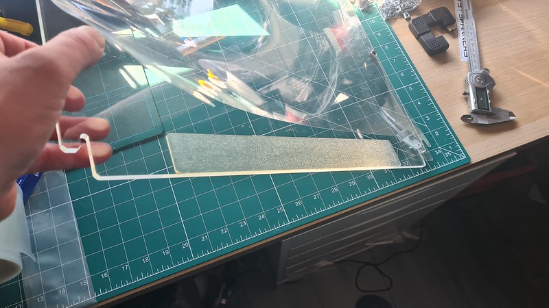

What is the purpose of the "Vewlix_Marquee_Holder_Support_1mm"? I'm looking at my cab but since I've never seen a marquee holder before, I'm not sure how it is mounted and I can't tell from the manual either.
No problem :thumbup:
The 'Vewlix_Marquee_Holder_Support_1mm' is a 1mm thick piece of what looks to be acrylic that is bonded at the bottom of the main marquee holder:
I assume its there to act as a ledge so that the artwork can rest on it and not drop down.
