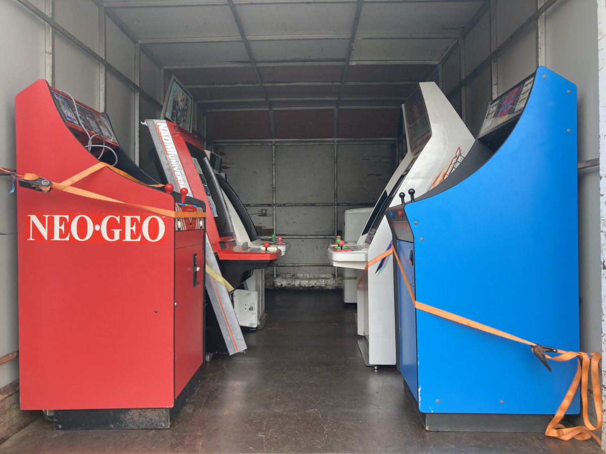

I've been largely AFK/away from the forums for a few weeks, going through a massive unexpected house move. I've had years of experience packing and moving vinyl records so while it's a chore, it ain't no thing but a back breaker. Moving consoles and other belongings are easy enough using basic logic.
However, where I REALLY got caught out is with these:
We figured it out in the end (thanks @xb74 for organising the help), but it was a struggle for us all as we haven't done this kinda thing before.
Originally we were planning to lift them onto the tray of a ute, but at the last minute I rented a truck with a hydraulic lifting tray, which was a wise decision in hindsight.
The major issue is that I had to come down a small flight of 4 stairs, and that proved troublesome given the shape of the back of the Astro City 2 and Blast City in particular where we couldn't use a trolley and its wheels to lessen the blow coming down the stairs.
The Naomi cab is an absolutely weird shaped piece of work and was the most difficult of them all to move.
Anyhows, I'm asking you all to post any tips of essential equipment to move cabs, or any advice when moving them down stairs, etc.

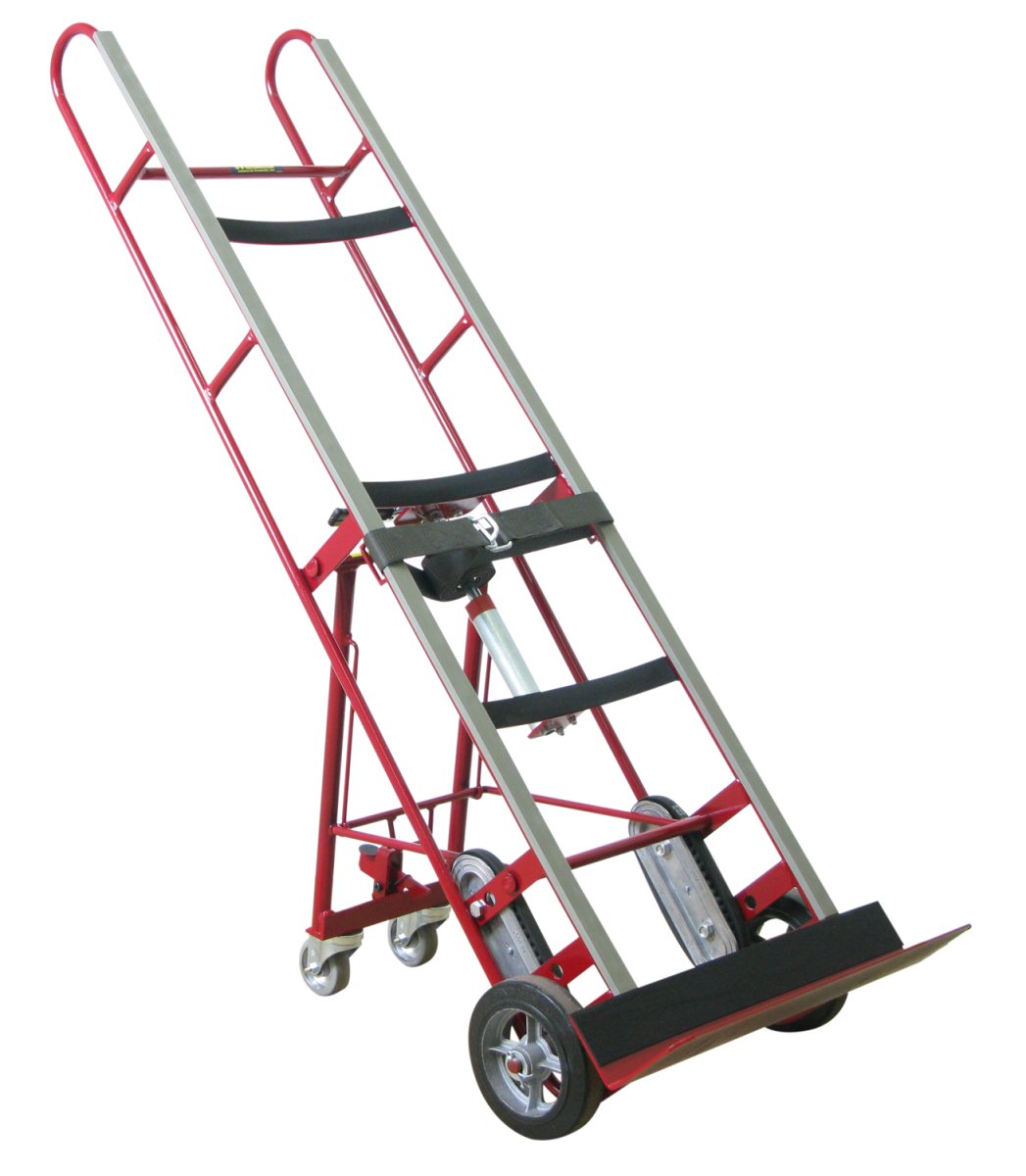

Handtrucks are great. Just remember to strap it in. I learned that the hard way when I wrecked my first ever candy when it slid off the handtruck midway up a flight of stairs.
If you own more than a few cabs it's worth owning a vending machine dolly to move them.
It might look similar to an "appliance" dolly but it's much larger and more rugged. they can usually support 1200lbs and the handles are tall enough that they poke over the top of a full-sized wood cab when it's strapped down. New these things cost about a grand but you can usually find a used one for a few hundred bucks.
These have a ratchet strap to strap down the cab then some support wheels that you can deploy so you can tilt the machine back on flat ground and push it around easily. it's also got rollers to make sliding up and down ledges smoother.
it still sucks moving over stairs and this thing adds 80lbs to the load, but when you consider a cab strapped to this now has two large metal grab handles on the top for two people to easily grab and pull, it makes a huge difference.
Candy cabs are often easiest strapped on their side, and I usually recommend 2-ply carboard on any surface that touches the dolly or strap to help keep damage away.

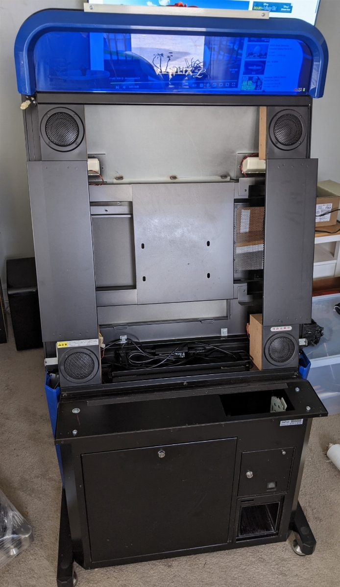

I remove the monitor, control panel and coin box (make it as light as possible).
Shrink wrap the cab (to protect against scratches).
Always use a buddy/at least one other person (can lose control of a cab on a dolly easily) even if its just a girlfriend that can't help physically but warn at the first sign of trouble. ;)
