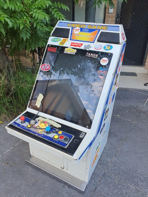

Bill delivered the cab on Friday and spent most of yesterday working on it.
How it arrived
I was umming and ahhing for a little bit about keeping the stickers to add to the character, but I knew deep down, the stickers needed to come off
Given it's condition, I decided I won't do a full repaint and my first initial impression about the cab is as follows:

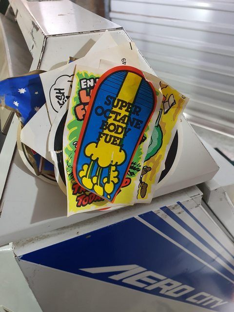

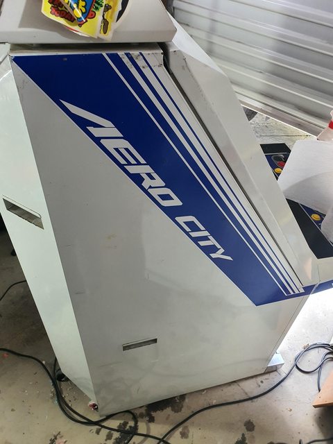

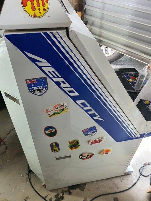

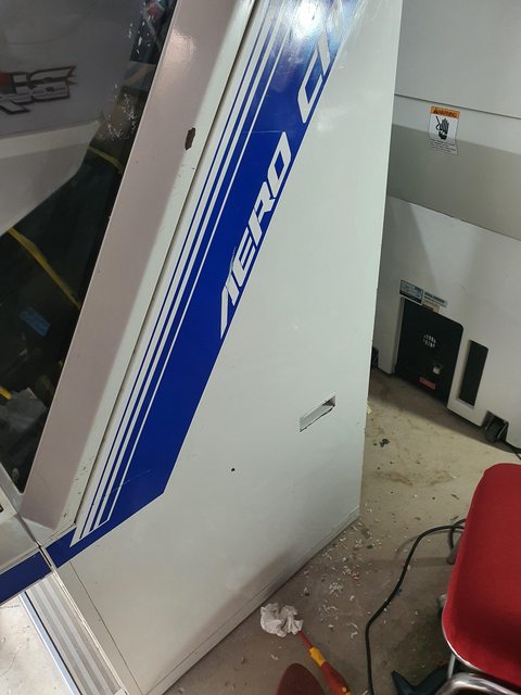

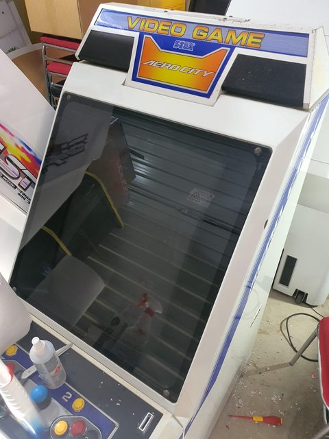

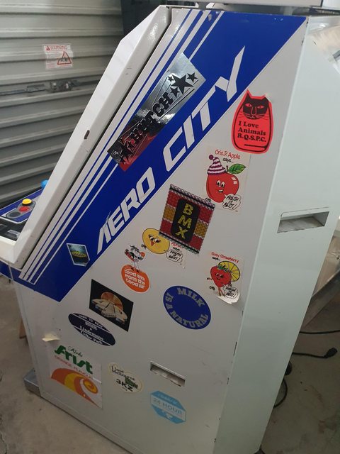

First order of business - the stickers
I spent a couple of hours on this side and the bezel with the heat gun, fingernails and IPA
After spending all that time, I thought I'd give the heat gun "longer" on the stickers and it was like reflowing solder - it gets hot enough, it just bubbles up and she comes off in one piece! I wish I learnt this earlier yesterday morning hahaha I was just scared I'd stuff the paint up
The right side took me a whole 10 mins!! FMD lol

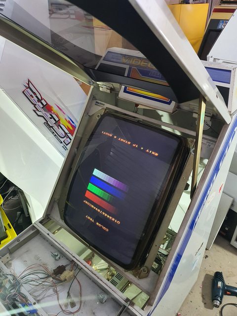

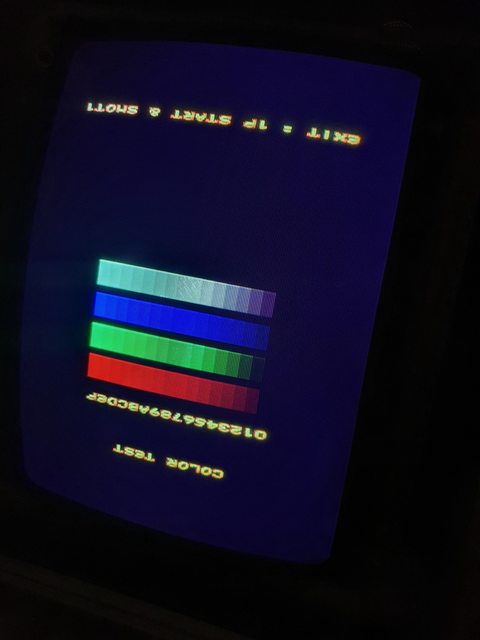

Next order of business was the monitor - the monitor was already in Tate position which is great, but when I loaded the game it was upside down
Rather than just changing the yoke wires around, I wanted to take it out - the anode cap is on the left side on all my other Tate cabs, so this one also needed to be on the left side
After switching the monitor around, I calibrated it to the best I could and I think the red and blue guns are a lot weaker than the green gun - when I had them all lined up exactly the same, the image was waaaaay too much green
But with the green dialed back, the image is perfect!

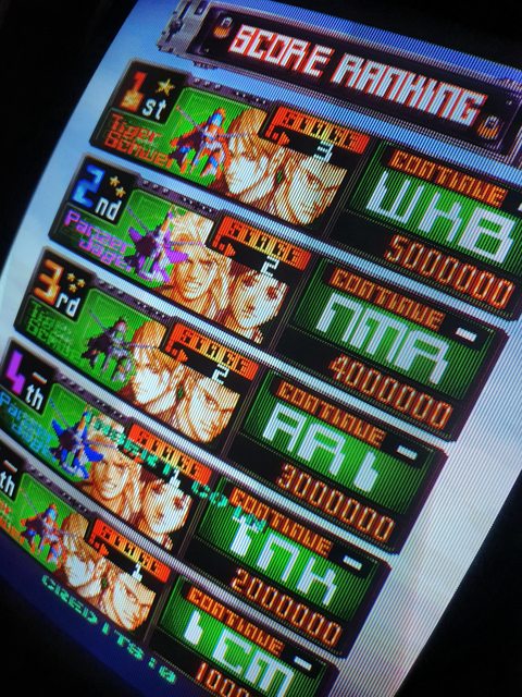

After unboxing the cab and doing the initial inspection, I can say 100% that this cab is nowhere near the condition of the first one. I'm actually amazed at how good the first one was. The condition of this second one is how I expected a cab from 1988 to be really so there's no real big surprises there.
The one thing I was really hoping not to have was a burnt screen, but again, this is a 1988 cab that's been in circulation, so enter Rygar burn in
[IMG]
[IMG]

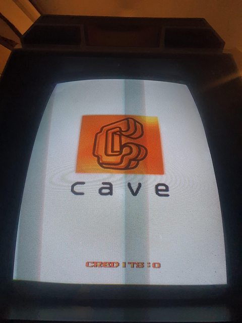

Once the wiring was confirmed, I was confident to plug her in and voila! Missing the red channel
[IMG]
[IMG]
In my experience with a colour going out, it's been due to a cold solder joint on the neck board, as such, I quickly inspected the neck board and couldn't really find any cold solder joints, so I moved to something else.
[IMG]
I noticed when I gave the cab a bump, the red would come in and out, so I secured the RGB signals tighter on the harness and that seemed to have worked. I didn't reflow anything as of yet, but I have all three colours at all times now
[IMG]

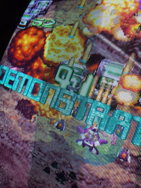

It wouldn't be a CRT cab without in my house without this game being loaded!
[IMG]
