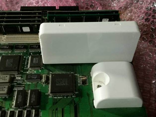

These housings are designed to be used in Conjunction with the Darksoft Reproduction CPS3 Security Cartridges: CPS3 Repro Carts coming (very) soon!!
There are essentially 3 configurations of the files here each with a unique purpose.
  1. The standard front and back housing are designed to be used with reproduction security cartridges or modified "Super Bios" carts that do not have a battery. Since the reproduction cartridges don't have a housing to go with them hopefully this 3D printed housing will serve as a useful alternative to stealing one from an original cartridge.

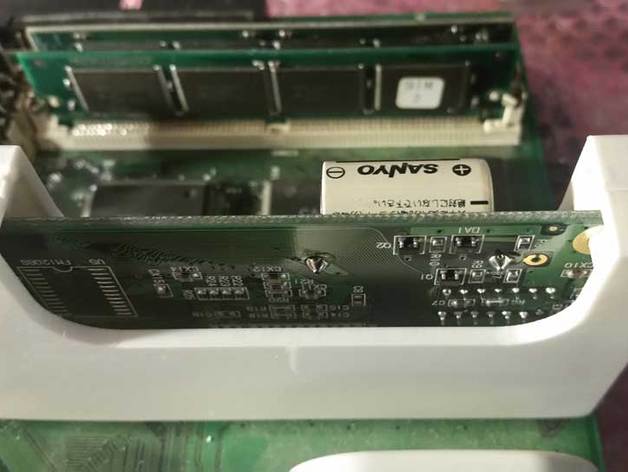

  2. The back housing with a "Battery window" includes a cut out designed to accommodate the large battery that sticks out the back of an original, un-modifed security cart. the window is elongated to the left to accommodate a larger replacement battery that may use the larger foot-print solder points. this also allows you to easily see the production month/year of the battery for easily determining when a replacement might be needed.
  3. The "battery replacement jig" variants of these parts are to help facilitate a live (powered) battery swap, by providing stabilization to the cartridge PCB and reduce the risk of power loss during a battery replacement which could kill the cartridge.*
*NOTE: please test the stability your printed jig provides before attempting a battery swap, not all 3D printers will provide results consistent with my own. As such I assume no responsibility if a jig printed using these files does not hold the cartridge tight enough to prevent power loss during battery replacement. Use this at your own discretion.

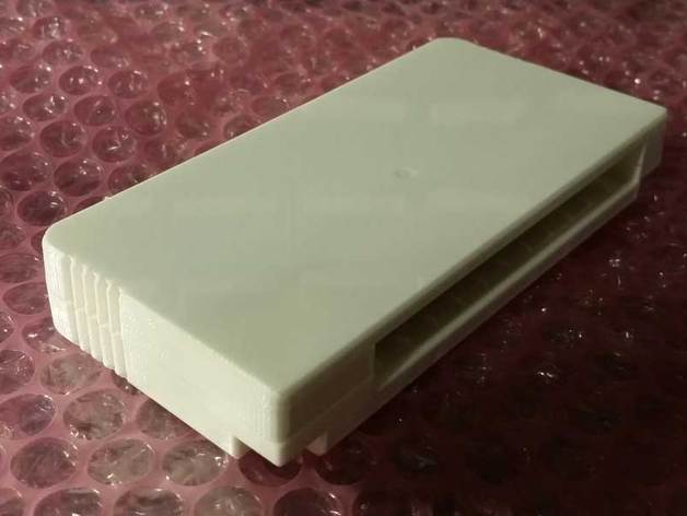

The print worked pretty good. Here are some pics
The only issue I would foresee is in the last picture. Where the two clips on top of the cart snap in. The strip across is very thin. Not really a problem if you just keep the cart pcb in the case full time. It definitely does the trick and is an awesome replica. Way beyond what I expected.
Thanks for the pics!
I'll say it's not my best work, there are definitely areas where it could be improved, but i fiddled with this thing for so long that I had to draw a line in the sand and say "this is good enough to do what it needs to do" and call it there.
The clips do make or break how well everything fits together. and the quality of the clips really has to do with the supports and how well your printer handles overhangs.
