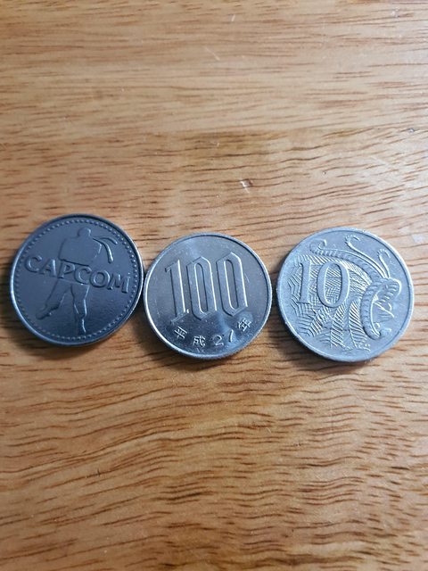

I went crazy with tokens last year, sega, capcom, namco, taito and have adjusted all my coin mechs to accept the random coins.
I've got a few that are electronic so those are easier to configure, but then I bought a number of cheap ¥100 coins mechs and adjusted it to use game tokes that are roughly as big as the ¥100
These were my three tests
Steps to make the normal coin mech work with the game tokens
Video of it all working https://i.imgur.com/koMexv4l.mp4
Hope that helps those that want to use a game token

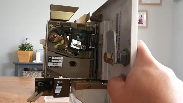

I've run into a problem and I'm not sure what the solution is. Hopefully someone here can help.
I have several AD-81P's in my P-Ras3 cabinets and 1x AD-81P in my Chunithm. I've run through @mR_CaESaR's adjustments above and they're all adjusted exactly the same. This has allowed Chunithm to accept tokens. However, my P-Ras3 cabinets eject everything (and always have, including 100Y coins).
When I swap the coin mech from the working Chuni to a PRas the result is the same (working in Chuni, ejects all coins in P-Ras). The coin doors are closed when I attempt to insert a coin in all cases.
So my question, is there some kind of electronic signal the AD-81P takes with a real board that's not happening with my Windows10 setup that causes it to eject all coins (including 100Y)? I've noticed that I try to insert a coin/token while the coin door is open with Chuni, it ejects. The coin door needs to be closed. So I feel like this circuit may not be active on my P-Ras3s but I could be way off.
Thanks for any assistance/insight on these coin mechs!
-K

That’s pretty odd unless harness is pulling it so tight or something. They are purely mechanical coin mechs.

Can you please check/take a pick of the bracket and the microswitch?
In one of my setups, I have an NNC with a windows pc in and the microswitch is connected to credit so it just passes through mechanically down the coin up micro switch to activate the credit. I imagine the Pras3 is setup in a similar fashion where the coin up is connected to a microswitch which is then connected to a coin up on the IO
